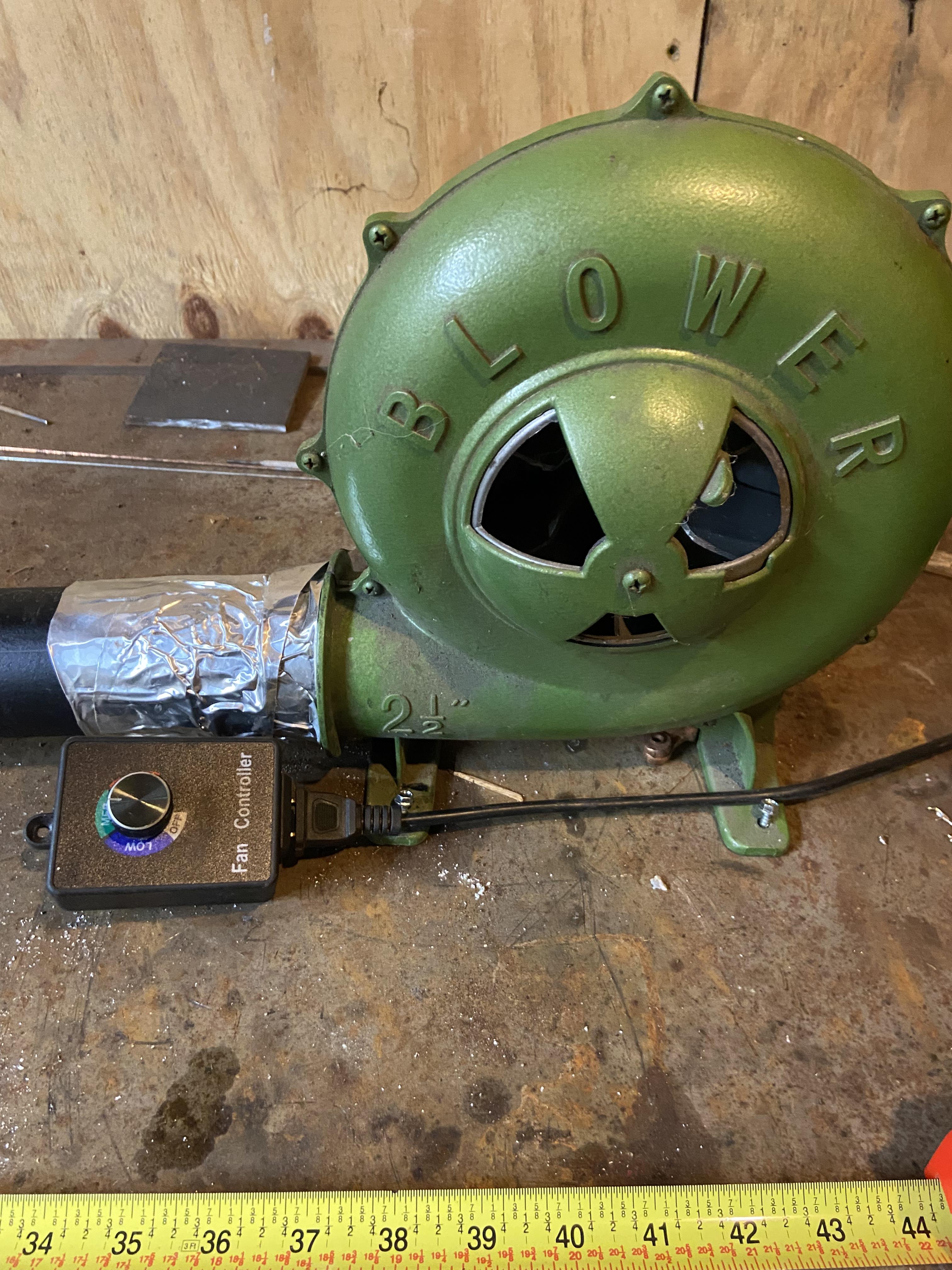

  4. Hi George. I’m in Central New York. Yeah, that blower is horrible, but it’s what I had. It does have a rheostat but it’s cheap xx xxxx. I think it was the cheapest blower I could find. Frosty, the burner came out of a Navien NCB 240 combination boiler. That was the first burn and I was messing with the gas and the blower. At standard household gas pressure they run around 97% efficiency and it’s just a small panel of blue flames. It’s designed to fire down through the heat exchanger. They’re reliable, if they’re serviced annually. https://s6e1619fceb451b6f.jimcontent.com/download/version/1512634722/module/11899834199/name/Navien Gas Boiler NCB-Service-Manual.pdf Also, the metal mesh was cool to the touch 30 seconds after shut down.
  5. Hello all! I’m a plumber by day, and as such I install and replace a lot of in demand boilers. I took the fiber metal burner plate out of a 200k btu combination boiler and made this. This was the first iteration and test. Not sure how it will hold up in a forge or furnace, but hey, fire! IMG_2466.MOV
