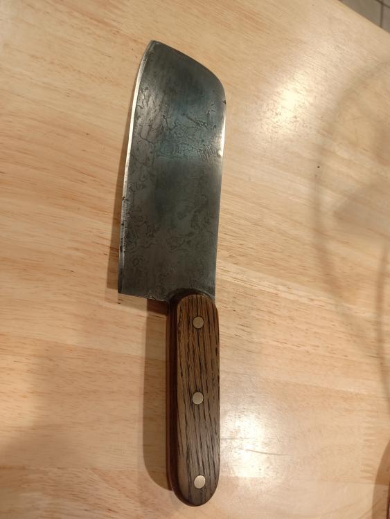

First time poster. I bought a forge at an estate sale, been using it for a few years.  I think it was mainly used for farrier work. Anyone recognize this unit?
Also, I'm starting to do more forging and no matter how hard I try, I cannot forge weld mild steel. I have made a couple pattern welded blades with random high carbon steels, but I can't get mild to weld. Seems like the forge isn't hot enough. Should I bag it and buy a better forge or attempt to improve what I have? Or maybe this is a good forge and I have other problems?
Thanks for helping.

BTW, nice cleaver.
Well, before you go through a lot of expense to replace or rebuild your present forge, you should try adding two full bricks and a third brick sawed in half, to create a movable wall in front of the forge, and about 1" away from it, to allow exhaust gases to escape, while bouncing all that radiant energy back into the forge, which you are presently losing. You can also paint a re-emissive coating on the side of the bricks that face the forge, but I think you will get everything you want from just the brick baffle wall.

BTW, nice cleaver.
