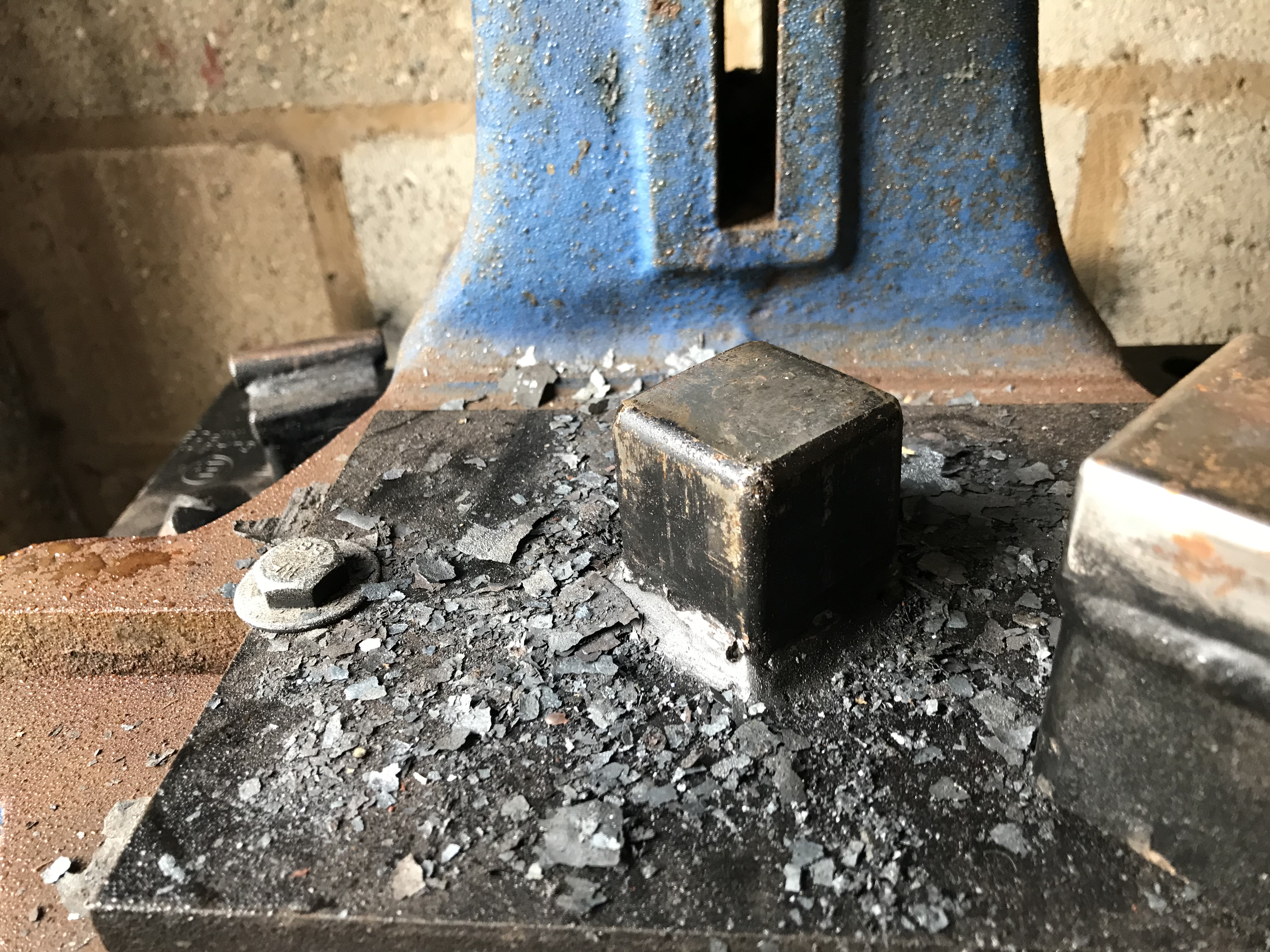

I've just picked this up, A denbigh No. 4 (4" throat, 7.5" daylight, 44mm screw). It's in lovely condition (I have the handle & weight too). Metals and fuel may be expensive in the UK, but flypresses are cheap and plentiful :) This was a snip at £100.
My question is about tooling. It won't be hitting anything too large, I rarely work on stock much bigger than an inch square, and will be mainly used for flatting, fullering and a bit of punching. Also a little drawing out on small damascus billets.
I'm going to make a pair of flat dies, and wondered what may be the best size to make them; I'm guessing anything more than 1.5x2.5" may be a little pointless on this size press? Any pointers would be appreciated.

I have seen that - superb! Buuuut.... I had another issue - most of my work is less than an inch thick and even with some dies, I had to make up 2" for the dies to meet. I'll get some pics tomorrow, as I came up with a solution that included a quick change for the bottom tool/die.
In the end I made flat dies from some D2 and some drawing dies from some old coil spring. Love this thing! Made short work of some damascus billets recently. :)
Some pics of my quick change tooling; the top is the standard 1" rod and shaft collar. The bottom is some 15mm thick plate with some 40x40mm bar welded to it. the bottom tools are a piece of 50x50mm box with a 5mm wall thickness with the tooling welded to the top. That's my flat die, others have a 10mm top plate with the tooling welded to it.
Hope that makes sense - sorry for the metric!
