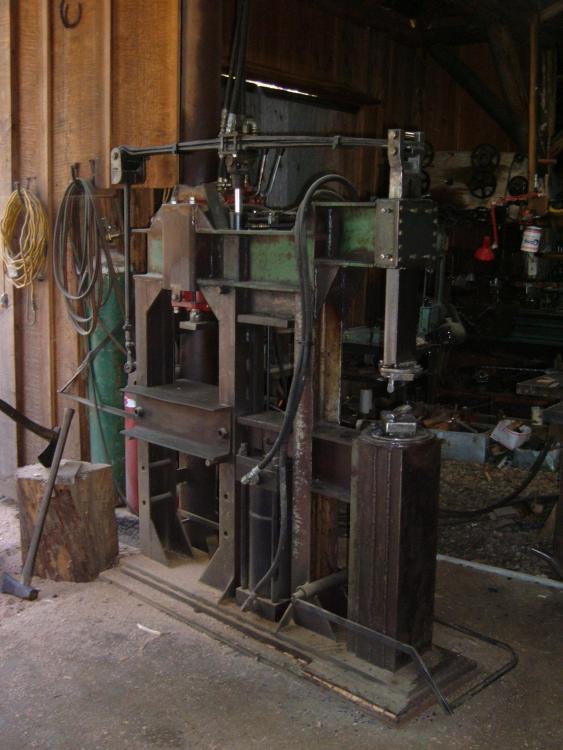

I have a hydraulic power hammer. No working camera atm tho. Might find an old pic or two somewhere.
It is basically a "rusty" style hammer on steroids. Has about a 75-80 lb 2x4 solid steel bar with bolt on top dies for the head, and 2 dump truck springs.
The "cam" plate that connects with a long drag link to the rear of the spring is mounted to a hydraulic motor. The motor is controlled by a flow control valve, which is activate by the foot pedal, giving varying speed control, I can even one hit quite well with a tap of the pedal.
Now the center pivot of the leaf springs is mounted on a hydraulic cylinder that has a control valve next to the ram head for easy adjustment of striking height. I can go from slapping the dies to about 7-8 inches up.
Oh, an since it is so long, about 6' overall (5' long leaf springs) I ha room to put a 7" bore cylinder for a push-up forging press, an a 5" bore top own press next to it, all under an in line with the leaf springs.

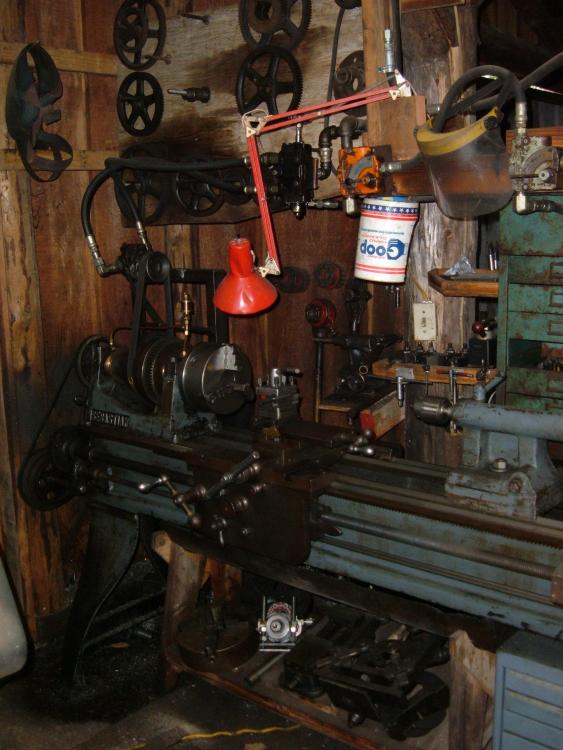

That machine, my lathe, a big bandsaw (30" parks), a couple belt sanders and a iron twister are powered hydraulic with a 2 stage pump on a 15 hp diesel engine outside that I usually run just above idle for good speed, unless I feel spicy and crank it up :)
I'll see if I can fin some stored pics if anyone is interested, I think my old photobucket is still there.
