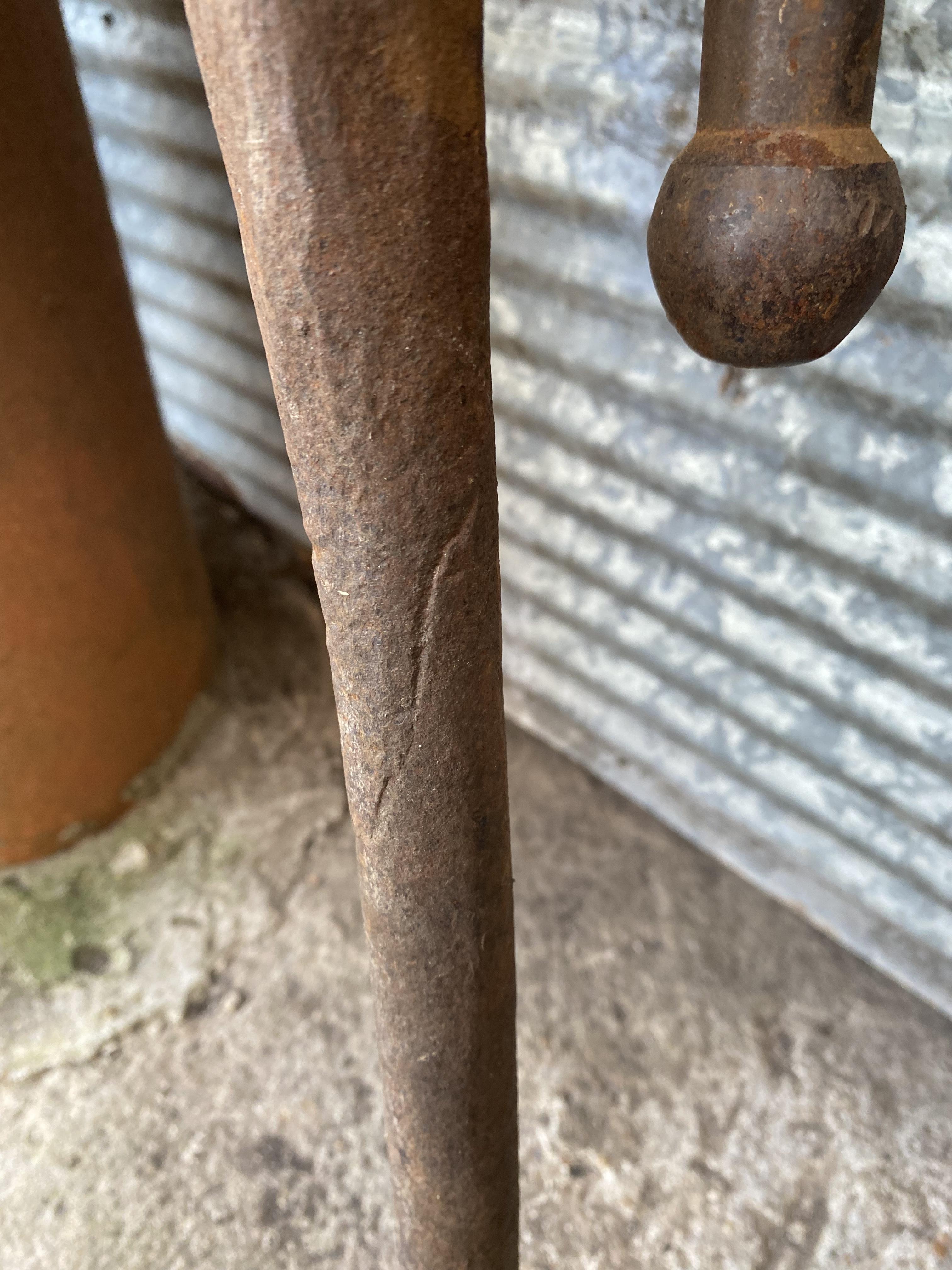

January 9, 20224 yr I have question, so i dotn open new topic. What people do to vises so post rod is allways broken. For example How deos it brakes? two different vises
January 9, 20224 yr I have seen several where the post was cast into the shop floor and was truncated when they moved it so they didn't mess up the floor. Also some postvises had a forge weld in the shaft that can fail over time.

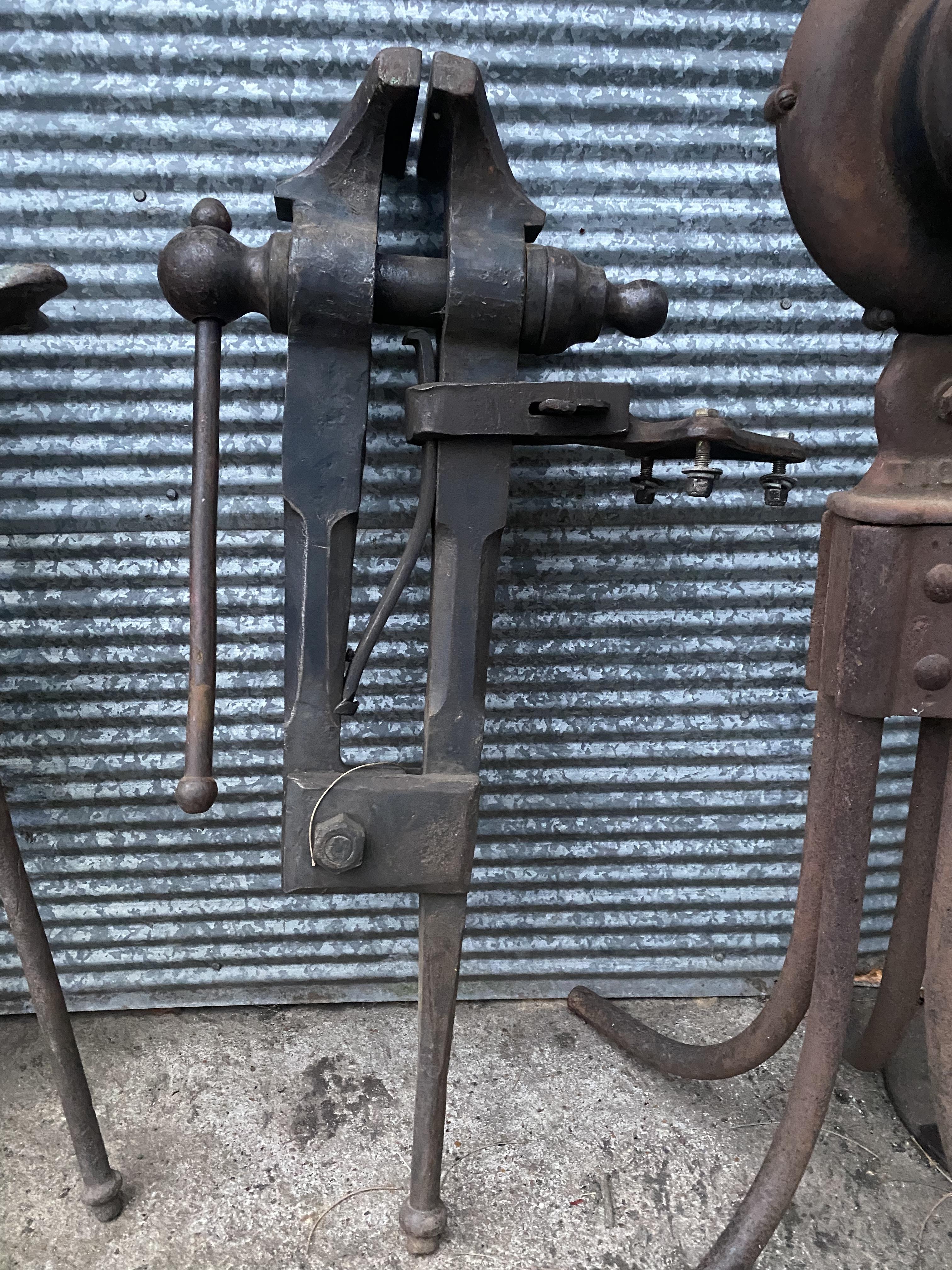

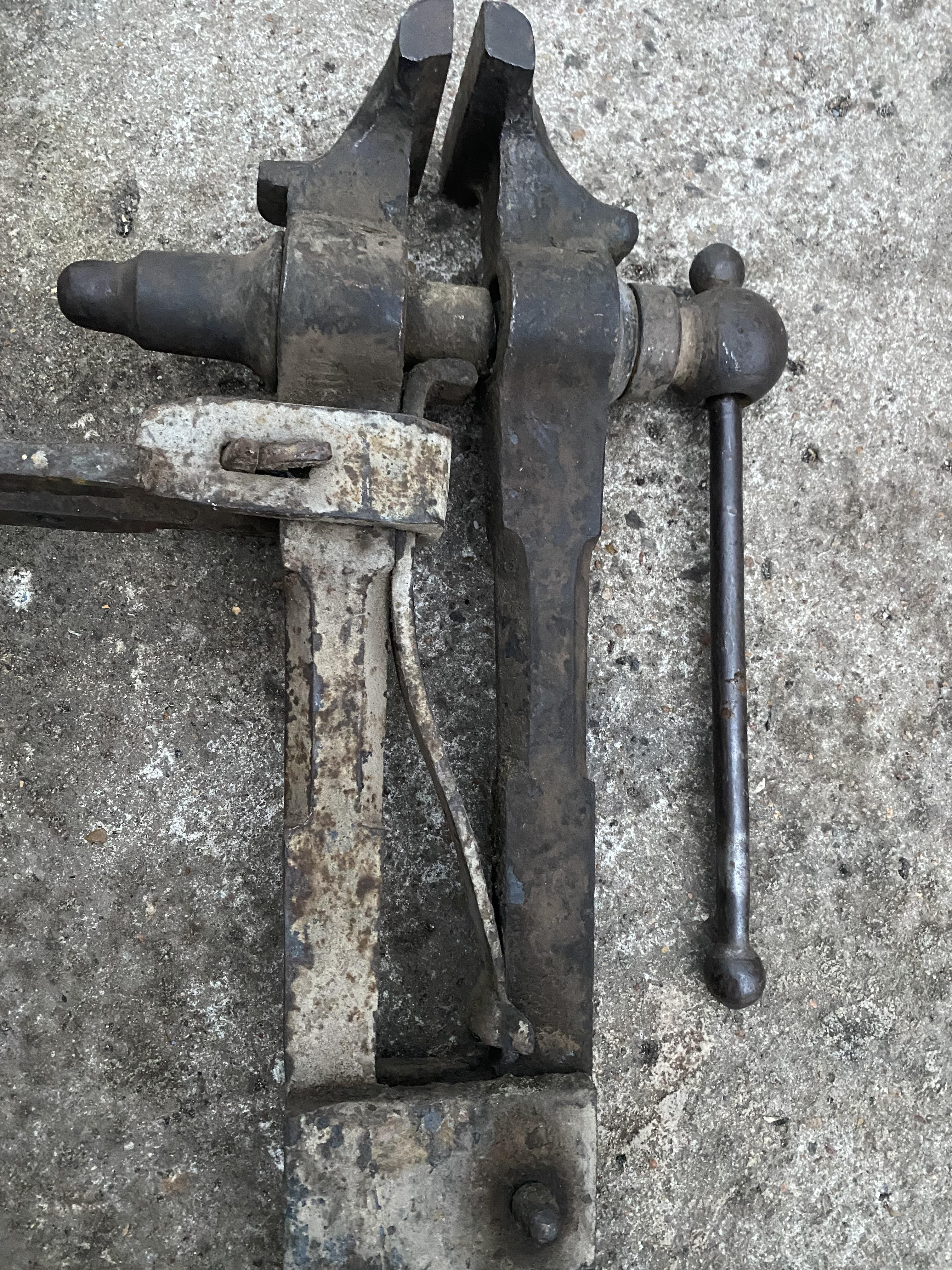

January 9, 20224 yr 1 hour ago, natkova said: How deos it brakes? 1 hour ago, ThomasPowers said: Also some postvises had a forge weld in the shaft that can fail over time. Here’s another one of my vises, it has a welded on leg, to give you an example of what Thomas is talking about,
January 9, 20224 yr So its probably weld that give away. Is post vise usable with broken that leg i wonder it will loose balance.
January 9, 20224 yr It’s usable for light stuff as is, but if you really want to work hard with it then it’s gonna put some major stress on your mounting bracket but don’t despair!!! There is a fix!…. Just make a new leg and weld it on where the original was broke off! then you can use it as hard as you like!
January 10, 20224 yr I had a postvise with a greenstick fracture that we first rewelded the fracture and then forged out a strip of wrought iron and spirally wrapped it around the leg where the break had been and then forge welded that all together too. High grade WI, you can't see the weld seam for most of the section welded. Almost made me want to try a barrel!
