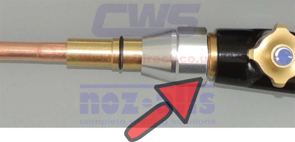

Luke Rieman Posted February 16, 2021 Share Posted February 16, 2021 I've recently bought a type 5 oxy propane torch setup and I have an economiser on the way. One thing I've realised is that with the single-flame brazing tips I have for heating, there won't be any part of the tip that will catch on the economiser hook and allow me to hang it securely. I've seen a lot of US guys on youtube with what looks like a little mini-hook on a hose clamp, but I can't find them anywhere or even any reference to them. Also, my shank isn't the nice all-brass type with a round cross-section, so I don't even know if one would fit on mine. What am I missing here? Surely everyone needs to hang their torch at some point? Link to comment Share on other sites More sharing options...

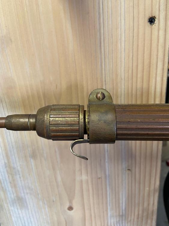

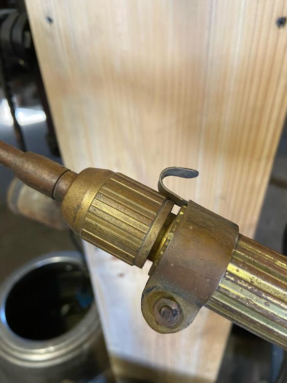

Steven NY Posted February 17, 2021 Share Posted February 17, 2021 Hello Luke, This is what I use. I made it out of brass sheet metal. I have made many clamps this style out of steel also, for antique motorcycles. The hook on the brass one I use with my OA torch is soldered on under the clamp. Hope this helps, Steven Link to comment Share on other sites More sharing options...
Frosty Posted February 17, 2021 Share Posted February 17, 2021 Nice Steve, I like it. I wonder if extending the bolt tabs enough to cut a hook would work without being in the way. Hmmmm. Frosty The Lucky. Link to comment Share on other sites More sharing options...
teenylittlemetalguy Posted February 17, 2021 Share Posted February 17, 2021 On 2/16/2021 at 2:50 PM, Frosty said: What brand oxy prop torch did you buy Tristan? Does it have the thumb on/off valve on the handle? Jerry, regular 2 pc Victor cutting torch. I wanted to get "welding" tips for it as it is clunky to braze with the cutting head and way to hot for small stuff. They make one for oxy propane that replaces the cutting head and lets you use different size tips. It is expensive though. I did just learn that they make propane tips for my Meco Midget (which totally rocks btw) I am very excited to get the tips soon. It would let you control the gas with one hand as the valves are above the handle. I sure like Steve's hook, seems like a perfect solution to me. Link to comment Share on other sites More sharing options...
