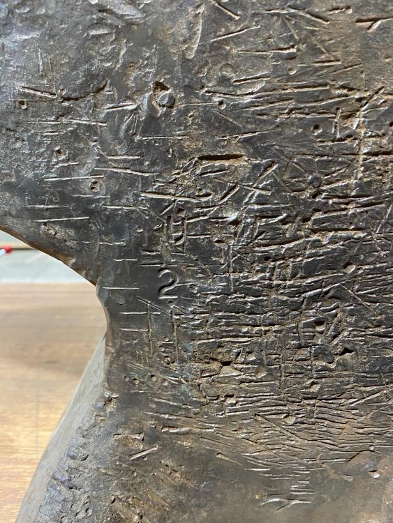

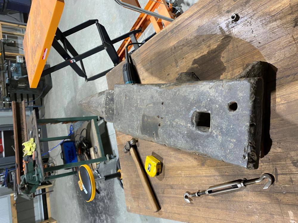

Hi all! I'm from Australia. I'm new to the site and see there are some real gurus on here who can hopefully help me identify an Anvil I picked up recently. From what I can tell its old and potentially wrought iron with the hard plate on top. The sides have a strange pattern on them which might have been from misuse but could also be from manufacture. I've seen similar marks on a Soderfos Anvil but also thinking it could be a Mouse hole. Measurements are: Length: 750mm (29.5") Height: 320mm (12.6") Plate width: 145mm (5.7") Hardy hole: 25mmx25mm (1"x1") Pritcher Hole Dia: 15mm (5/8") It has a grab hole in either side of the waist and one in the bottom. I've wire brushed the sides so far and have only found a "7" on the foot under the horn, a "2" indicating the first number in the weight sequence, and a "U" above the 2. I thought I could see an "R" in front of the U but not certain. The weight is 132.5 kgs or 292 lbs. Any help would be muchly appreciated.  I thought I could see a 307 on the opposite side (bottom Pic3) when I was wire brushing but that could have been my imagination. Thanks in advance!

I hope you have read about not doing any grinding, milling or welding on the hardened face, which does more harm than good. I would say she is ready to be put back to work and hammering hot steel on the face will shine it up in short order..

As the body is made from soft wrought iron; testing on it would give you a different answer than testing on steel!  I'd go with Mousehole too as the keel on the underside of the horn is typical IIRC. Of course there have been over 200 anvil makers in the UK and many of them learned the trade working for Mousehole or Peter Wright and so went on and made anvils that look a lot like those two.
How much does it weigh?  That 2 should be the first number of the CWT weight.

I have a later Mousehole and the weight is on the opposite side of the U 2 on yours. I think the U2 on your anvil is a much later addition, more modern looking, it also looks too clean and crisp.  The logo and CWT weight on mine are visible with the horn to the right. It may very well be a mouse, but the U 2 was an add on I believe.

Anvils can have a lot of extraneous markings on them: inspector who inspected it, team that built it, foreman of the team that built it,  the batch of steel used to make the top section, etc.  Some of them we really don't know what they indicated 100+ years ago. And then there are markings added since original manufacturing...Dealers who sold, Companies who bought, Smiths who owned. Indications of government ownership, etc and so on.
