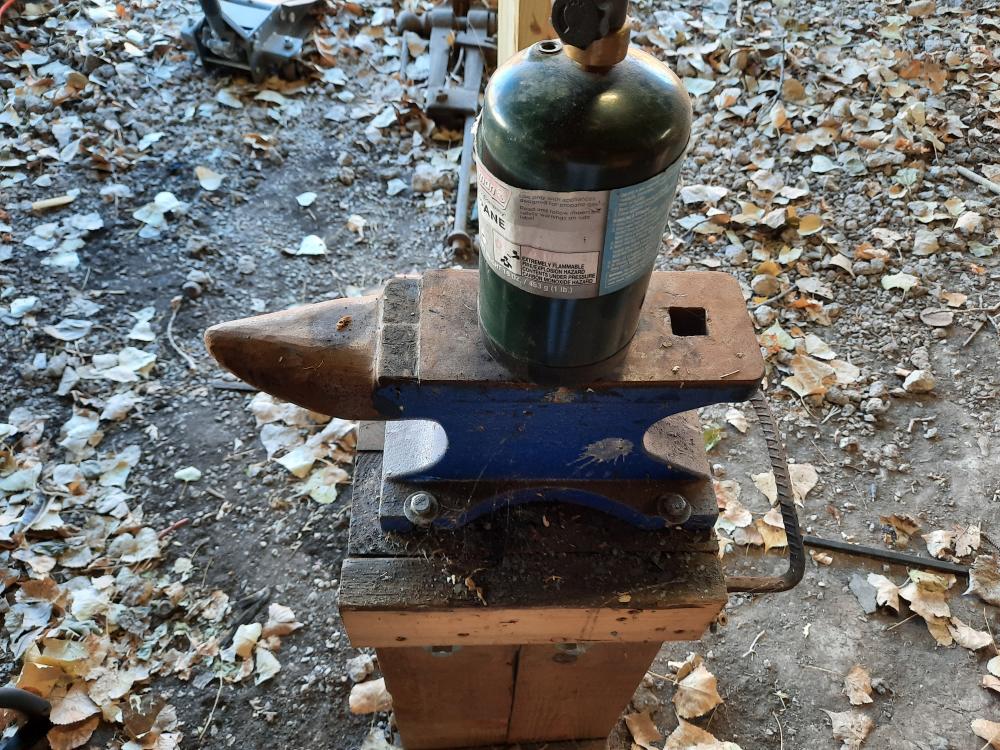

100# Fisher,  pretty good shape.  My bride found it less than 20 miles away on Facebook swap shop.   She has been searching auctions/ Craigslist/ Facebook for months with a multi hundred mile radius.... she refuses to tell me how much,  but less than $4 per pound.
The top is speckled,  but no major dents.  There is some corner damage, but not too bad.  The bick is pretty scarred, as is the upsetting shelf.   I tried to use a wire brush to clean off the date,  but I'm afraid of damaging it.  It's weird,  like someone added material over it.   The eagle is also pretty corroded,  didn't want to damage it.
Pretty sure njanvilman will chime in with what he can determine (I hope! ), and looking for advice for how to clean it up.

I'd hazard the guess that if the third from the left number is a zero then the first two would be 19 giving 190? which is close enough for blacksmithing!
ISTR one where they chiseled the last digit off and stamped a different one in as the date was used for the warranty and so was to reflect the year of original purchase. NJAnvilMan can set me straight if I've had a cranial eructation.
I read the last number on the right as a 5 but in a larger font.  I see the reversed C in the lower part and a vertical line on the left above the reversed C.  That would give a 1905 date.

How's the rebound?

Interesting how the sweet-spot edges are in seemingly perfect shape.  The chips being more towards the heel...  I usually see the reverse.

Just found this post, two weeks late.  Yes, it looks like 1905 birth date.  BTW, the dating was done for their one year warranty on the anvil.
No cleanup aside from wire brushing the rust.  Then apply any light oil to keep it from oxidizing again.  Hammer away.  Do not grind the face.  Just use it!  A nice smooth area will soon appear.
