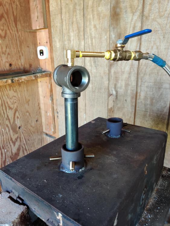

jt0119 Posted August 1, 2020 Author Share Posted August 1, 2020 Not yet, I'm just going by the sound and what I'm seeing. The only time I've heard a similar sound is a few videos I've watched where that was the issue, and I can see the flame moving up into the hole I have in the refractory. Link to comment Share on other sites More sharing options...
Frosty Posted August 1, 2020 Share Posted August 1, 2020 Audio can be just as deceiving as color in online videos. You need to investigate before you start imagining if or what's wrong, could be nothing. Here's the important question. Is it getting hot enough to use? Then is it making scale IN the forge? The occasional pop or sputter is nothing, they all do it. Frosty The Lucky. Link to comment Share on other sites More sharing options...
Mikey98118 Posted August 1, 2020 Share Posted August 1, 2020 Blue flame in the exhaust is kinda important too--in a very bad way Link to comment Share on other sites More sharing options...
jt0119 Posted August 1, 2020 Author Share Posted August 1, 2020 It's definitely putting out plenty of heat, and I don't think any scale is forming until I pull it from the forge. It's very possible I'm just overly jumpy after having so many issues getting to this point Mikey, if you're talking about any dragon's breath, I'm pretty sure it's all nice and yellow! Link to comment Share on other sites More sharing options...
Mikey98118 Posted August 1, 2020 Share Posted August 1, 2020 Dragon's breath, and what it means ()or doesn't) could make an entire chapter in a book, or a sticky thread on IFI. Making educated guesses about chemistry can be a drag. Link to comment Share on other sites More sharing options...
Frosty Posted August 1, 2020 Share Posted August 1, 2020 By "yellow" I HOPE you mean orange as in oxidizing calcite binder in the refractory orange. Yellow would be worse than a little blue in the dragon's breath. Mike: Is your read on blue dragon's breath, rich or turn the burner down, or? I know you've said but I can never seem to remember. I'll write it down this time. Honest. Frosty The Lucky. Link to comment Share on other sites More sharing options...
jt0119 Posted August 1, 2020 Author Share Posted August 1, 2020 It looks pretty much identical to what was in the original video, so if you didn't see anything wrong there, we should be good! I'm also curious about the blue dragon's breath. Never seen it personally, but if it's bad I'd like to know how to fix it. Link to comment Share on other sites More sharing options...
Mikey98118 Posted August 1, 2020 Share Posted August 1, 2020 You could say that forges can have up to have three flames; the burner flame; the forge atmosphere; and the exhaust flame, if any. Ideally, there should be no flame in the exhaust gases. even a neutral flame can be turned up high enough to continue burning outside the forge. More commonly, secondary combustion products in reducing flames are what continue burning in the exhaust gases; they can be yellow orange-red, and or blue. Blue flames in the exhaust are carbon monoxide being combusted; what is bad about them is that not all of that Co is combusted...a little bit of blue flame licking around the exhaust port, indicates that an even smaller amount of Co is escaping into the shop. But I have also seen photos of LARGE blue flames pouring larger amounts of Co into shops--this is bad. To be thorough, nearly solid yellow to wispy orange exhaust flames can be made by calcium binders in some refractories, as they burn off. Did that help, or does it just muddy the waters? Link to comment Share on other sites More sharing options...
jt0119 Posted August 1, 2020 Author Share Posted August 1, 2020 That helps immensely, thank you! Something to keep in the back of my mind, for sure. Link to comment Share on other sites More sharing options...
Frosty Posted August 1, 2020 Share Posted August 1, 2020 Blue forge atmosphere or exhaust is burning CO. Turning the flame down would still leave uncombusted fuel in the forge atmosphere. More combustion air or something else? I've never had blue flame in a forge atmosphere or exhaust. Burner flames themeselves are it for my personal experience. Thanks Mike. Frosty The Lucky. Link to comment Share on other sites More sharing options...
Mikey98118 Posted August 1, 2020 Share Posted August 1, 2020 4 hours ago, Frosty said: By "yellow" I HOPE you mean orange as in oxidizing calcite binder in the refractory orange. Yellow would be worse than a little blue in the dragon's breath. Mike: Is your read on blue dragon's breath, rich or turn the burner down, or? I know you've said but I can never seem to remember. I'll write it down this time. Honest. Frosty The Lucky. And this is why I keep implying that this subject would make a well justified permanent thread (so far as its value is concerned) and a rabbit hole (which is likely to stretch into a twenty pages long bone for us tired old guys to chew So, wispy to nearly solid orange flames versus nearly solid yellow flames; which one indicates oxidizing calcium binder? I have seen both in photos of the same troubled' forges shown on IFI And, yes, I know that calcium flames are orange; not yellow. But, since the yellow flames appeared in some of the same photos as the orange flames, and since they were nearly solid colors and a peculiar tint, which I have never seen before or since in exhaust, I conclude that something else in the binder was cooking off at the same time as the calcium. I would like to say with certainty that blue flame is from a rich mixture; in the case of a whole lot of blue flame, I am certain that's the case. When a tiny little bit of blue exhaust flame is present, I have to say "yes, but..." I really hate uncertainty; the uncertainty in this case is not of what, but of why. I know how to stop it, but I have a niggling uncertainly that I truly know all that I think I know...ugh/!!! I HATE that Link to comment Share on other sites More sharing options...
