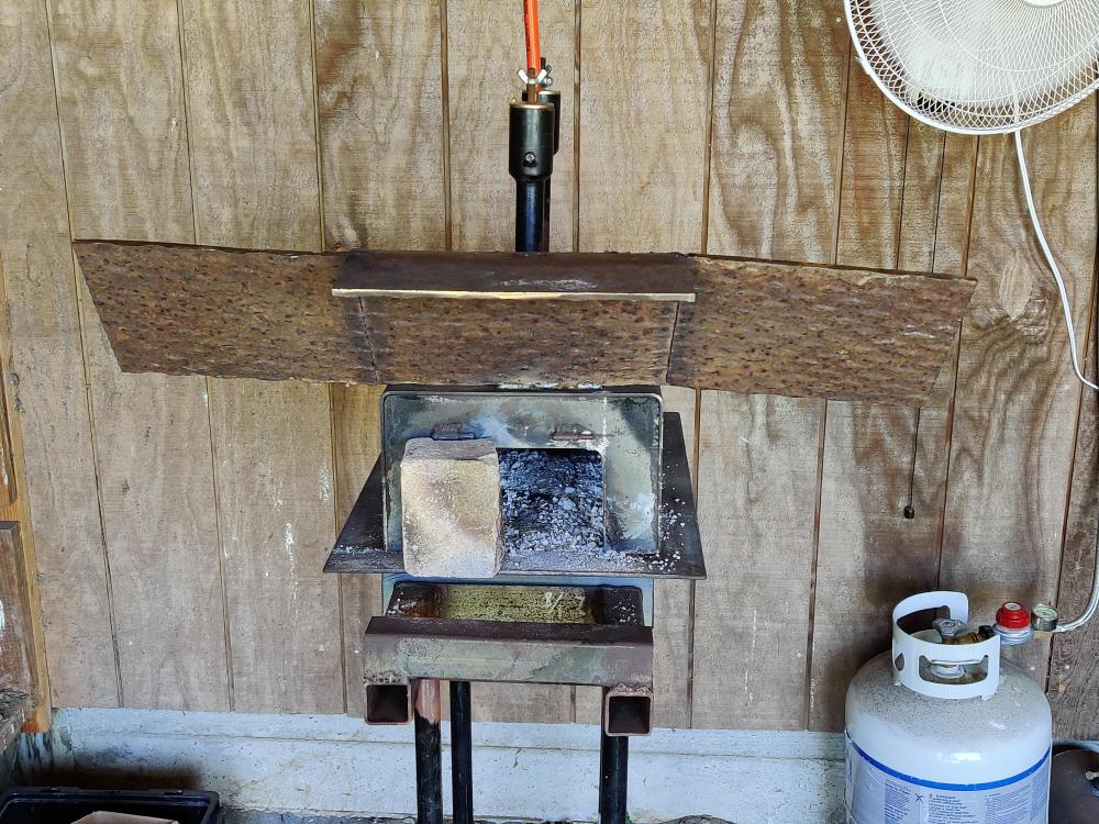

Okay, I couldn't stand it and reread much of the thread and watched the video that SAYS you have to have permission to see. It played okay.
What I see going on looks like the burners are taking in some exhaust gasses instead of just clean air. Every once in a while the volume goes up, the flame becomes longer and more opaque then goes back to more transparent and sputtery. My bet is at lower output the exhaust isn't so great and the burners clear the worst and start working and produce more exhaust which swirls up into the burner's air.
The fast check would to to turn your burner on it's side and fire it up.  If the flame's louder, longer and more opaque then it's breathing exhaust. I have to use a sheet of steel over the openings on my shop forge to deflect exhaust away from the burner intakes. Mine are vertical on top of the forge as well.
If you still have one good flare or enough remains, make a pattern and copy them. Maybe think of a brow or bill out over the openings to deflect the exhaust farther out.
Yeah, when I initially posted it I forgot to give that file open permission to be shared, hence the warning. Both the flares that work better are installed, so I'll see what I can cobble together for a hood. I'll report back once I have some kind of result.
Well, we have a result: no difference. It did initially seem to take longer at first, but after modifying the hood slightly and letting the forge cool, it took about 5 minutes to go back to that teal flame. The fluttering is maybe slightly less aggressive, but it's minimal at best. The only other thing I can do is fill the receivers with kaowool to keep any exhaust from escaping there, but I don't know if enough is escaping there to really be of note.
Nah, I had just shut it down for the day and buttoned everything up to prevent making things even worse for myself lol. The picture was more to make sure my hood was enough to make any difference or if I need to go back to the drawing board.

Try rotating the hood 90* so it's wider than long. The brow I use on mine is maybe 6" out but a good 24 wide. The lid on my too large shop forge is 18" square and it needs to get the exhaust away from the burners. I believe the wide flat lid tends to draw exhaust in towards the center by it's shape which may not apply to yours.

I didn't cut the top off, but I added some wings to the Frankenstein-like monster this is becoming. No change.
I'd lay it flat so it doesn't form a chimney up and over the deflector. Mine just lays flat on the forge lid. Maybe my forge is high enough it doesn't effect my vision much. If a breeze is blowing crosswise it doesn't need the deflector.
I had a sheet steel corner thing that sat on top of the forge and made a big difference but it looked really hokey and was really in the way.
