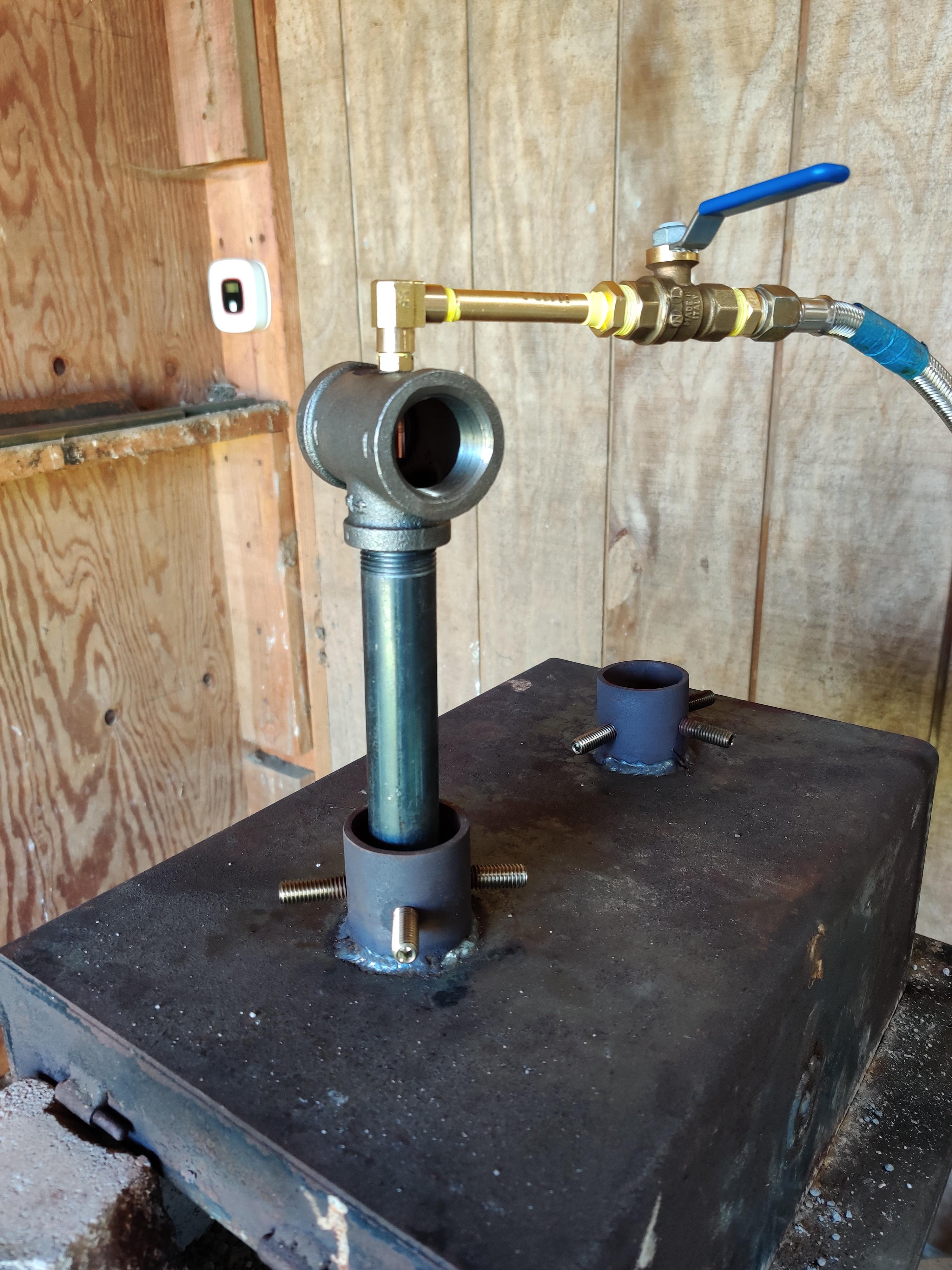

So I ended up building a T burner, and it's already working better. I'm still in the process of tuning it and figuring out a mounting solution, but I'm fairly pleased so far. I'll update once I get it mostly dialed in.

Alright, got a video of the best flame I can get out of it, and pictures of the burner if there's anything I need to change about that. I've tried .030 and .035 mig tips, and shortened one of each. Cutting 1/8" off either doesn't seem to do much, and 1/4" makes it worse. I've also played with the nozzles I made, the Zoeller nozzles I got, and a black iron coupler. The video is with the nozzles I made.
Video of the burner running:
https://drive.google.com/file/d/1nmrQa-WcGLOYZi0JAaiX5mTIFi23fO4H/view?usp=drivesdk
A pic straight through the T so I can see where the jet is will help. It's sputtering just like the other burners. Did you plug the unused burner port so it isn't blasting exhaust gasses straight up at the burner intakes?
I'm sure you told me but but I forget, how many cubic inches is your forge?
Huh, I meant to include the straight through shot. Looks like I accidentally uploaded the wrong one. Either way, I was playing around with it and got it to burn MUCH better. It still sputters occasionally, but it's doing the opposite of what it was before. Burns perfectly well 99% of the time, sputters for a split second, then goes back to burning just fine.
Overall the interior is 384 cubic inches.
The flame looks good from here. That is a mighty small volume for two 3/4" burners they're really going to interfere with each other. The others may have worked but I bet they used pretty small jets, say,  0.023 so they run choked almost closed.  They'd make fast flames and overcome the fast but not strong back pressure generated by the second burner.
I don't think you want to trim 30 cu" off the volume and mount the burner in the center do you? Be easier than making it 200 cu" larger.:ph34r:
As is I'm wondering about making it work with one 3/4" and one 1/2" or changing it to three 1/2" burners. I just don't see two 3/4" T burners playing nice with each other in that small a chamber. Maybe just over clock one center mounted burner, 35 cu" worth?
Occasional sputter is just exhaust swirling around and the burner getting a puff. Not a thing. Leaning the burner away fro the opening rather than towards it might solve that little issue. Of course it might just be camera angle.
I think for now, I'm just gonna run it off one and throw a fire brick in there to reduce the amount of space it has to heat. I designed and built this before I really had any idea what I wanted to do, and I can't see myself needing a dual burner anytime soon. It's not an ideal solution, but it worked for me before, and if it becomes an issue, it's easy to undo. If that's a terrible idea though, let me know. God knows I'm not immune to those :lol:
