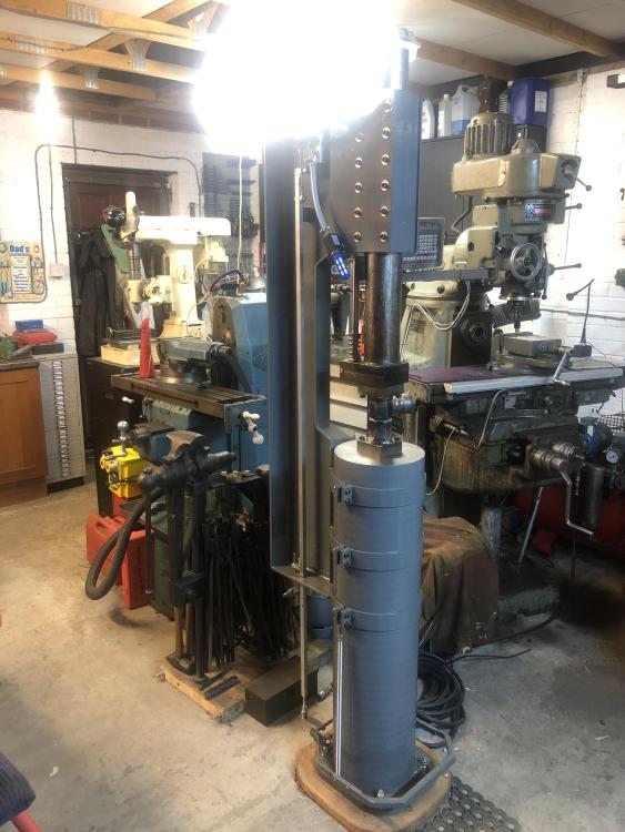

Thanks frosty. The hammer certainly needs a proper foundation. Here is a pic in its current resting place, although if I develop it to be more useful I will probably move it to somewhere were I can cast a proper isolated block.
sorry, the picture is not the best. The hammer does not have a halo in real life!
Just putting it on a larger foot plate will reduce the ground noise. What happens at impact is the ground is deflected causing compression (sound) waves. If the impact is dispersed over a wider area the compression waves are reduced exponentially, 2x the area = 1/4 the ground noise. Put your hammer on a base plate say 75 - 100 cm square with an inner tube thick piece of rubber or better felt under it and it'll be problem gone.
Think of the effects of dispersing the force over a larger area like driving a nail head first.
I have some oak sleepers to mount the hammer on. The issue is that the anvil piece is a bit long already so the hammer will be too high. I could solve this by creating a standing platform or if I move the hammer, sit the sleepers in a pit to lower the overall height.
What's it sitting on now, a piece of plywood? I can see the floor mat. Remove them and bolt or weld it to a piece of 20 - 25mm steel plate. That should lower it slightly but more importantly go a long way towards solving the neighborhood rattle. That may be all the solution you need.
Digging a pit and putting a power hammer on wooden sleepers is really turn of the last century technology. If you're going to do that much digging then making a proper base under the hammer foot will do you better for less work.
Without knowing what the subsurface is like there I have to be really general but if it isn't too wet you could get away with 1/2 cu/m of what we call D-1. This is a gradation of gravel that compacts like concrete commonly used as the sub base for paved roads and highways. the Sub base is the layer directly under the pavement. The Base is whatever is below that until you run into compacted fill.

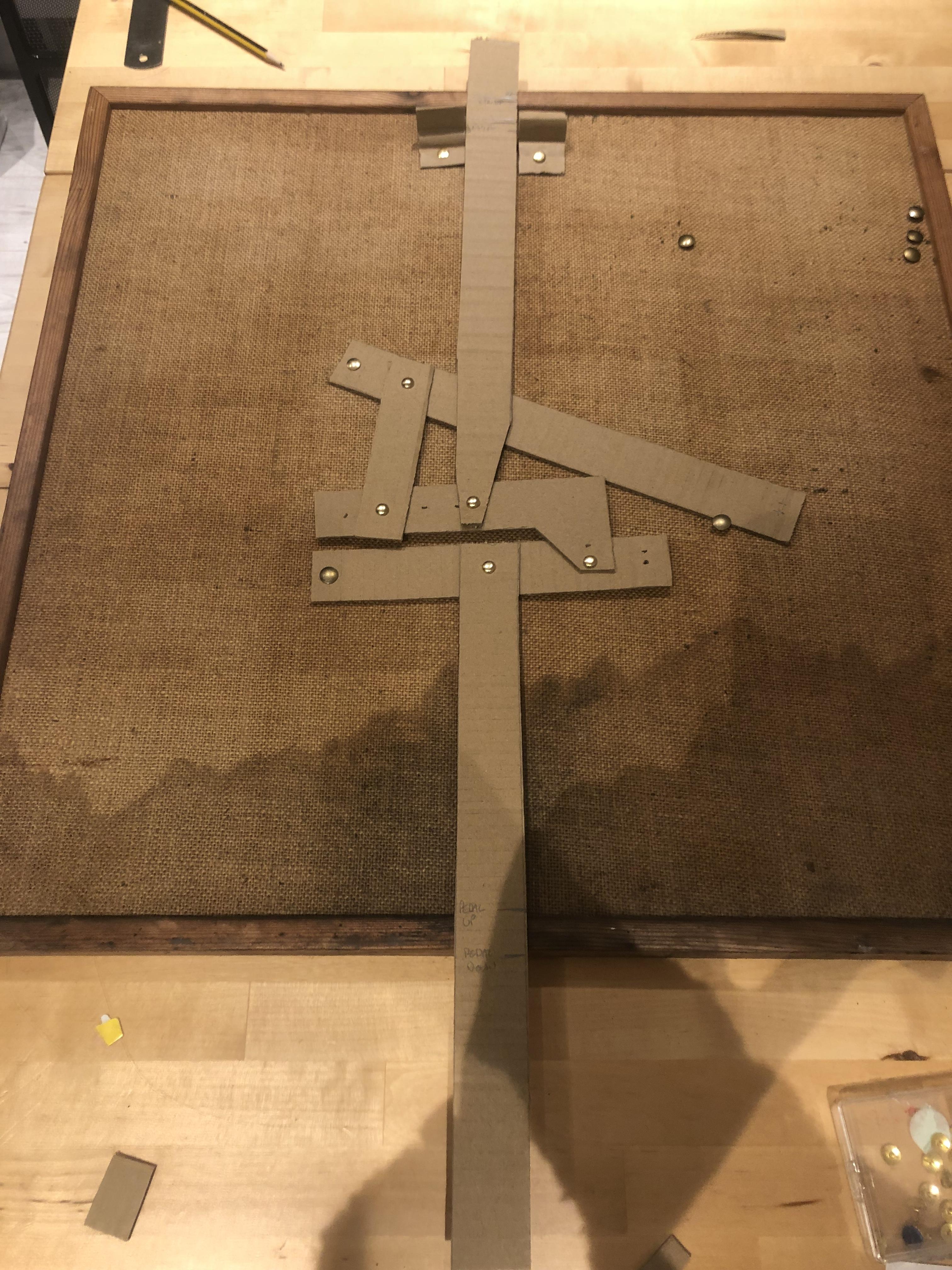

Well I have caught the dreaded covid and so, in England, that means you are stuck on you property for 10 days. To give my wife and kids a rest from me I have decided to develop the power hammer from striking function to reciprocating.
I have used cad (cardboard aided design) to lay out an ‘adding’ mechanism that adds the input from the foot pedal to the plus and minus input from the ram. See the pic to show the concept
The lower rod is the foot pedal input, the lever to the right is the ram feedback and the top rod connects to the valve control
This is the mechanism so far, in real life
Well I have completed a first working version of the mechanism. It works well but there is still some tidying up to do ( like proper shoulder bolts for pivots rather than running on a thread) and a bit of tuning.
I have a video of it running, but I guess uploading that directly may not make me any friends. At some point I may make a YouTube video
I have finished the hammer reciprocating project and I am pleased with the result. I am getting about 150-200 bmp and it is controllable, although the controller needs some practice!
