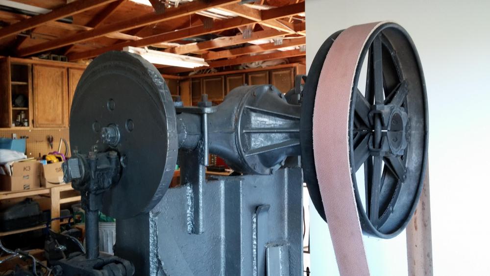

M.Griffin Posted March 1, 2020 Share Posted March 1, 2020 I had a hammer based on this at one point. I was told it came from a blacksmith shop in Carson City, NV. I sold it years ago when I knew I was going to be moving several times. It was a pleasure to use and hit hard. It was around 60 lbs if I remember right. Mine was driven from a flat belt to a large wheel. I will try to post photos if I can. -Mike Quote Link to comment Share on other sites More sharing options...
M.Griffin Posted March 2, 2020 Share Posted March 2, 2020 I think I figured out how to post photos. One is from before I refurbished it and one from after. I dont have many pictures of the hammer, but you can sort of see how it worked. The treadle applied a brake to the off side which engaged the hammer. It was quite controllable and very simple. I regretted selling it for years. -Mike Quote Link to comment Share on other sites More sharing options...
slickd1 Posted March 4, 2020 Author Share Posted March 4, 2020 Oh awesome! I like the idea of shortening the axles. Would make for a much more compact hammer. Yeah, I'm aware that the spring mechanism is far more complicated than it has to be. And will be updating it eventually with a heavier hammer and lighter rotating mass. Along with a lot more panels covering the moving parts. For starters I wanted the spring tension to be easily variable though and free is good to start with too. I wonder why they had so much rotating mass in the flywheel on the front of the hammer there. The next project is a pneumatic hammer and forging press. The log splitter I recently picked up seems to work quite well, but I might substitute in a larger cylinder as it perhaps moves too quickly and could do with a little more force. Quote Link to comment Share on other sites More sharing options...
