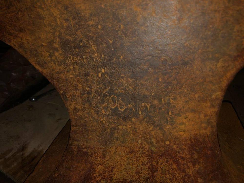

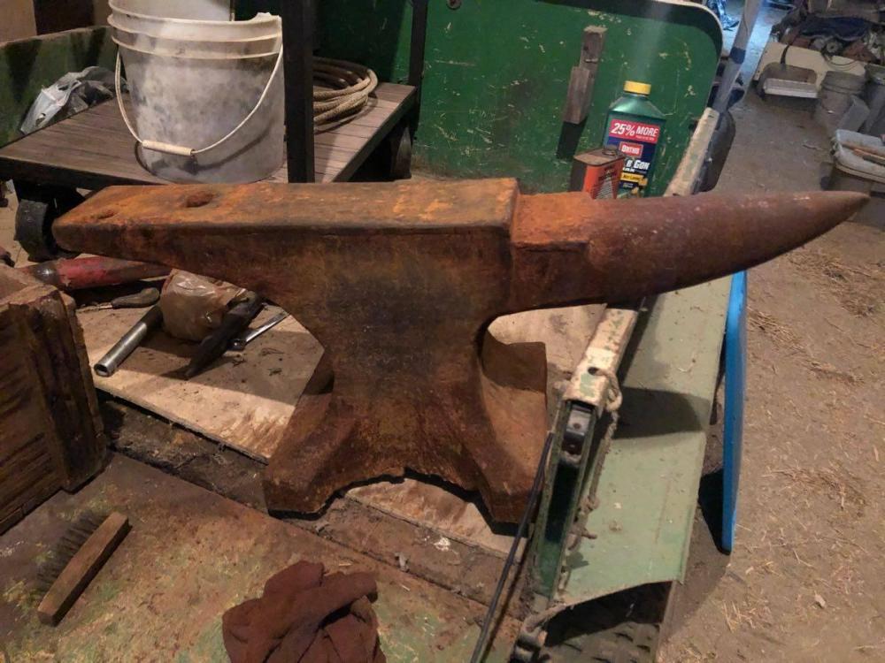

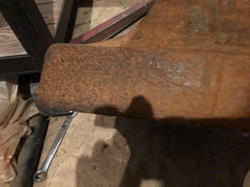

Manno Posted January 17, 2020 Author Share Posted January 17, 2020 oop! Been away a few days. Here are some pics. Someone bought it I believe. Link to comment Share on other sites More sharing options...

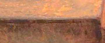

Kozzy Posted January 17, 2020 Share Posted January 17, 2020 Is this in the photos a likely sign of delamination starting or is it pretty normal for these anvils? Link to comment Share on other sites More sharing options...
MC Hammer Posted January 20, 2020 Share Posted January 20, 2020 It's quite common to see that on the side of anvils and is not necessarily a sign of delamination of the hard steel face. If you just look at 100 anvils you will see similar marks on 98 of them most likely. If you tap the face with a hammer you should hear a "Ping-ping-ping". If it sounds dead there or makes a different buzzing ring sound you have a problem. It's why it is so important to do proper testing on an anvil prior to purchasing it. Link to comment Share on other sites More sharing options...
