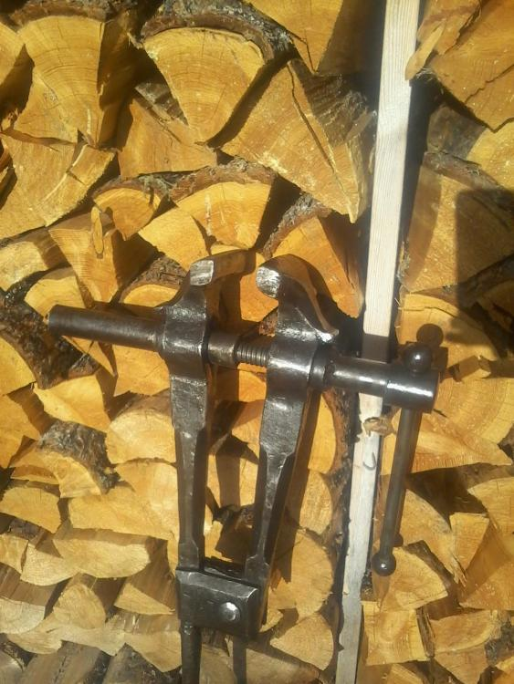

Springs are rather trivial as they don't have to be made from spring steel and so you don't have to mess around with heat treating a higher carbon steel correctly.  Even when I do use a piece of leaf spring I just normalize it.
The 60 is probably the weight as they were sold by the pound in the old days.  The Wheeling may have been a hardware store that sold vices made by any of a number of manufacturers.
Hi I think maybe the screw threads ( box?) Might have been replaced for it is mig welded and everything else is forged
I bought it a while back off ebay can't recall from where it was shipped I live in St Ignatius   Mt
I'll try to update my profile, thanks for your help its been very informative (I know better then ever, how little I know) LZM
It sure looks like the screw/screwbox is a retrofit and so I'd bet the vise was not made by Wheeling.  The extra long screw box and how far the handle is out front of the vise body both look "off" for that vise body with the bevels on the legs and pivot cheeks.
However if it works for you then USE IT!  The workpiece doesn't care if the vise was reworked a dozen times or if it's 200 years old or 20 days old. It only cares that it holds it securely and is easy to open and close.
