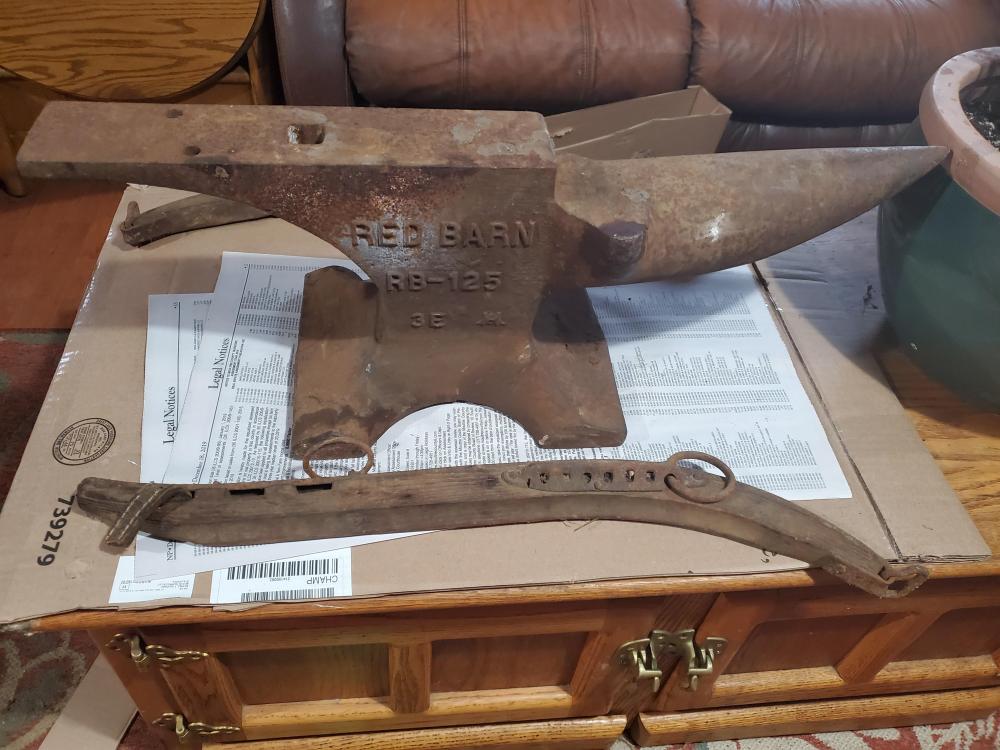

John ingram Posted December 29, 2019 Share Posted December 29, 2019 I bought an anvil and can not identify who made it. Would like some.feed back thanks the horn is wider then the rest of . Quote Link to comment Share on other sites More sharing options...
Conrad.blacksmithing Posted December 29, 2019 Share Posted December 29, 2019 Cool anvil! It is definitely cast but I have never heard of that name so I cant say what material it is made of. Hay Budden made an anvil like that but that's not it. If you forge put it to use and enjoy. Quote Link to comment Share on other sites More sharing options...
Irondragon Forge ClayWorks Posted December 29, 2019 Share Posted December 29, 2019 Welcome aboard... The only thing I can tell you, is it's a farrier's pattern anvil. Knowing where in the world it's located may help. Hence the suggestion to edit your profile to show location in this thread, which will help you get the best out of the forum. READ THIS FIRST Quote Link to comment Share on other sites More sharing options...
Charles R. Stevens Posted December 30, 2019 Share Posted December 30, 2019 It is indeed a farrier's pattern anvil but as the front of the top plate is back over the sweet spot and the hardy is back over the back feet it is a better design than most I see. Quote Link to comment Share on other sites More sharing options...
Marc1 Posted December 30, 2019 Share Posted December 30, 2019 What is the advantage of the heel being so thin and backwards? Quote Link to comment Share on other sites More sharing options...
Awrksmokey Posted December 30, 2019 Share Posted December 30, 2019 1 hour ago, Marc1 said: What is the advantage of the heel being so thin and backwards? To destroy your ears and everyone in a 100 mile vicinity. Cool anvil though. Quote Link to comment Share on other sites More sharing options...
ThomasPowers Posted January 2, 2020 Share Posted January 2, 2020 Swell Horned Farrier's anvil. I'd check with horse shoeing, (Farriers), supply stores for that brand. Quote Link to comment Share on other sites More sharing options...
