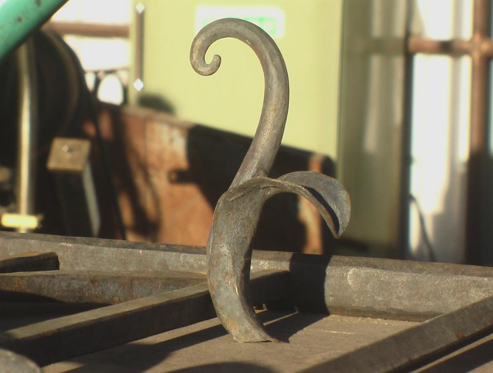

anvil Posted July 11, 2019 Share Posted July 11, 2019 Thats very doable and I use a forgeweld in that situation quite often. Its a great time saver. In the top pics, last on the right, dont taper it quite so small. If this makes sense, Pic three(drawn out) should look like a longer version of pic 2. If the shaft is 5/8", then the end should be a bit bigger than 5/8". Then you dont have to upset it for the scarf, and will not get a wasp waist due to not enough material after forgewelding. If the vertical shaft is 3/8", then it will look as I described, but scaled to the 3/8" material. The purpose is to not draw it too small, then have to upset it back to what it was for a good scarf. Thats redundant and takes time. You did not show the scarf upset in your drawings. Im assuming you know you must add material to the scarf by upseting, or you will get a wasp waist due to lack of material. heres a pic that is as close as i can come to your project. The tendril and leaf are forge welded together, leaving enough material to forgeweld to the stem. no upset, just scarfed. the stem is upset and scarfed. this is a pic of the three pieces. A problem you may have is when you make the candle cup, it may stress your weld and break. So, its best to do this forging at good yellow heat, then reheat to a yellow and forge on. A bit safer way would be to forge the cup on the end of a long 5/8" bar, then cut it off long enough to keep the cup out of the fire and short enough to minimize drawing out when you forge weld it to the 3/8". This keeps the cup out of the heat, and minimizes both drawing out and forging on your forgeweld. theres a lot of little nuances, but this should cover most of the problems. Enjoy Quote Link to comment Share on other sites More sharing options...
Gustav Posted July 11, 2019 Author Share Posted July 11, 2019 Forgot about the upsetting before scarfing, thanks! I also understand what you mean by not tapering pic 3 all the way down. I've never forgewelded before but I'd like to learn, and I think this is good practice. I'll get back to you when the steel arrives and I have time to forge! Quote Link to comment Share on other sites More sharing options...
