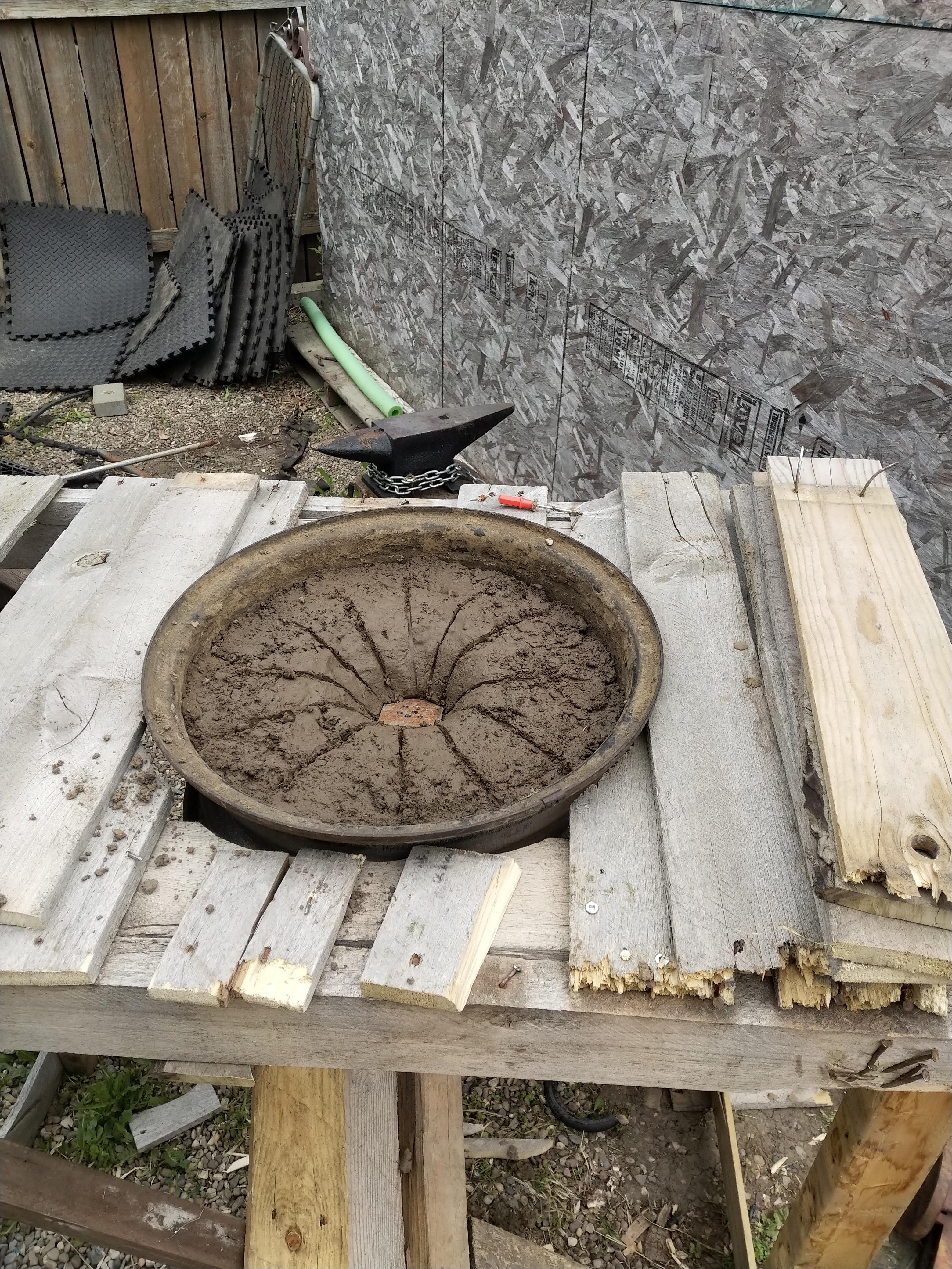

royalpaste Posted June 7, 2019 Author Share Posted June 7, 2019 not sure if this needs a new thread but i ended up making this monstrosity. sorry about the mess Quote Link to comment Share on other sites More sharing options...
Glenn Posted June 7, 2019 Share Posted June 7, 2019 You need a T instead of a 90* bend. The bend will fill up with ash and restrict the air flow. The T will let the ash fall on past and allow it to be cleaned out. Quote Link to comment Share on other sites More sharing options...

Cedar Crest Forge Posted June 7, 2019 Share Posted June 7, 2019 Nice forge start. Wood though? Is there a thrifty store near you where you could buy an old metal desk , or maybe a metal retail display with a shelf, cut a hole in the center, and use that instead of the wood? It looks like a fire waiting to happen. Plus, you could then put your hot items down safely. Actually, your entire area looks unsafe to forge in. Smiths occasionally drop hot steel, and if it fell under that shed, it would make quite a mess. p.s. You can buy the bottom part of the forge, tuyere etc, in solid cast iron and well within your budget. Quote Link to comment Share on other sites More sharing options...
royalpaste Posted June 7, 2019 Author Share Posted June 7, 2019 yeah im gonna put a metal plate on it and remove the wood middle bits. just taking time as i got no welder and angle grinder. those pre made firepot things are 400 minimum for me here ive searched high and low already. im kinda messy sorry, i clean up the area before i work usually just gravel under me (sometimes dirt). forgot to add just had to move there for the day, most of the time i have the forge in the middle of my yard and move the anvil into the shade throughout the day. Quote Link to comment Share on other sites More sharing options...
Cedar Crest Forge Posted June 7, 2019 Share Posted June 7, 2019 The tuyere is 22$. T pipe suggestion is a good idea then , as 400$ is a lot! . p.s. If you put a hot piece of metal on sheet steel, it may still burn any wood supports underneath it. Heat transfer. Same physics apply to your pipe. As it is, the hot coal will slide down the pipe, catch the wood support on fire, and then travel up to the rest of it, all while you are in the front yard, distracted. (Murphy's Law) Quote Link to comment Share on other sites More sharing options...
royalpaste Posted June 7, 2019 Author Share Posted June 7, 2019 oh xxxx wonder if i just have to scrap it then. i legally cant leave afire unattended here. so if i want to leave the yard or cant get someone to watch it i have to put it out. also i keep a hose on with a spray nozzle on just in case Quote Link to comment Share on other sites More sharing options...
Cedar Crest Forge Posted June 7, 2019 Share Posted June 7, 2019 Not sure if you are joking. The table has other uses for the shop. Replace 3 top boards and it is back to a normal table. I am simply suggesting to make the forge all metal (well, non-combustible. It could be brick, stone...) , for fire safety reasons. If you go online, you will not find any modern propane or coal forge that is constructed with wood. Quote Link to comment Share on other sites More sharing options...

royalpaste Posted June 7, 2019 Author Share Posted June 7, 2019 i know but im working with extremely limited tools so through my searching i found things like this and rather than go buy random metal tables that may or may or may not be galvanized and spend 6 hours cutting i thought id just use what i had around. would a brick layer on top work better with with a hole for the t pipe? Quote Link to comment Share on other sites More sharing options...
royalpaste Posted June 7, 2019 Author Share Posted June 7, 2019 sorry for the double comment but I do have an idea now kinda, my friend has a metal grate table that i can put the rim on and cut a hole for the pipe with tin snips Quote Link to comment Share on other sites More sharing options...
Cedar Crest Forge Posted June 7, 2019 Share Posted June 7, 2019 Sure, that may work. Or any metal cart may be a good start. Side notes: There are many other ways to attach metal, besides welding. In most cities, recycled metal is cheap, no need to buy new. Those pictures are humorous to me. A carpenters mind at work. I wonder if the plywood floor comes as a bonus gift with the second blacksmith forge. What they should have done instead is just made simple metal legs, like a rivet forge. Quote Link to comment Share on other sites More sharing options...
Glenn Posted June 7, 2019 Share Posted June 7, 2019 That looks like a tire rim as the forge. After several modifications the 55 forge still works better for me. Use the side blast version. Jabod is another option for a quick and easy forge. Here you can get an angle grinder for $10-15 from Harbor Freight, maybe a bit more from your sources there. A exhaust shop should be able to make a T fitting from scrap pipe at little or no charge. Make the forge to T rather short (6 inches) and the T to the bottom of the ash dump longer (12 to 16 inches) to hold a reserve of ash. Use 2-1/4 to 2-1/2 or larger exhaust pipe as the smaller sizes tend to clog up. The side branch of the T can be as long as needed to be convenient and easy to access with an air pipe. The air pipe from the blower to the T can be 3 inch expandable dryer vent (4 inch is you can not find 3 inch). Easy to crush the ends to wrap around the end of the T. Use 1 inch thick or standard brick for the table top. Stuff gets heavy so build accordingly. Concrete board used around fireplaces is 1/4 inch or so thick and will work. 11 ga or 1/8 inch plate will work if you can find it. You just do not want thin metal in direct contact with wood if you plan on having much HOT material resting outside the forge. Anything to space the metal from the wood will work. Walk grating is 1 inch thick and when covered with a metal should do fine. Expanded metal will work if you have some flat bar or something under it for air space. If you cut down the side of a 55 gallon drum and flatten it out, you get a 3 foot wide x 6 foot long sheet of metal. Lots of possibilities. Having a foot switch for the electric blower is a good way to save fuel as well as to turn off the air when you step away from the forge. Build a second work table. Place anything hot on the forge table. To transfer that piece of metal to the work table, dip it in water and transfer it to you bare hand, and only then put it on the work table. There are no surprises that way and no one can grab a piece of hot metal. This goes for tongs, hammers, and anything on the forge table, into the water, and into the bare hand before it goes to the work table. A 5 gallon plastic full of water is a great safety feature for the forge. People see the water and do not ask questions. It is good for quenching metal or cooling metal as needed. Put it on a couple of cinder blocks to raise it to a convenient working height. Quote Link to comment Share on other sites More sharing options...
Frosty Posted June 7, 2019 Share Posted June 7, 2019 Don't overthink the thing Pasty guy, just put a couple inches of soil between your fire pot and the wood table, put it out when you're done forging and you're golden. You don't "need" a fire pot either, a "Duck's Nest" works a treat, I've been using one for a long LONG time when I burn coal, charcoal, wood, etc. All you need is an air grate connected to the tuyere. I made one from discarded exhaust pipe. about 12" of 3" dia. for the vertical section. and IIRC 1bout 6" of 2" dia. for the horizontal air supply from the blower. I used a 2" hole saw to make the connection in the vertical about 3" below the air grate. I welded them but if you use a hack saw you can cut tabs in the end of the 2" supply, bend them out and drill pop rivet them together. It does NOT need to be air tight. I used a 3" hole saw to make the flange I welded to the top of the 3" vertical. (tabs and pop rivets again. Yes?) This flange pip rivets or self tapping screws connects to the air grate which just lays on the forge table. The air grate is cut from a piece of 1/4" plate IIRC. it's not critical it's a wear item make it easy to replace. My first one had a BUNCH of 3/8" holes I ended up plugging all but maybe 6-7. My next one gets slots instead, they're easier to clean and adjust available size. The air grate plate with the tuyere fits in a hole I cut in the forge table and the fire brick. (freebies a fellow dropped off from relining a power plant furnace) I covered the entire forge table in fire brick leaving about a 4" x 4" gap over the air grate. The gap is the "Duck's Nest." even though it's deeper than usual for a duck's nest, it functions just like one. A Duck's nest is a small dip in a rammed earth fire table and you arrange bricks around it to determine size and shape of the fire. One allows YOU to determine the size, shape and depth of fire you need at the time, you can change it while the fire is burning. The coal forge I use most often is a cast iron Buffalo rivet forge that says "Clay Before using" cast proud in the pan. I tamp hard, about 1-2" of damp earth into the pan leaving a depression down to the air grate and form my fire with fire bricks. A lid off an old washing machine is plenty of steel for a forge table and even has a little rim to pack damp earth to level. You really don't even need a hand drill, you can punch holes to pop rivet or screw through with a nail. Lining two sections up attach is a little tricky but not so bad. This isn't rocket science and doesn't need to be some permanent installation, all you're doing is holding a fire at a convenient height. Yes? Frosty The Lucky. Quote Link to comment Share on other sites More sharing options...
royalpaste Posted June 8, 2019 Author Share Posted June 8, 2019 Thanks the for the suggestions and tips frosty and Glenn. I ended up taking the rim and mounting it on a small metal side table, moulded the 'clay' to give it more of a rivet forge look. Instead of a muffler shop I went to Lowe's and got black iron pipe fittings and a flange. Will update with the pictures in a bit, gotta get the galvanization off the flange first. Quote Link to comment Share on other sites More sharing options...
