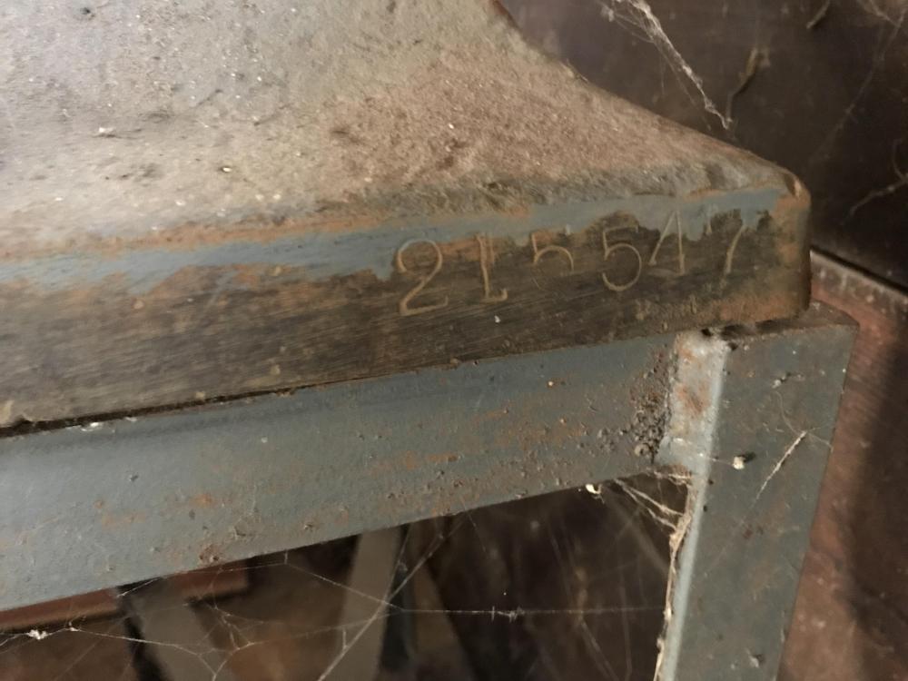

Jeff myers Posted March 26, 2019 Share Posted March 26, 2019 I have an old trenton 200 lb anvil ser#215547. Can anyone tell me how old it is? Or is it a good one to start out with? Link to comment Share on other sites More sharing options...
Irondragon Forge ClayWorks Posted March 26, 2019 Share Posted March 26, 2019 It's a great one to start out with and taken care of it will outlast you. I hope you have read about not grinding, milling or welding on the hardened face. Someone with a copy of AIA will undoubtedly be along to give you a date range. BTW... Welcome to IFI. Have you read this yet? READ THIS FIRST it will help you get the best out of the forum. Link to comment Share on other sites More sharing options...
Frosty Posted March 26, 2019 Share Posted March 26, 2019 Welcome aboard Jeff, glad to have you. If you'll put your general location in the header you might be surprised how many members live within visiting distance. Yeah, a 200 lb. Trenton is a fine anvil to get started with and heck leave to your Grandkids when you retire. It's a fine size and appears to be in excellent, almost mint condition. You'll want to build it a better stand, the jogs in the legs on that one will reduce it's effectiveness. You want it as solidly connected to the ground as possible. I highly recommend you remove the oil bottles BEFORE you lay yellow hot steel in it. How'd you luck into that beauty? She looks brand new that might even be the original paint. Frosty The Lucky. Link to comment Share on other sites More sharing options...
Irondragon Forge ClayWorks Posted March 26, 2019 Share Posted March 26, 2019 The paint reminds me of Navy grey. Link to comment Share on other sites More sharing options...
Jeff myers Posted March 26, 2019 Author Share Posted March 26, 2019 The paint was a question. I see a lot of anvils on line look like a cast iron skillet. Is this a good option to make an anvil look nicer? Link to comment Share on other sites More sharing options...
Daswulf Posted March 26, 2019 Share Posted March 26, 2019 Very nice looking Trenton from what I can see. It's your anvil,but I think the old paint is fine. Link to comment Share on other sites More sharing options...
ThomasPowers Posted March 26, 2019 Share Posted March 26, 2019 Look Nicer is a subjective judgement. I prefer an anvil to show it's history over the wire brushed and BLO look myself. I don't recall ever gussying up an anvil in that manner. I would rather spend the time becoming a better smith than having prettier anvils! Link to comment Share on other sites More sharing options...
Frosty Posted March 26, 2019 Share Posted March 26, 2019 Unless you're going to use it for an ornament attractive doesn't mean diddly, it's a TOOL use it. The whole thing about blacksmith tools need to be bare metal is urban myth. Most tool manufacturers painted their products and would happily paint them any color you wanted to pay for. Champion was most often painted black but red was common. I can't recall which manufacturer painted their blacksmithing tools green. A customer oh say the US Navy specified battle ship gray and they bought enough they didn't pay extra. Neither did Sears. Manufacturers happily stamped company or vendor names and logos on tools. You don't think Sears made Craftsman do you? It's your anvil to do with what you wish and I'll defend your right. Stripping the paint just isn't going to make it a better tool. Frosty The Lucky. Link to comment Share on other sites More sharing options...
Jeff myers Posted March 26, 2019 Author Share Posted March 26, 2019 Thank you for all your input. I agree leave the gray lady gray. I’m looking forward to using it to play with making knifes and other beginner stuff. Before that it was in my horse barn and my farrier used it when he came to shoe the hay burners. I almost sold it once or twice. Link to comment Share on other sites More sharing options...
Irondragon Forge ClayWorks Posted March 26, 2019 Share Posted March 26, 2019 I believe your Trenton may have been a Navy anvil at one time. I'm surprised that someone with a copy of AIA hasn't dated it yet. I found another thread that a Trenton ser# 217515 was dated to 1947-1948 so yours is earlier than that probably around 1945 or so. https://www.iforgeiron.com/topic/46237-trenton-anvil-looking-for-mfg-date/ Link to comment Share on other sites More sharing options...
Jeff myers Posted March 26, 2019 Author Share Posted March 26, 2019 Thanks for that info Iron Dragon. That’s what I thought Early 1940s. My late father was in the Navy during World War II. I didn’t get the anvil from him but he was one hell of a machinist. I quest I better get to work building a history wth this anvil. Link to comment Share on other sites More sharing options...
