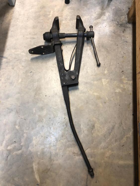

Straighten bent post vice leg?
Hi all,
I'm brand new,  in the process of just setting up my workshop, and was lucky enough to  come across this post vice locally for a great price.    Jaws, screw and nut are all in really good condition but the seller informed me his dad at some point backed the car into it.
My question is:   Should I, and any advice how to go about straightening this out?   I realize the answer might just be heat it up and straighten it.   However wanted to seek some guidance to make sure I wouldn't need to temper it somehow that is beyond my experience at this point.
and I just found the advice to use "google" and not the search bar.  Found the prior topic now.   sorry guys..
Thanks for the reply.
heat the metal to red/orange heat and straighten it with a wood mallet on a wood anvil.
Low Carbon and so heat treat is not an issue!   Classic Colombian postvise made in Cleveland OH. Pretty young too.
