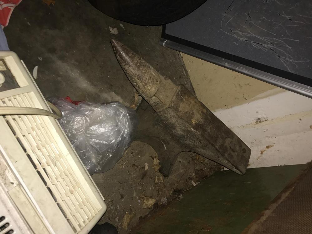

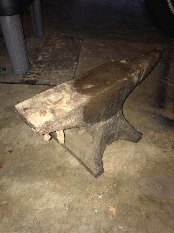

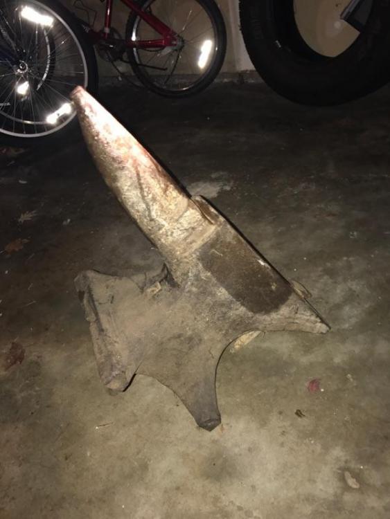

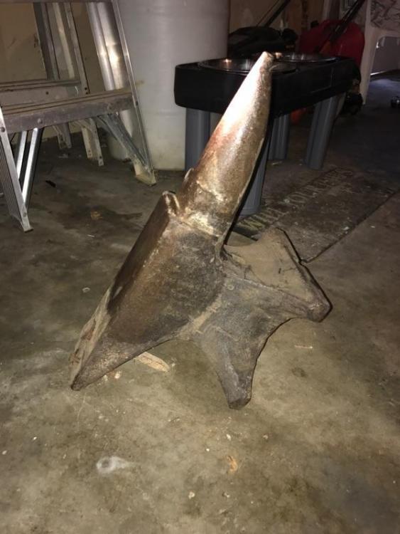

I recently decided that I wanted to learn blacksmithing and started looking for classes in my area. After mentioning this to my mother, she reminded me of a family heirloom that's sitting in her garage. The only thing we know for sure is that it was her grandfather's anvil that was on his farm. I remember sitting on it when I was kid in my grandfather's shop. She took some pictures of it (not very good ones) and I thought I'd post it to see what you all can make of it. I'm going to have it shipped over so I can clean it up and put it to use. She lives on the other side of the country.

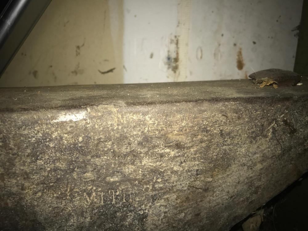

I couldn't make out what the markings were and thought I'd better show some people that actually know anvils!
Any ideas? Thanks!

Your anvil looks to be in very good shape and only needs a wire brushing to clean it up and hot steel hammered on it to shine the face. I hope you have read about not doing any grinding, milling or welding on the hardened face. Wire brushing with an angle grinder may bring out better markings. I'm sure those who have more experience with anvils will chime in but as it stands we can only guess.

Once I saw the word "SMITH" something, there was no going back. Now that's all I see. I looked up names of anvil makers of old and didn't see anything with smith.
My tentative guess is that it's a Peter Wright. I think I see flats on the feet, the general proportions seem right, and the font of the stamped text looks just like the text on Peter Wright anvils.
I'm definitely not certain though, since it sure doesn't look the text says anything that is on a Peter Wright.
EDIT: Disregard. Thomas Powers identified it.
I don't know where you looked it up because on page 75 of Anvils in America (*the* resource for anvil info in the USA) there are two smith brands listed One is Smiths and the other is Smith & O'Leary and mentions that Smith & O'Leary used to rebuild anvils made by other manufacturers and restamp them.

Well, my brother just told me that it says Switzerland on it.
You have a very nice anvil there.  Smith and O'Leary were out of Chicago and like TP said they rebuilt anvils made by others.

Weight code stamp looks like {1 , 1 , 0} to me. (though the 0 could easily be a 6 or an 8) If it is a 0, the anvil would be 140lbs.
