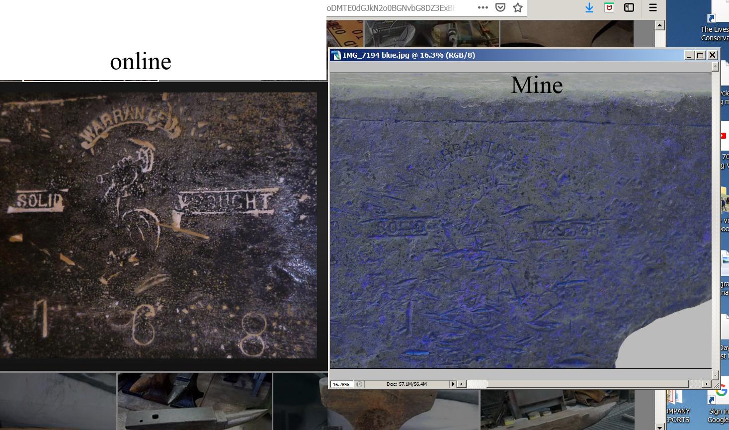

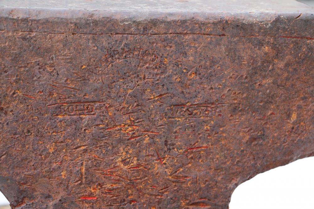

I have an old anvil, although its embedded in a short barrel of concrete.  I'm trying to find out if someone knows anything more about it?   I can't find a name on it or make out the makers mark, but I did take a bunch of photographs.  The mark on it is hard to distinguish, I found one very much like it on the internet looking at other anvil images.  (In one of my photos I played around with the color and contrast using Photoshop because sometimes markings and details show up better in another color, or with more/less color saturation.)
If you look closely, at the top shows "Warranted" and just below that you can see an arm with a hammer on it.  It's not like the arm/hammer that is on an Arm and Hammer Anvil.   I have the one photo that shows my anvil markings alongside the one I found on the internet.  The internet photo is clearer, but it looks very much just like mine, can't find a name.

Welcome to the forum!
Yes, it look like an Arm and Hammer anvil. Looks like the weight is 152lb to me, but the numbers are pretty faint, so I could be wrong.
Have you read about not grinding or milling the face of anvils?
Arm and Hammer, made in Columbus Ohio by the Columbus Anvil and Forging  Company.  Considered a top grade anvil.  The book "Anvils in America" by Richard Postman  has 25 pages of information on them including a list of serial numbers correlated to dates.  (SN on the front of the foot under the horn)
So Arm and Hammer had different styles of arm/hammer marks??  Curious because the arm/hammer etching doesn't look like the ones I've seen.  The Arm and Hammer's looked more defined or robust might be the word.  I will have to get some help turning this anvil over to find that SN.  Excited to find out more, it was my husbands and he never got around to researching it.
First do not confuse the Arm and Hammer logo used by Vulcan anvils that is cast proud of the surface of the side of their anvils.
The Arm and Hammer anvils' Arm & Hammer is stamped into the side of the anvil and depending on how well it was stamped it can be faint or partial or well done.
(Note that I consider Vulcan anvils as a bottom tier anvil so a wide difference between the two brands!)
Neither type is etched.
Arm and Hammer anvils often still show the undulations on the bottom side of the heel from the blows of the steam hammer it was forged with.
Oak, yours is the second style of logo stamp A&H used in production.
They used several different styles of stamps through their history.  Please post a picture of the serial number on the front foot under the horn.

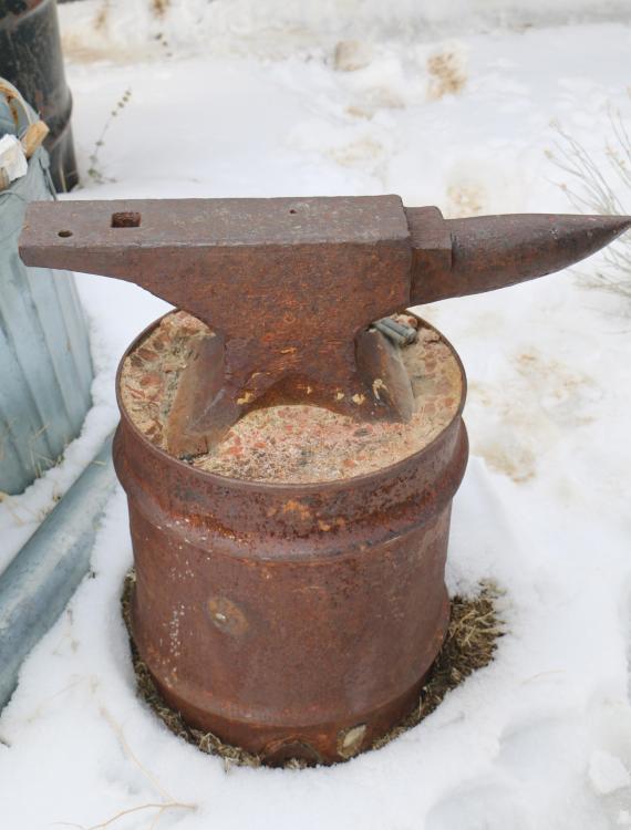

Had some help today, no numbers on the front foot under the horn, we looked really close, lots of rust, maybe it corroded off?  The only numbers we could ascertain were a 1 3 2 on the side (or could be 152), below the words Solid Wrought and the arm/hammer.  In my first photo if you look closely you can make out numbers in the bottom 1/3 of the photo, my help today thought it was 1 3 2, but looking now could be 152.  Are these fairly valuable, I want to put a price on it as my neighbor is very interested.
The number stamping is the weight. Put it on the bathroom scale and see what it is. (Note may be a couple of pounds off: old weight/modern weight)
Can't suggest a price range without knowing LOCATION: Anvils where I live now are at least a dollar a pound higher than anvils where I used to live and BOTH places are in the USA!  Which of the 150 countries that participate here on the World Wide Web you and it are in we don't know. (Anvils are cheaper in the UK and more expensive in Australia for instance...)

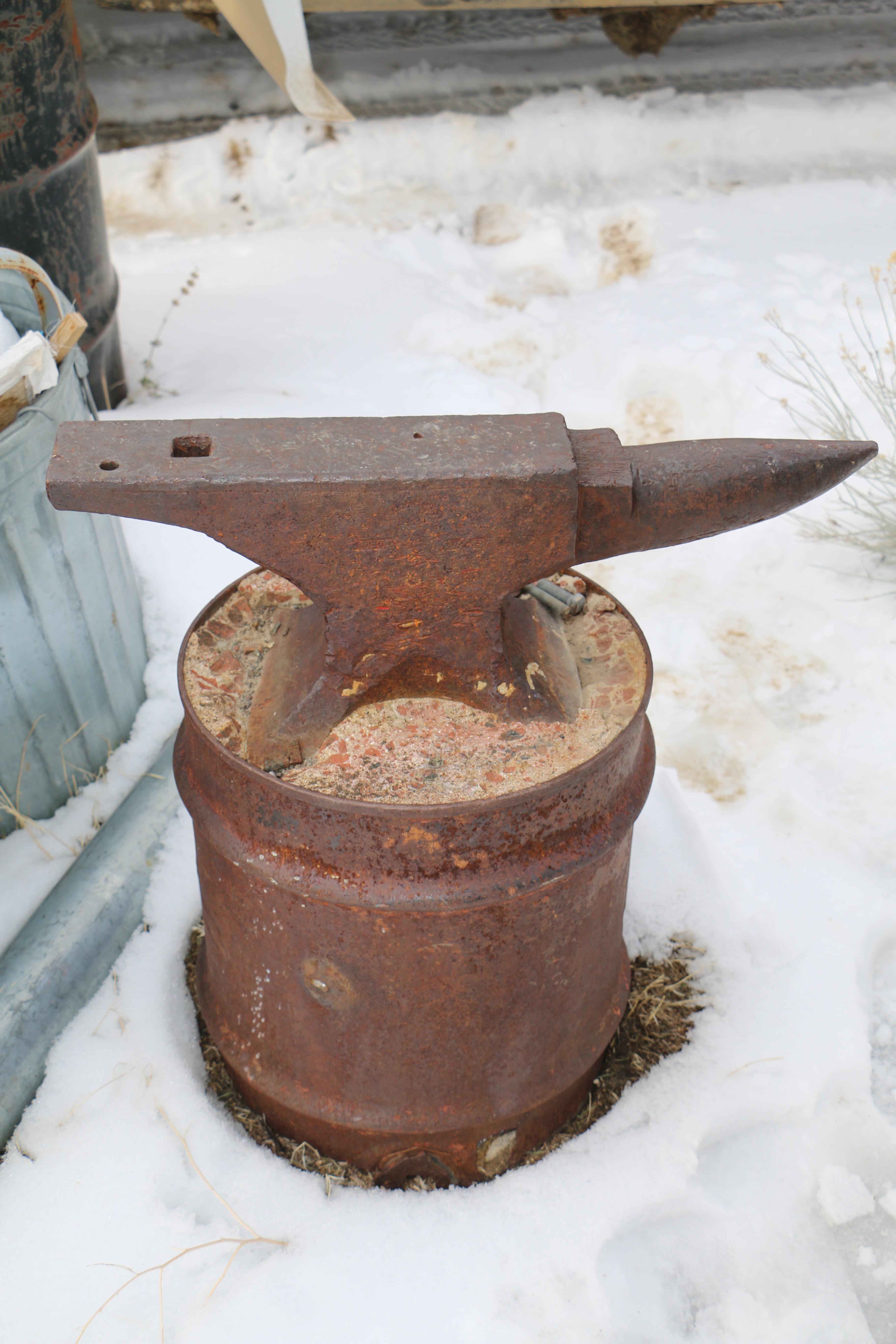

No way to put it on a scale as it is embedded in concrete in a metal drum, as shown in photo.   Anvil is in Southern California, 2 hours north of Los Angeles, west of the town of Mojave.  I thought about trying to chip away the concrete but do not want to risk damaging the anvil.
OK you are in the higher price area. However having that anvil embedded in concrete will cut down on the number of people who would buy it due to difficulty in moving it!  Not to mention: what are the chances that it will be at the exact correct height for the person buying it!
Wire brushing the rust off and waxing or coating with BLO will give it more "curb appeal" too.  NO GRINDING! NO MILLING! NO WELDING!
As anvil prices are generally given in dollars per pound; You need to figure out the stamping or weigh it. Taking a star drill and breaking up the concrete next to the anvil's base should not damage it.
US$3-6 a pound is probably a range in your area. What did the California Blacksmiths Association, an ABANA Affiliate; suggest?  They should know local prices  better and might be a source of possible buyers.  Since it is most likely under US$1000  it's not very valuable compared to silver or gold.

Ask a contractor or a Concrete batch plant, How much does a yard of concrete weigh. Use Pi/R2 X height of barrel, to figure out the volume of the pail. If the pail is 1/4 of a yard, do the math. You will be within a few pounds of actual weight. Weigh the total weight and subtract the pail weight. If it matters that much. If the height of the Anvil is close for your height, leave it in the 'Crete'. The Anvil would probably enjoy a good massage with a prickly wheel on an angle grinder. Give it a name and christen it by using it/her/him. You could fasten a 'Cow Bell' under it's neck, to keep it talkin' to you. LOL Ting Ting Ting!!
