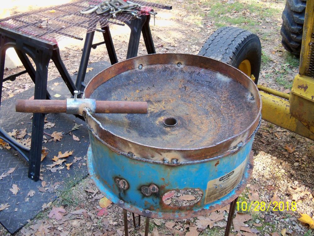

I was given this today to try and refurbish into a new coal forge. Any suggestions? The "floor" of it is completely flat. Its all 1/4 steel and about 30 inches wide. Thanks for any help.
A little shallow for a side-blast, but it could be made to work. The central pedestal would get in the way of a bottom-blast tuyere.
It certainly has potential to be a forge.
The center pedestal can easily be worked around by just offsetting the bottom tuyere hole.  Could drop a brake rotor in the bottom for a fire pot and notch two opposing sides for a pass through for longer stock, No problem.
Or it could just get a redesign for legs,  and utilize that pipe and make a T pipe out of it. It's all in what you want it to be.
How deepis it? With the solid bottom 6” is deal enugh for a side blast. Not to say one can’t sculp adobe to raise things
Not a bottom blast fan one could be fabricated
Im still pretty new to most of this and never considered a side blast. How does that work exactly? Do i just pipe my air into the side and build up my coal on it, or do i need to purchase fire bricks to build up around it? Thanks for the replys.
You need something to build a fire pot out of. Clay, fire bricks, dirt etc. then the air is fed into it from the side. The pinned/sticky threads at the top of this section will help with understanding how a side blast works. The picture I posted shows one under construction but many have been made without needing a welder. This sticky is a good one about the basics.
