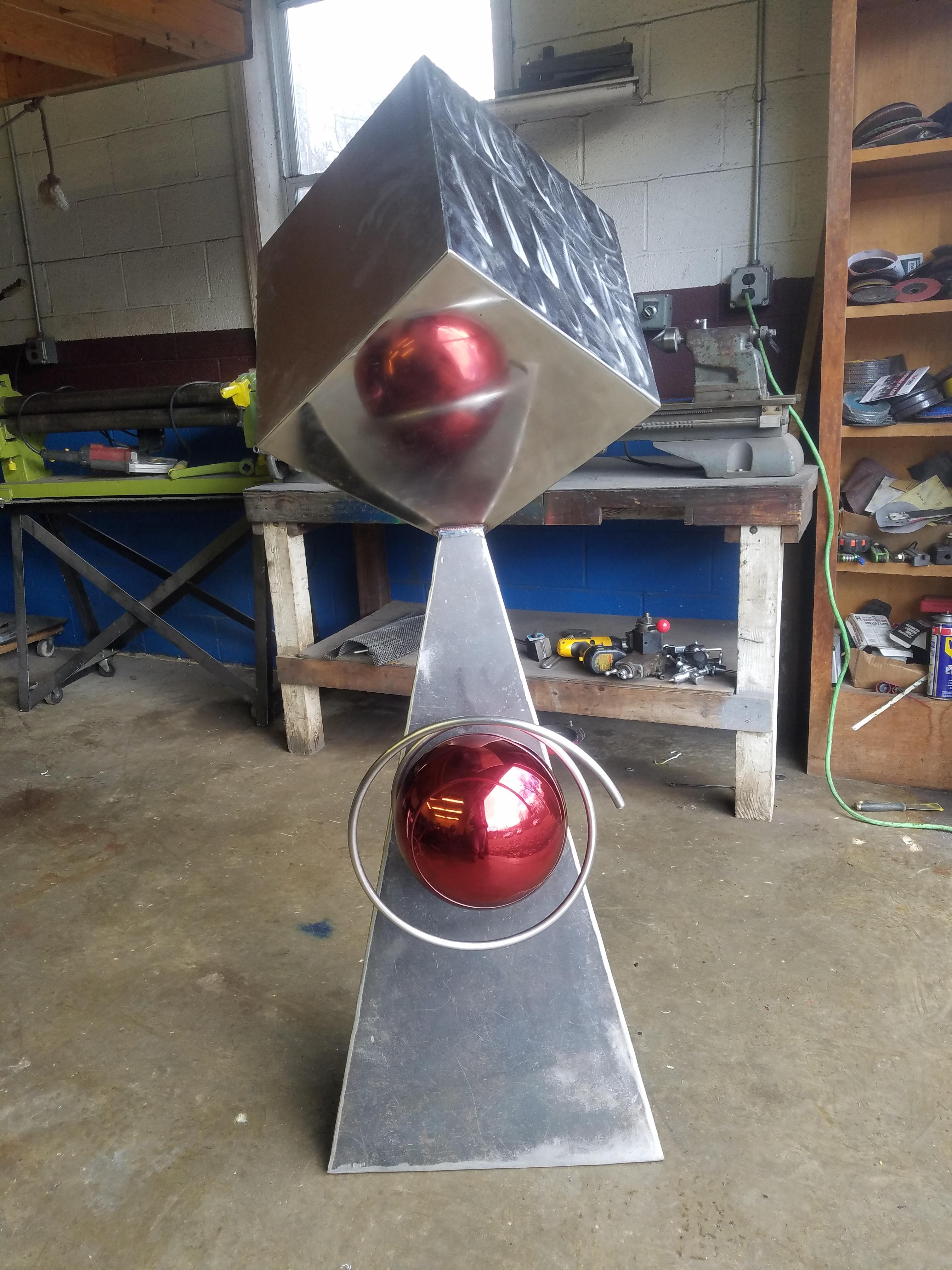

There is no forging involved but here is an art piece I am working on. I typically make ideas that pop in my head and then end up entering them in art shows or competitions. We will see what happens with this one.
From concept to partly finished. I still have to add one element and hours of sanding, polishing and painting.
The cube and ball are stainless. The triangle is mild steel and will be painted.

I did a bit more work on this sculpture. I am trying to decide if I want to paint the mild steel pyramid a gloss black or be lazy and let it rust. If you think a different color would be better, let me know.
I tried to polish two sides of the stainless steel cube and put different patterns on the other sides.
The coil thing is also stainless steel.

The cube was from a piece of scrap I received in trade several years ago. It had some pretty good scratches on it and I made a few mistakes sanding the edges and ended up with some good scratches in those areas.
I was using a few different tools and abrasives. I have a Metabo variable speed burnisher, Metabo variable speed grinder, 5" DA electric sander, 1/4 sheet palm sander and the 3M roloc pads. I think I went to 600 or 1000 grit with the palm sander. I also used the Rex-cut 3 step polishing system with combi-flap disc, unitized disc and polishing disc.
Even with those tools, I was spending a lot of time trying to get the scratches out, make it flat and shine it up as best I could before I welded it to the base. I intend on going over the polished areas again once I decide on the finish for the pyramid.

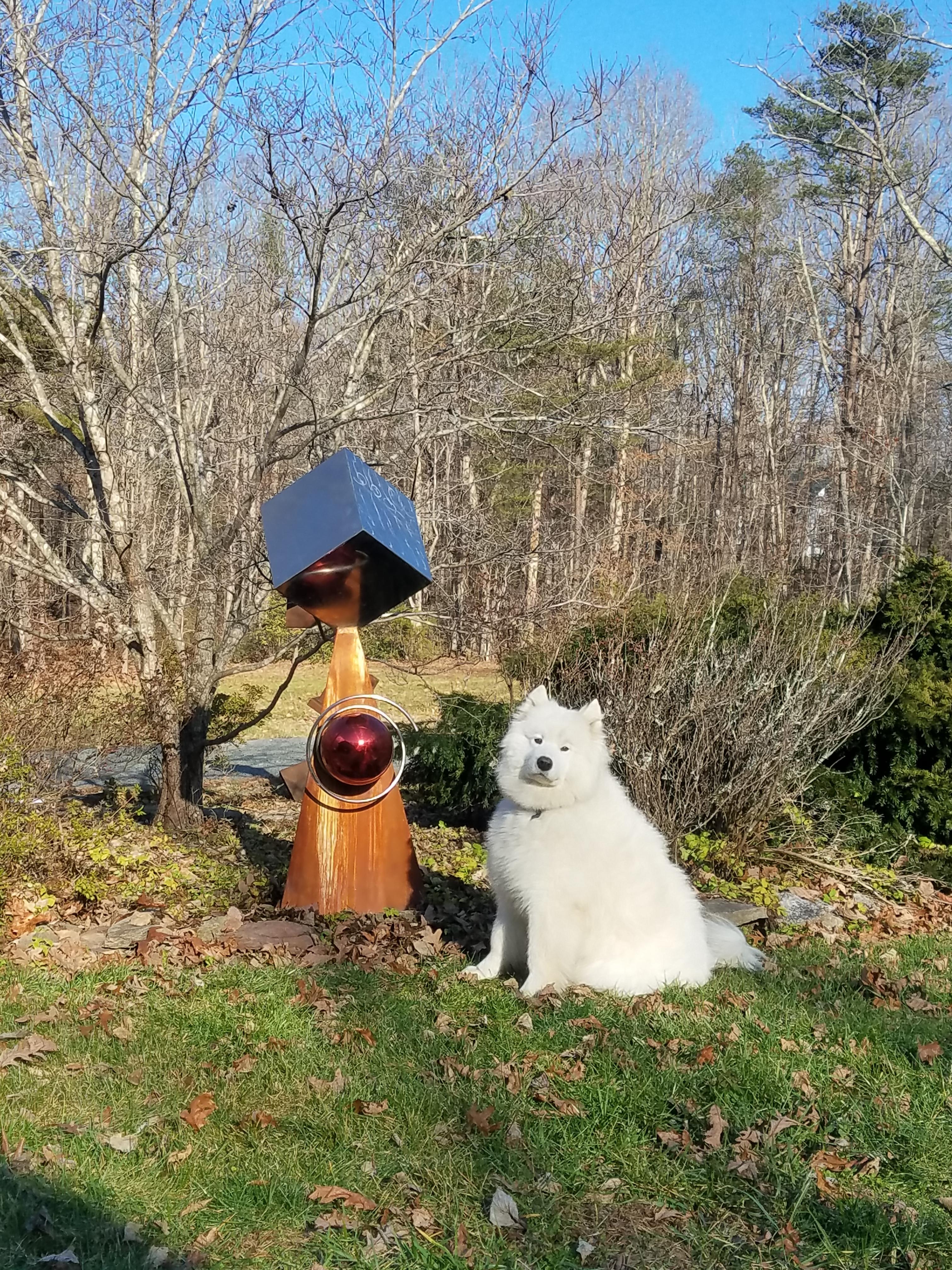

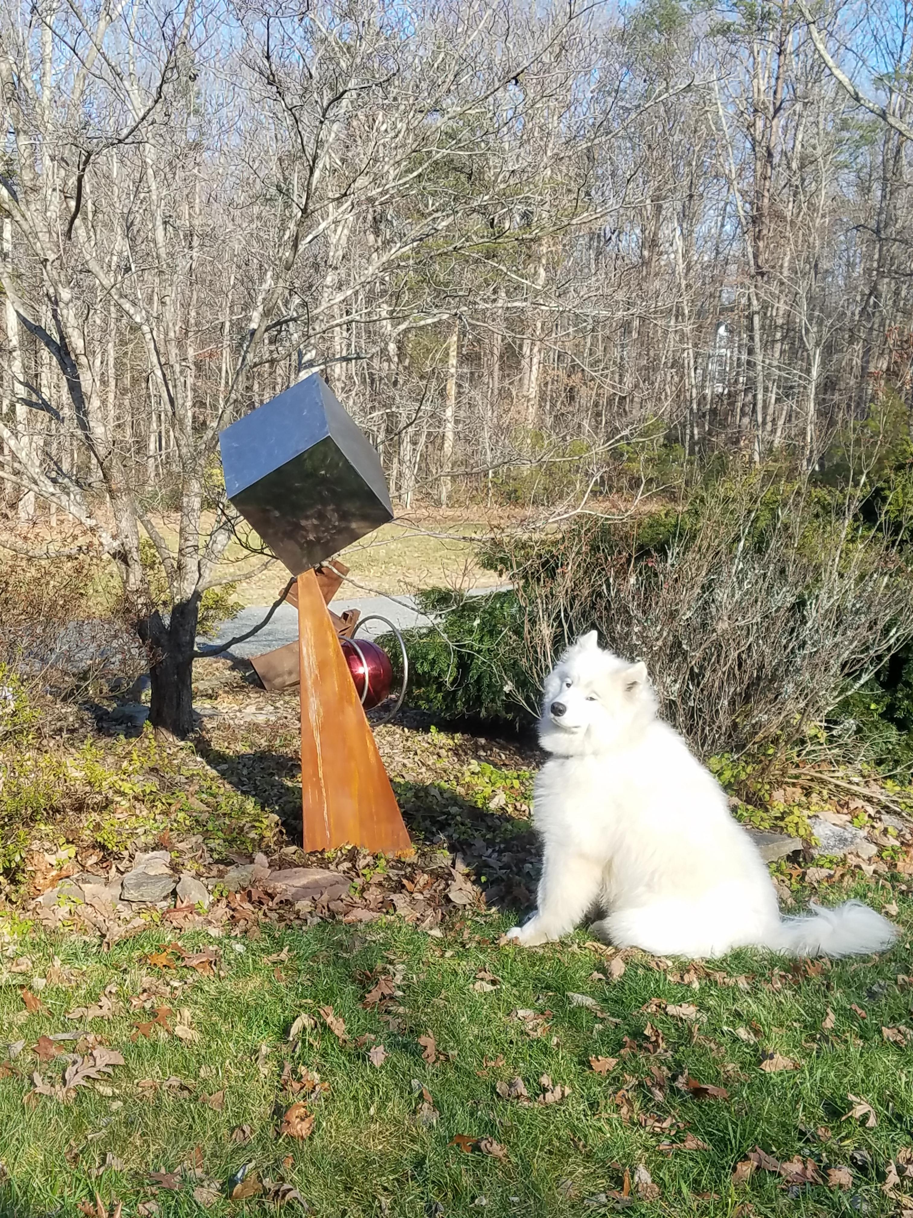

I decided to acid wash the mild steel and let the pyramid rust.
I still need to polish it again,  but I like it so far.
I have to tease a bit, did the dog to the acid washing like it was a fire hydrant?
Ok, joking aside. Beautiful pup.  I think black on the pyramid might have been better in my vision but it's yours. I still think its cool.
Thanks. My little buddy always a good model.

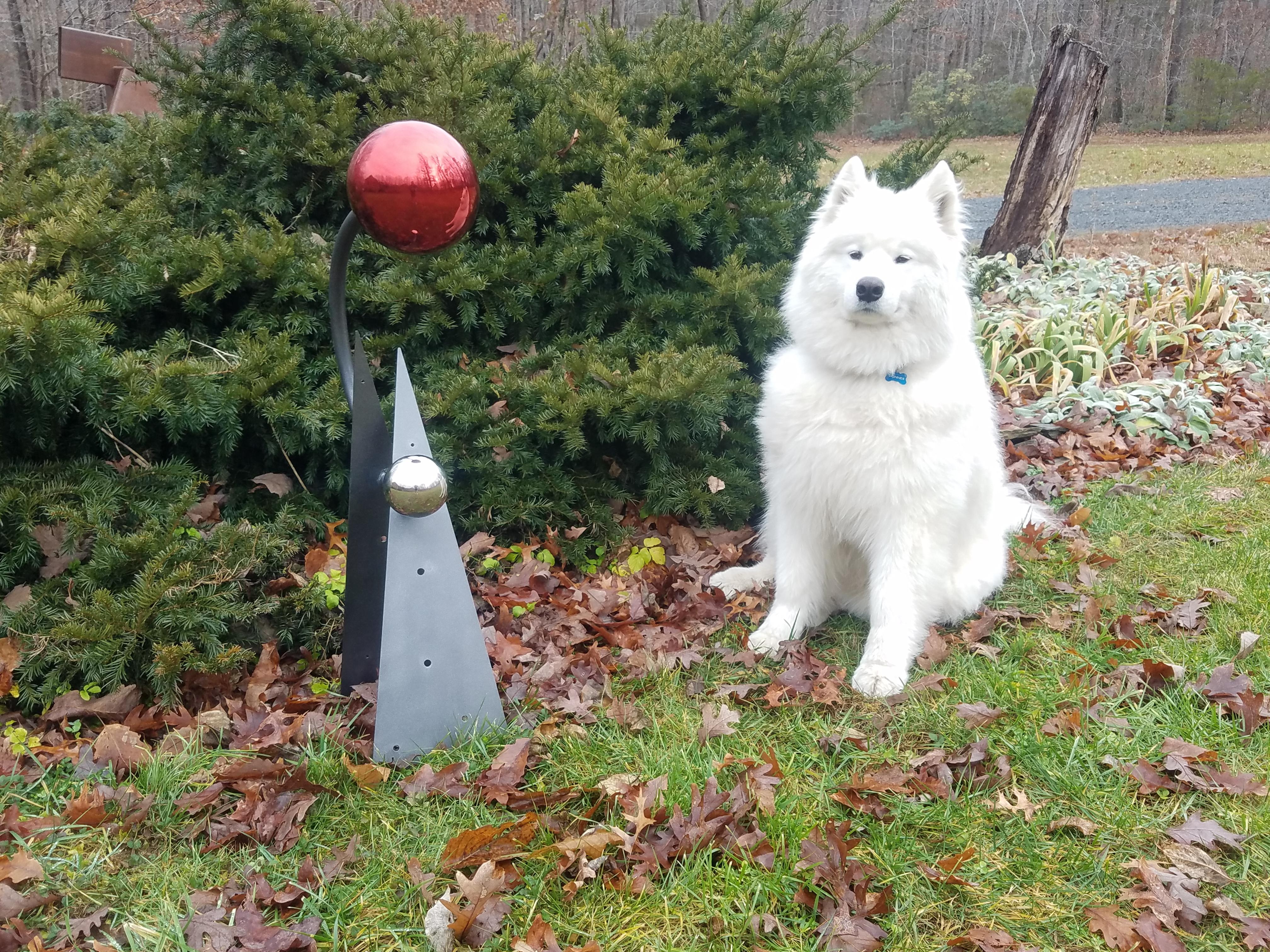

When I first drew it out I was going to use gloss black. In that design, the coil was going in a different direction.
Once I made it this way, trying to mask all those parts off and prime and paint around changed my mind.
Edit: Plus it is a high of 44 degrees or so now, I dont have an indoor paint area, and painting is not my favorite hobby.

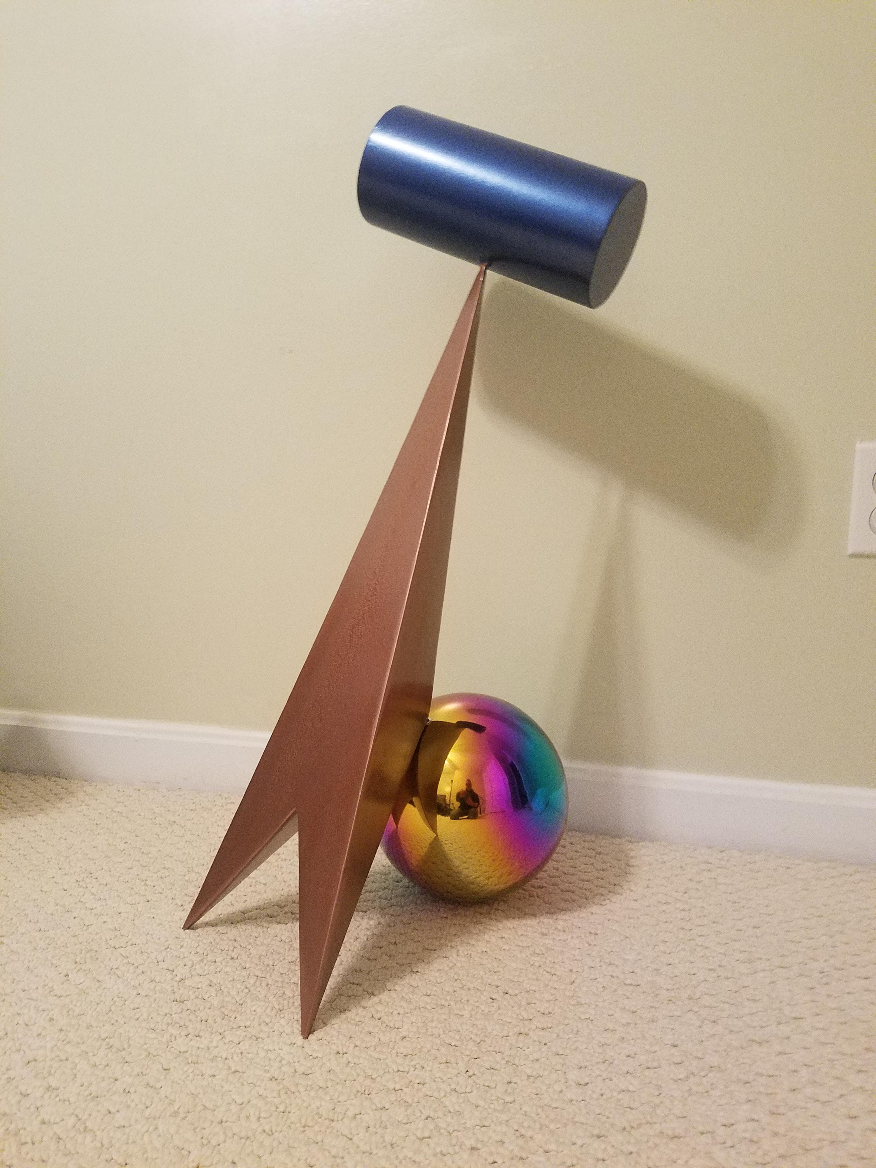

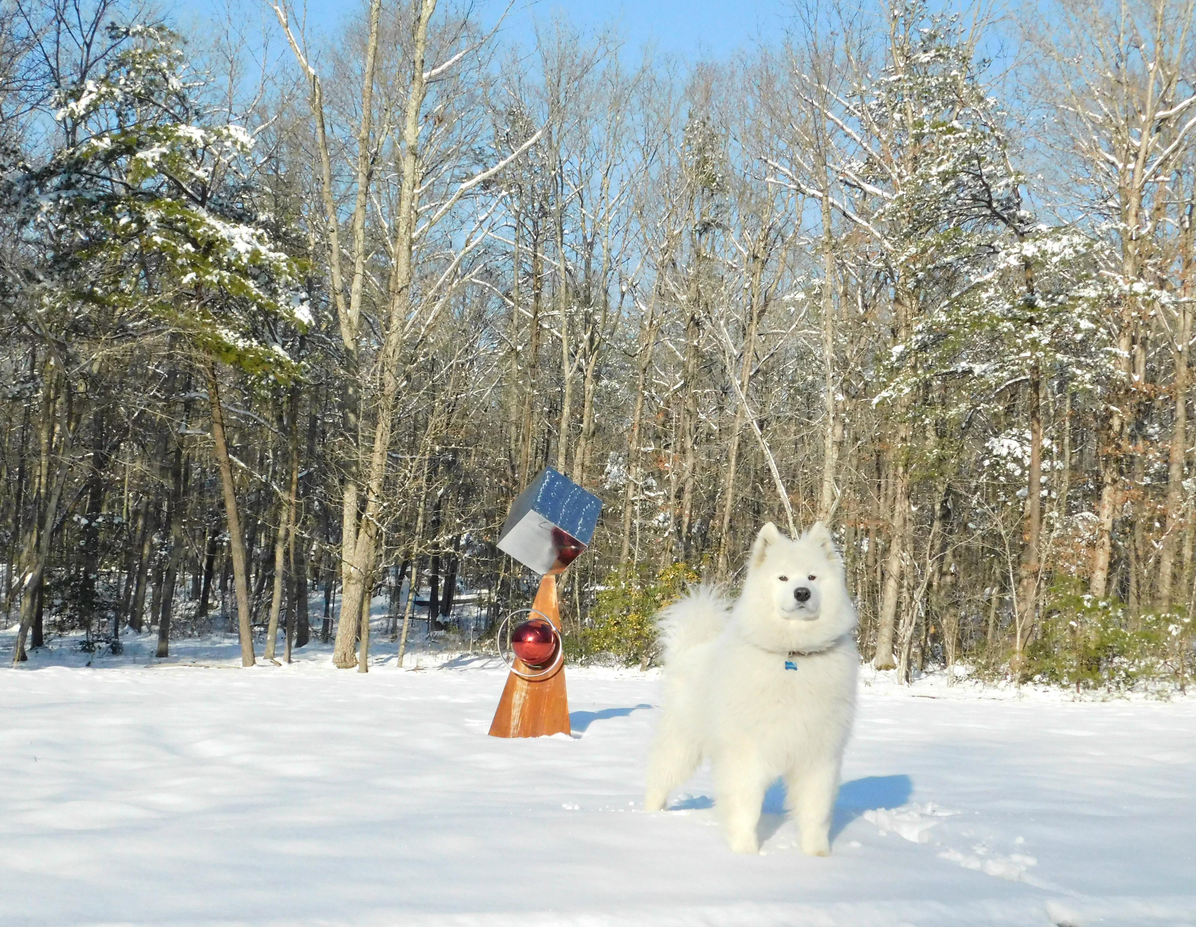

Another one complete in the triangle and sphere series plus I took advantage of the snow to try another pic of the first one.
