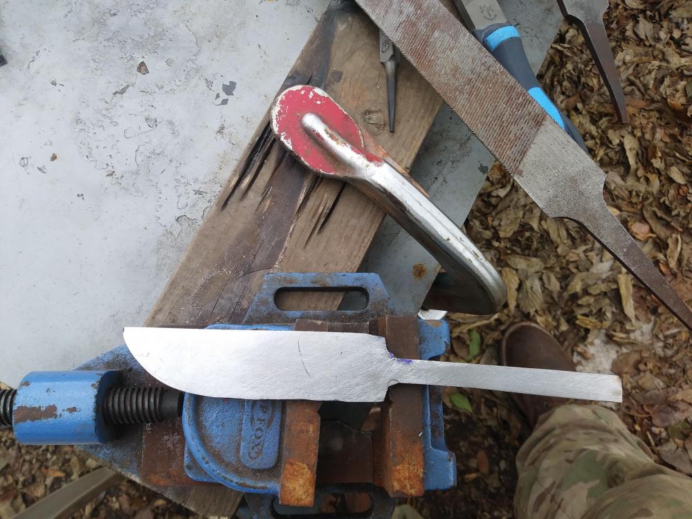

I wanted an over all length of 200mm. 100mm for the handle & 100mm for the blade. Got close. I'm at about 215mm at the moment.

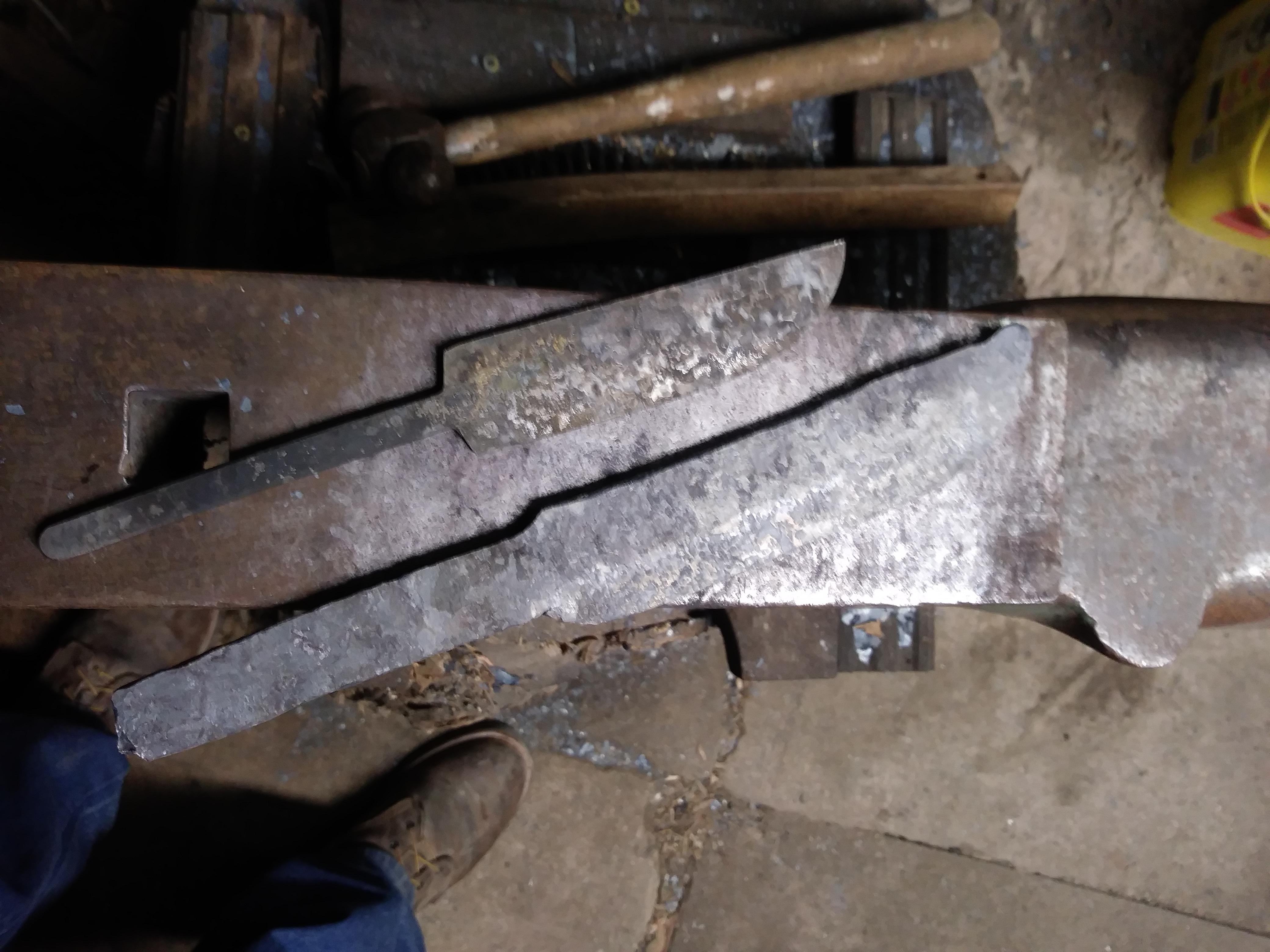

I like heavier & thicker blades. So I am aiming for 7mm thick at the spine. I hammered my material to roughly 10-11mm in thickness. Wanted some slop for filing/grinding.

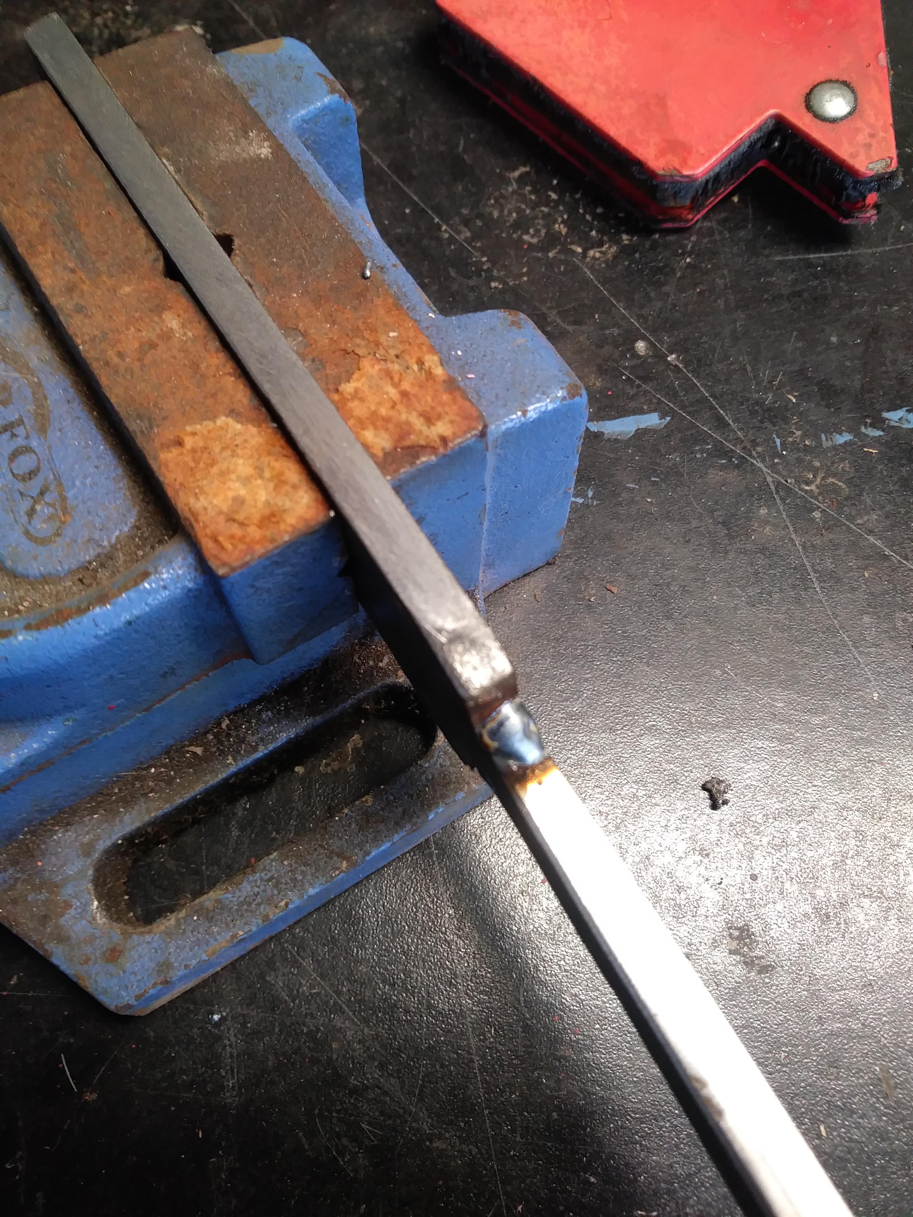

I formed up the tang at the shoulder. I got a bit happy with a hot set trying to isolate the material. Pretty sure I've got a crack there I'll need to deal with. But I've still got plenty to do on the tang .

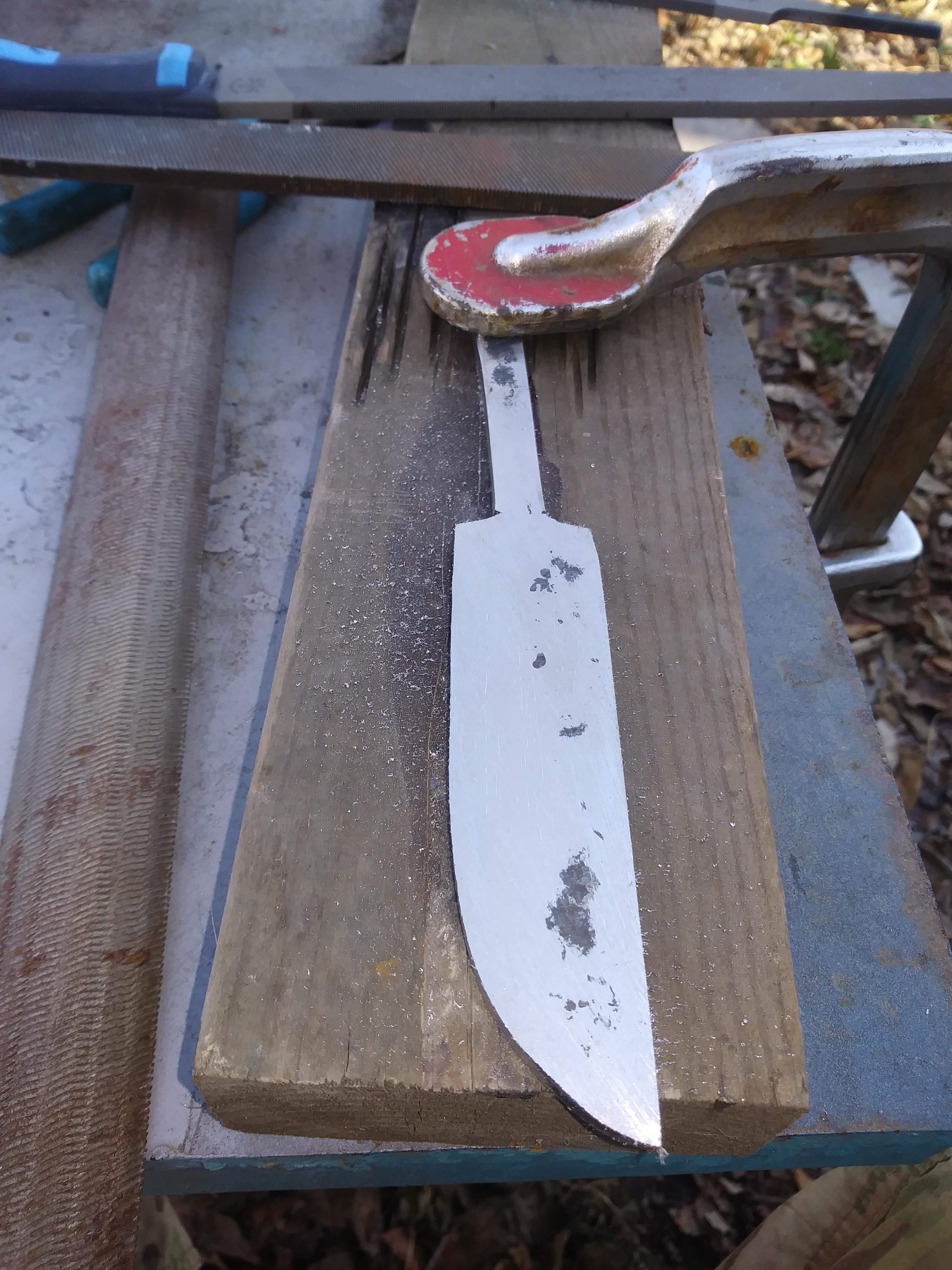

Finally for the day, I filed one side flat. Had some scale on the anvil which I hammered in like a moron. Took some judicious filing to get through it.

Looks like you are on the road.  I really like the blade profile and you show great persistence with the draw filing.  That will serve you well with all your smithing.
Constructive criticism:
  1. Yes you definitely seem to have a problem at the tang junction with a crack.  That is a serious problem that needs to be addressed sooner rather than after you have spent countless hours filing and finishing.  Hard to tell if you have enough material there to save it.  If you don't I'm afraid I have no good advise on repair, I'd start thinking of cutting it down thinner and seeing how small a stick tang you can get away with.
  2. 11 mm thick is really thick for a short blade like this one.  There may be Puukko this thick, but I've never seen one.  Not that there isn't a place for very thick blades, just not sure they should be called Puuko.  With a very thin stick tang this blade is going to be very forward heavy, you might want to consider beveling down the spine as well and leaving a bit of a ridge in the center.  Hard to describe in text, kind of like some of the Japanese tanto  blade crossections.  With the thing stick tang you shouldn't  baton or pry with it in any case.
  3. You might consider saving yourself some filing and forging in some of the bevel the next time.  It is fun and a bit more of a challenge than just stock removal on a forged profile.  You can even forge in distal taper...
  4. To save your files, which will get ruined filing on scale, consider soaking the billet overnight in white vinegar to break down the scale.  If you are in a rush and don't have a belt grinder, you can get rid of scale pretty easily with a 4.5" angle grinder and a 40 grit flap wheel.
@Latticino I agree with you about the tang. I hope I can save it, but if not I'll figure something out. Its a learnable moment either way.

Addressed the tang as well as I could figure out. Filed out my crack on the one side & the gouge on the other side. Then hit it with the welder in each corner. I didn't care to do this as welds are a pain to file through and blend for me. In retrospect, I believe the the better option would have been to not have dorked it up to begin with. Live & learn I reckon.
Due to Latticino's kind mentioning of an angle grinder. I made much faster work of the other side of the blade.
Used a 120 grit pad to take most of the scale most of the way off. Then went the rest of the way with files.
I broke down &  called a truce with the devil grinder. Did a peace dance & sacrificed three chickens so that it wouldn't ask for anymore fingers. I really need to invest in some better belts if I continue doing knives after this. The cheapo belts wear out FAST! Ran a 60 grit belt over it to blend out the file marks & to profile the tang more to my satisfaction.

What about heat treatment?  If done before the mig weld will certainly screw it up.  If still to be done you may want to read up on normalizing cycles.

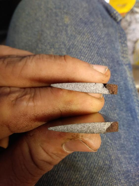

Basically, I accidentally dropped the thing & noticed the crack in the spine. Knew it was DOA & wanted to see the grain. A vise and rubber mallet did the breaking.
I am will keep at it though. Had a lot of fun with this failure. Hammering a blade out is so much more enjoyable to me than straight up stock removal. I'll likely put this one on the was as a "don't do this again" notice.

Here is a knife i had with a crack a while back that I broke is a few places just to check it out. Steel is 52100.
This picture shows 2 grain sizes. The top, blade section near the tip is pretty good, smaller texture.
The bottom is from near the end of the tang.
Everytime I heated it for normalizing, and for the quench, I heated up the tang first. The idea being to let heat travel to blade so I didnt overheat the blade. It ended up getting the tang way too hot, and the grain totally shows it.
Looks like compressed gravel.
