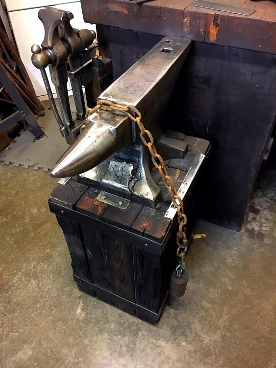

I suppose I don’t know the correct blacksmith term but the use of a chain or item other than a Pritchett hole hold down to work as a third hand while forging.

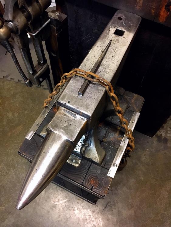

I added this chain secured by a pull pin and weighted on the other end by a 5lbs cylinder.
I also had to add some angle iron to the edges as the chain was chewing up the edges of my anvil stand.
I’m interested in what everyone else uses.

Grumpy, some people use motorcycle, engine timing chain or other similar. (Smaller links to grab different pieces easier.)
Nice job.

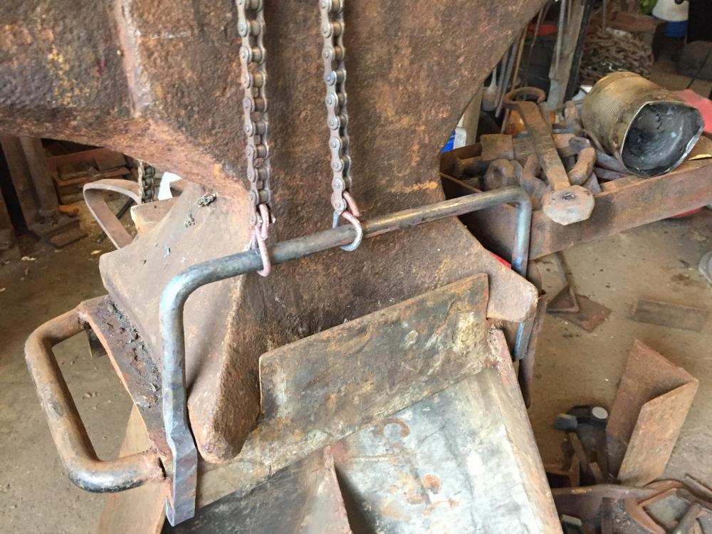

I use a motorcycle chain I picked up from the shoulder of I-90 in Boston. It hooks onto a rail at the back of the anvil stand, so it can be positioned almost anywhere along the length of the anvil. The weight is a bell clapper from a Russian Orthodox monastery in New York State.
(NB: there are two holds-down shown here, but I moved one of them to my adjustable stand.)
