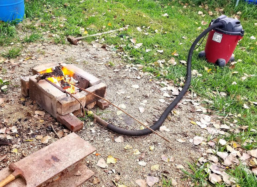

I've always wanted to try blacksmithing but I figured it took a ton of money to buy a forge and get started.  After watching a bunch of youtube videos I decided to try making my own forge.  After researching on this forum I've discovered maybe I should of skipped youtube and started here.
Anyway...I'm not sure what you would call this forge.  I used a couple concrete blocks, some fire bricks, and some cast iron wood stove parts.  I started off with Kingsford since it's all I had handy and I wanted to hurry up and try it out.  Using a shop vac I was actually able to get some rebar hot.
Next I tried some coal.  It was small acorn size pieces...I got it burning and hit the power switch on the shop vac.  It looked like a small volcano...spewing red hot coal 10 feet in the air.  I ran through the rain of red hot coals and shut off the vac.  I think it might be putting out a little too much air.
My little test run and reading on this forum have taught me a few things already:
1. I'm building a JABOD
2. Shop vac is too much air.  I've got a manual mattress pump I'm going to use.
3. Coal stinks.  I'm going to use lump charcoal
4. An I-beam is loud and flexes a lot.  Going to try a sledge hammer head.
5. Getting metal red hot and beating on it with a hammer is a lot of fun!
Think of all the valuable information you have proven to yourself:  What not to use as a blower.  How not to build a forge. What does not make a good anvil.

I think the strong coal smoke was due to my fire skills. Pretty sure I piled too much wet stuff on and made it really smokey. I don't have a good coal source so that's the main reason for wanting to go with charcoal.
I'll do my best to avoid asking questions that are easily answered with a little research and avoid a curmudgeon attack.
I did get a new forge built today. I used the JABOD III and JAPOB designs.  I had a pile of fire bricks and figured I may as well put them to use. Also managed to forge my first useful thing. Got the forge done and thought it would be nice if I had a hook to hang my fire poker from...so I made a hook. Its ugly as sin but it works. I think that's the thing that excites me the most about blacksmithing, being able to make practical things and tools, custom designed for what you want and not having to run to the store to buy some junky Chinese version of what you could build better and cheaper on your own.
I also ditched the rebar I was working with and got some round stock. You guys were right it does work much easier than the rebar.
