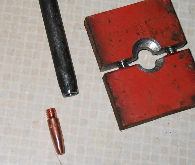

Living in the boondocks, it's often hard/impossible to find some of the plumbing needed to build a gas forge.  After looking unsuccessfully in every hardware/plumbing store in this county for a 1/8" schedule 80 pipe nipple, I settled on a run-of-the-mill schedule 40 nipple.  The .035 mig tip rattled around like a BB in a boxcar inside that nipple, so I made a swaging die to use in my press and squoze the end of that nipple (after cutting off the threaded end) down far enough to thread it with a 1/4 - 28 tap.  Worked like a champ.

Well DONE! That my friend is a proper blacksmitherly solution to a problem. Mike has been known to swage mig tips down to hold needles I don't recall the name of to make his small burners.
