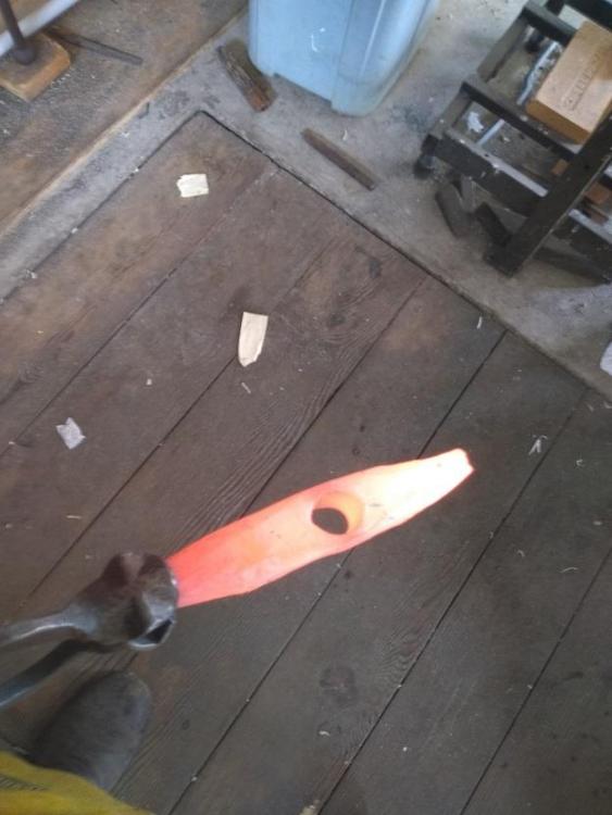

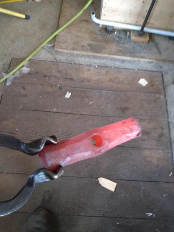

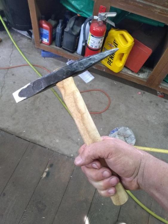

I need a welding slag hammer and since they aren't too big,  thought it would be a good first hammer for me to try.  Have some 1 inch 5160  (or so I'm told) so decided to use a piece of it.  So here is  another tool from the cave man forge.
Looks very nice.  Doesn't it feel good to make your own tools?  I know I get a lot of satisfaction out of it.
Thanks MC.  It does feel good.  now I need to do some welding to put it to use.  I used my new dog head hammer to get it started and found that I quite like the dog head.  Found too that I think I prefer simple slab handles to the more rounded ovals.  seems I can index the hammer better.
Looks like a good first hammer! I know you'll be proud every time you use it.
The beak of it looks a little long compared to most other welding hammers, but I can see where it would come in handy for some welds.
I agree.  once I got to drawing it out, I thought I could just cut it off and make it shorter, but in the end decided to leave it.  :unsure:
Looks good Mike. I found I use a cross pein on the chisel end a LOT more than a straight pein. When I ran into a situation I needed a long pic I used a long punch I ground to a point. However I have a straight chisel chipping hammer in the welding box and use it now and then.
Bearing in mind I'm only talking about what I like which is just a matter of taste. Few things feel as good as using a tool you made with your own hands. It's a good first hammer. Well done.
