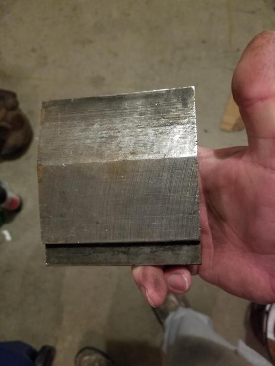

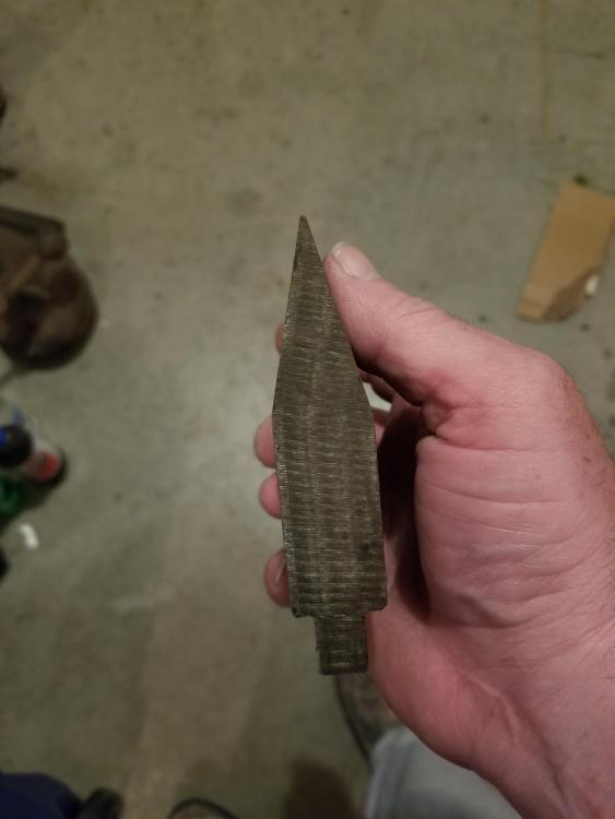

Has anyone ever used a knife die for a hot cut tool?

I'd hope they were made from a decent die steel and so be difficult to work and extremely difficult to heat treat but make a great hardy.
What alloy is the one you are considering using?
It is used for bending sheet metal. This is the upper die and there is a lower one that is v shaped. Different sizes for different thickness.
I have no idea.

         Just a simple suggestion.. Put it in your vise on those nice shoulders as the base and give it a try before you modify them.  I would keep them as is for future tools. ( Fly press)

I'll give it a try and see how it goes. I was thinking if I had to I could weld something on it to hold it in the hardy hole.
Those dies are generally made from 4140, according to a guy I know who works sales for a tool-and-die manufacturer.
4140 is not that exciting as a hardy material. (but is cheap for the manufacturer!)
