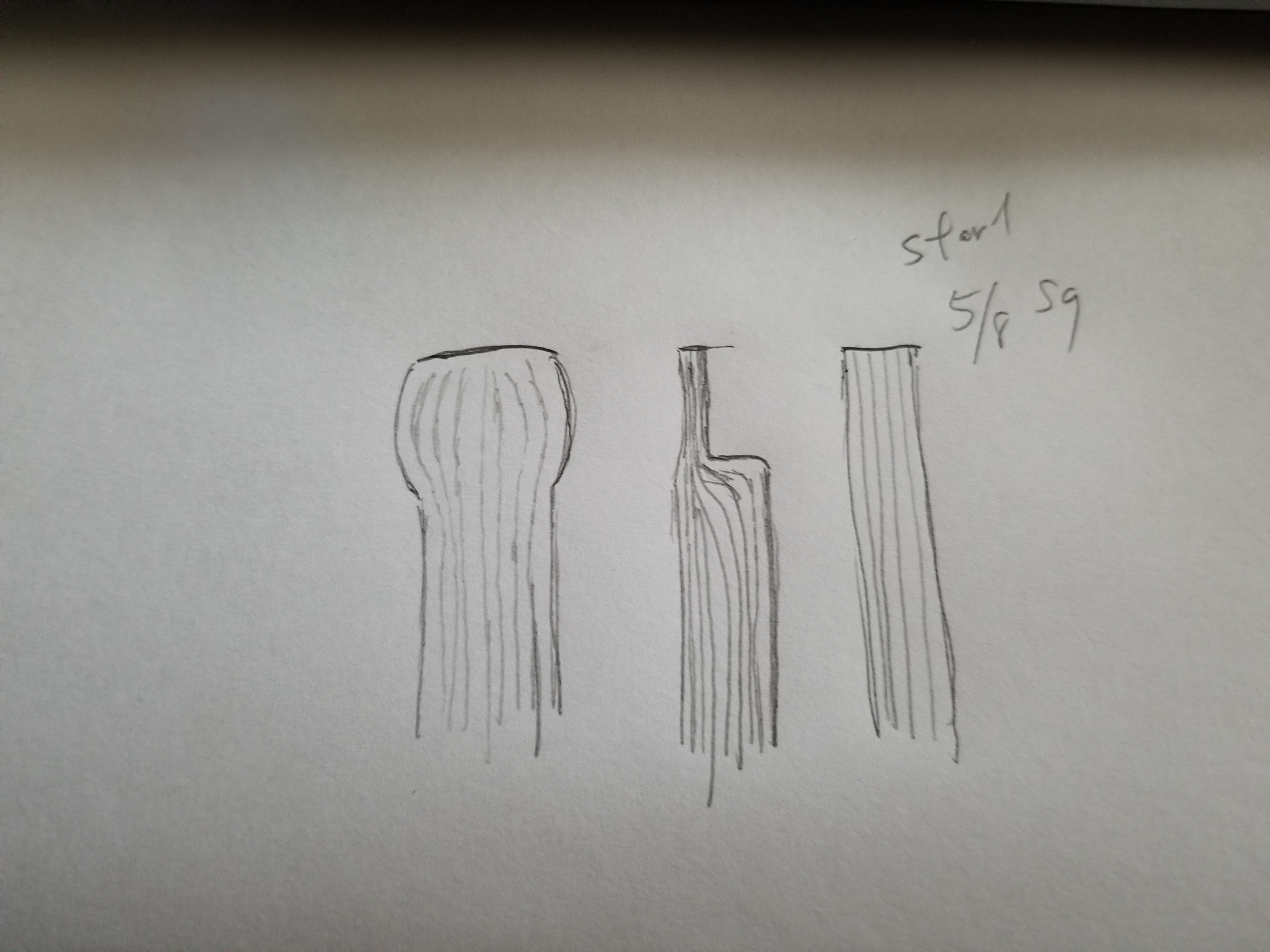

Well, obviously this is a complicated problem with many variables. What I'm trying to do with these drawings is isolate out the extraneous factors and focus solely on one variable at a time.

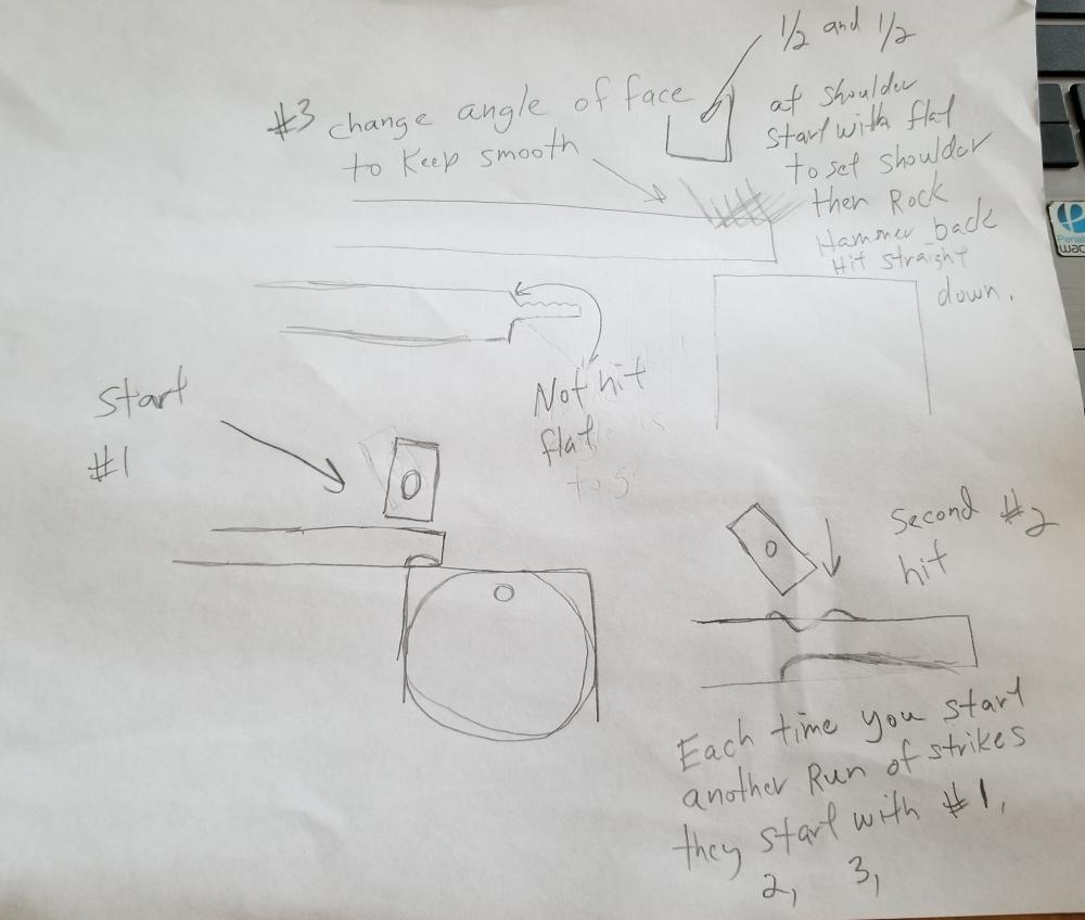

Ok,         A straight on blow will give as in drawing 2..      If you slide the hammer in an arc and hit with a flat face as in drawing 3 you are correct..   I"m having a time flux moment  right now..
The change happens as Frosty pointed out that the PSI going into the metal will be less with #3 as the force is being put in a different direction instead of straight in..
When I reference smearing.. Its not really  a great term..
If you have time..  Take a bar of 5/8" and mark at 1" and forge it down  out flat to about 1/4" or a little less .. Do no corrections for width hit it as flat with the hammer as you can.  Do no corrections at all and forge as flat as you can keeping the shoulder once started against the anvil face so you get as close to a 90 D at the shoulder as you can..  Remember to keep working just the center of the offset over the anvils edge..  Just about like making tongs.. but thinner..
Then look at the side profile and it should look something like this..  incise a light line or 2 with a cold chisel so you can just see it or find some rusty metal, or hot rolled steel sometimes has rolling lines in it,  so you can see how it moved after the forging..   Start at a yellow or white heat..  count out how many hammer strokes it takes to get to this size and shape..

JHCC , this exercise is to set a base line and to create a point that is easy to see and recognize..  Being able to hit even and square can be tough for a lot of people.. They forge great tapers.. But keeping bars straight well not so good.. Diamonds sure.. :) Anyhow, this will setup the base line for what happens next..
The next action is to forge the same item this time using the side face of the hammer..You can angle away or torwards at this point but ideally the hammer should angle the peen back towards you..  You will end up with a narrower result but longer in overall length with the same thickness of metal..  Again to set a base line and to feel what is going on..
This is now starting to look at how metal will moved when directed to do so by using a fullering effect..   Understanding how fullering plays into the process showing the metal will move more in that one direction vs all like in the first example or lesson..
The understanding of how the metal moves for a given shape..   (Shape)  becomes important as there are processes that would need to be done before something else..  Experience plays in here..
