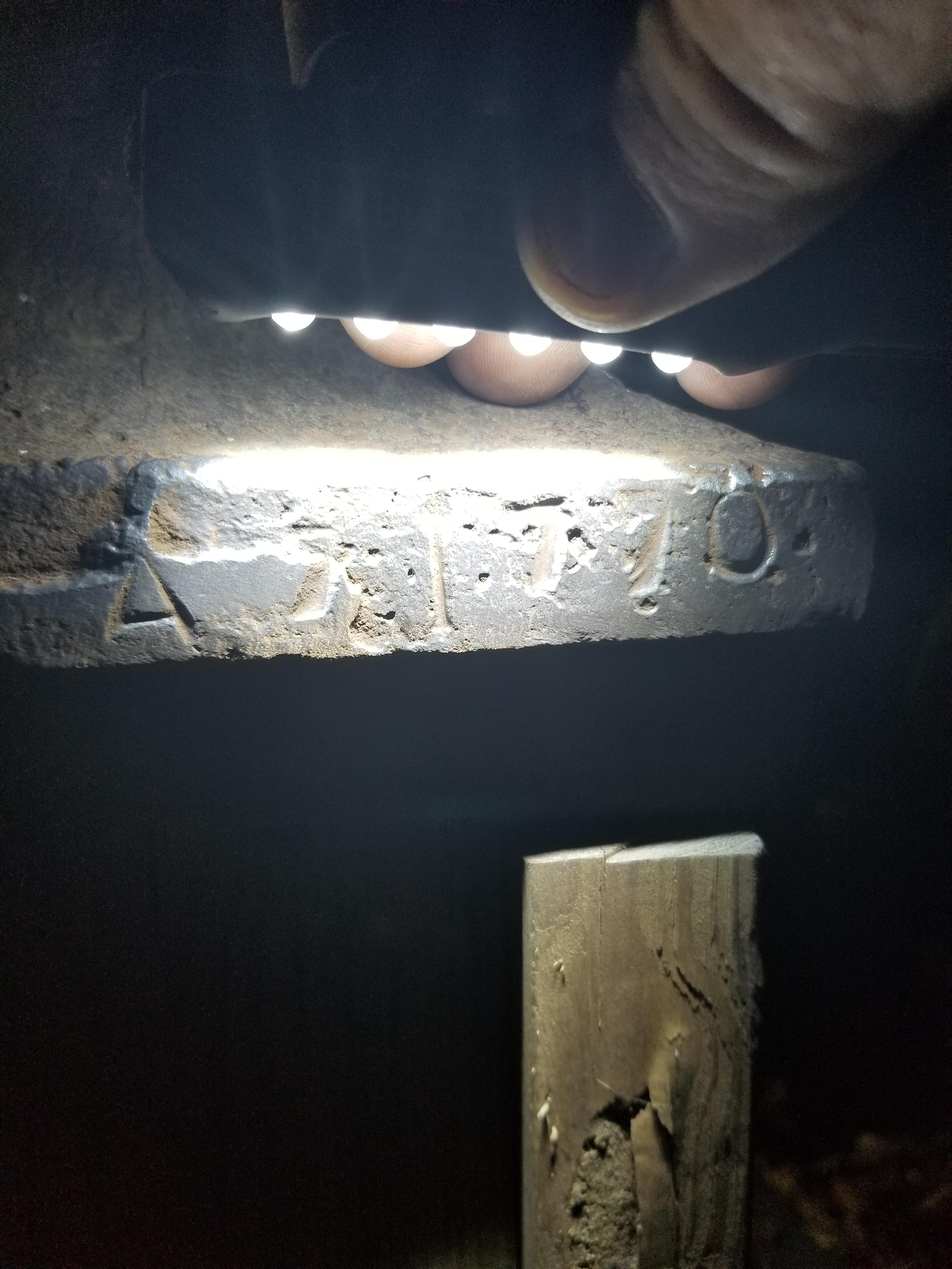

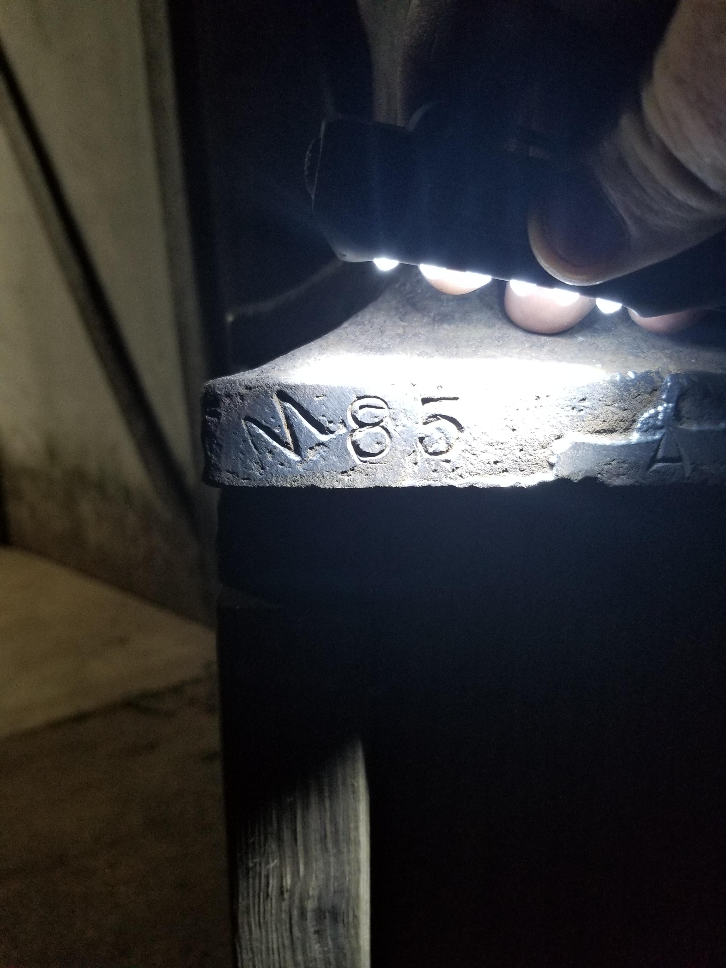

Cowboy03 Posted May 17, 2018 Share Posted May 17, 2018 Newly acquired anvil! Any history/info about it would be helpful! Looking at some other post with serial #s close to mine, I guess it to be about 1907 for a date of manufacture. Maybe in Ohio? Link to comment Share on other sites More sharing options...
Irondragon Forge ClayWorks Posted May 17, 2018 Share Posted May 17, 2018 Looks like you have a nice Trenton there. How is the ring & rebound? What does it weigh? BTW: Welcome to IFI, I always suggest reading this thread to get the best out of the forum. https://www.iforgeiron.com/topic/53873-read-this-first/ Link to comment Share on other sites More sharing options...
Cowboy03 Posted May 17, 2018 Share Posted May 17, 2018 Thanks Irondragon! The weight is 84.5. A beautiful ring to it and rebound is about 80% Not bad for a flea market find in my personal opinion Link to comment Share on other sites More sharing options...
