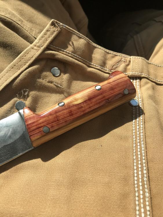

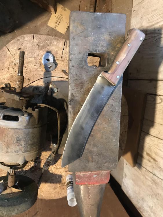

Hunter Copelin Posted March 20, 2018 Share Posted March 20, 2018 Had a friend of mine, whom is much more experienced than myself, warn me about using cedar as a handle. Told me if I didn’t get it treated it would most likely crack or move with the weather. I’ve had the completed knife for a couple months and have used it here or there at work. It’s one of my first completed projects as a new smith and the handle seems to be the best part of it. I actually cut the tree down myself. It had been dead standing for a few years. Oklahoma weather is pretty rough on wood, but this seemed to turn into a pretty decent handle. I’m wondering if In the future as I progress in this craft if I should steer away from it as a handle material. just looking for a second opinion. Thanks, you guys are great! I’ve learned so much from here already as a young smith. i spend as much time reading in this site as I can spare, but there are sssooo many threads and posts I’m sure I’ve missed someone explaining the perfect way to use cedar. I apologize in advance if that’s the case and will continue to read! Quote Link to comment Share on other sites More sharing options...
MastaStan Posted March 20, 2018 Share Posted March 20, 2018 I'm not experienced with cedar, (I have seen it on knife and gun handles) but i would say that if you are worried about it cracking (or any other wood) to look into stabilizing it with resin. There are hardeners that require a vacuum to penetrate deep into the wood, and I believe there are hardeners that you can leave the handle in after fitting. I don't think a simple set up for doing this would be tremendously expensive if you were serious about doing it a lot (look online for diy). Or another option would be to outsource the stabilization. Or buy choice wood pre stabilized.... However if your handle stands the test of time, I wouldn't worry about it unless is particularly soft, spalted, cracked etc.. Type in cedar handle online and see what others are doing/saying about it. I'm no expert but this would be my thoughts if I had doubts about a handle. Hope this helps. Nice looking handle BTW, looks good polished up! Quote Link to comment Share on other sites More sharing options...
4elements Posted March 20, 2018 Share Posted March 20, 2018 Hi Hunter, I was born and raised in Oklahoma and have used that wood a little, but note that there are several trees that are called cedar. What you have is actually juniper and i expect it would do fine with proper treatment as was suggested. True cedar like the western red cedar we have here in washington state where I now live, is much softer as is the eastern cedar from Maine. Those I wouldn't use. Quote Link to comment Share on other sites More sharing options...
