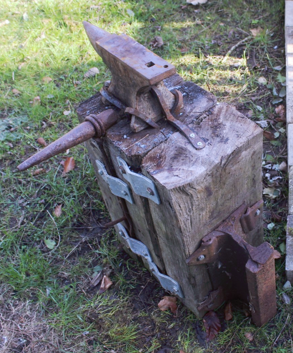

I got my anvil about a week ago and got the cut offs for free from a local tree surgeon and was wondering what was the best way of stacking the wood and attaching them together to be my anvil stand. Ive got a couple ways in my mind but any help would be great.
Harry
Liquid nails it into the middle of next week, then a half dozen 6'' lag screws round the edges going in at a 45 deg angle. That's what I would do, at least.
Don't over think it... load of screws at an angle.
Half from the top piece down, half from the bottom piece up.
You can use some adhesive, but personally I wouldn't bother given the current moisture contents of those stumps... screw it together and see how it goes before you put any more effort into it.
Yeah the moisture is an issue so I'm currently allowing them to dry out in the greenhouse and that was one of the plans but a friend of mine came up with the idea of drilling up through the base one about 3/4 of the way in and then getting 6'' screws in to the base of the top one which gets the screws out of site. obvious issue though is if it splits the wood
