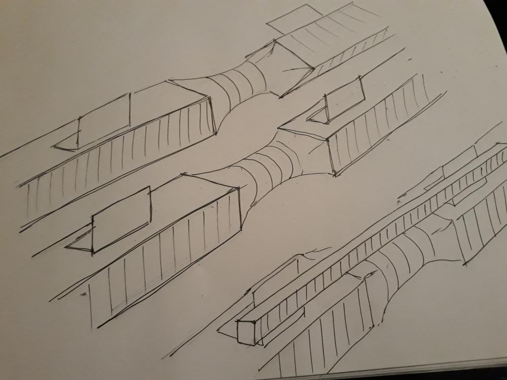

anvil Posted January 29, 2018 Share Posted January 29, 2018 To clarify. Instead of drawing out your large parent stock(2"square?) To 1" round and full length, forge the square stock transition to a short 6" long piece stub, then forge weld on a pie e of 1" round to final length. The 1" round on my candlabra was 36" or so. That's a lot of hammerwork! Thus the forge weld. Your situation here may be different. For aligning the twist. Take a short yellow heat on the round section. Clamp one of the square sections in a post vice with the top edge higher than the vice top. Place a short section of 1" angle iron on the square in the vice and another on the other square. Eyeball the two top edges, and twist til aligned. Support with stands as needed This should not creat any twist lines on the round section, so no correction needed. I believe using this angle iron is much quicker and more precise than clamping a long bar,,, that may or may not be twist free. When I do a picket, or long handrail, I start with the two pieces of angle touching each other. Then, move one angle iron out til I see the "sights" misalign. Mark with chalk, reclamp, straighten, then repeat. Quote Link to comment Share on other sites More sharing options...

Joel OF Posted January 29, 2018 Author Share Posted January 29, 2018 Ah ok, I see where you're coming from on both accounts now. I never actually explained that my rounded up section only needs to be about 75mm (3") long. I like the angle iron trick though for checking straightness. You even take that one step further & clamp a scrap piece of bar to the vertical face of the angle iron & assuming you clamp the 2nd piece of angle iron in the same spot on the other side of the rounded up section, when the piece of scrap bar hits the verical face of the angle iron on the other side you know you're back to even. Dubious doodle attached. Quote Link to comment Share on other sites More sharing options...
anvil Posted January 29, 2018 Share Posted January 29, 2018 Rotate the two angle irons 90 degrees and use the top edges as a gun sight. No need for the bar. The angle iron edges are straight, your bar may not be. Nice drawing! Quote Link to comment Share on other sites More sharing options...
