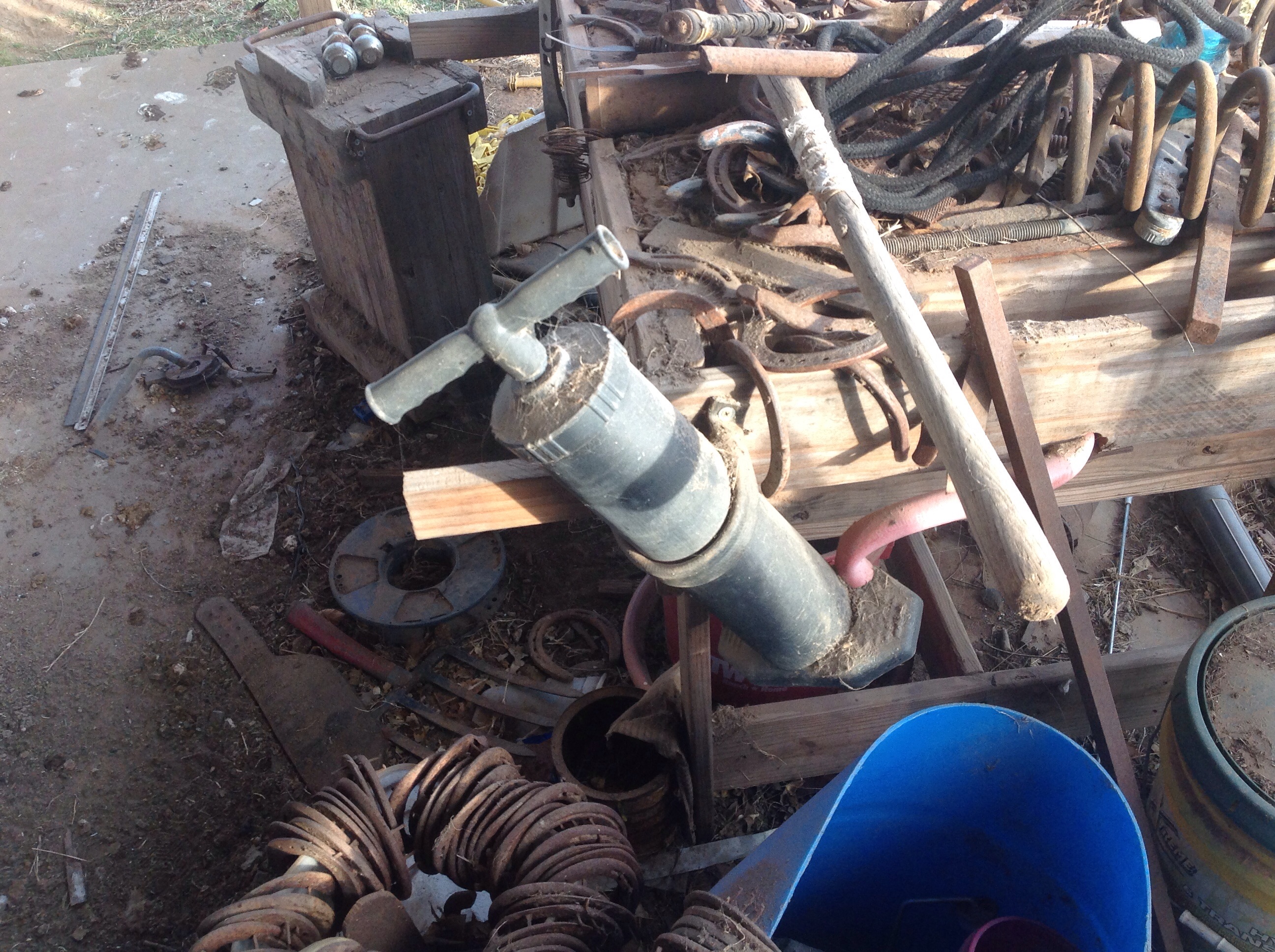

Charles R. Stevens Posted December 1, 2017 Share Posted December 1, 2017 Like this. $10 This is the old one mounted to the mark I JABAD forge. For one like me, it's just a bit harder to forget and burn up stock (tho I still do accusingly) with a band pump. I like this model as the outlet is in the base (so is the inlet, don't cross them) and it's a bit bigger. Yes it is mounted on the strong side. As I already have the tongs in my left, why put them down to pump. Quote Link to comment Share on other sites More sharing options...
