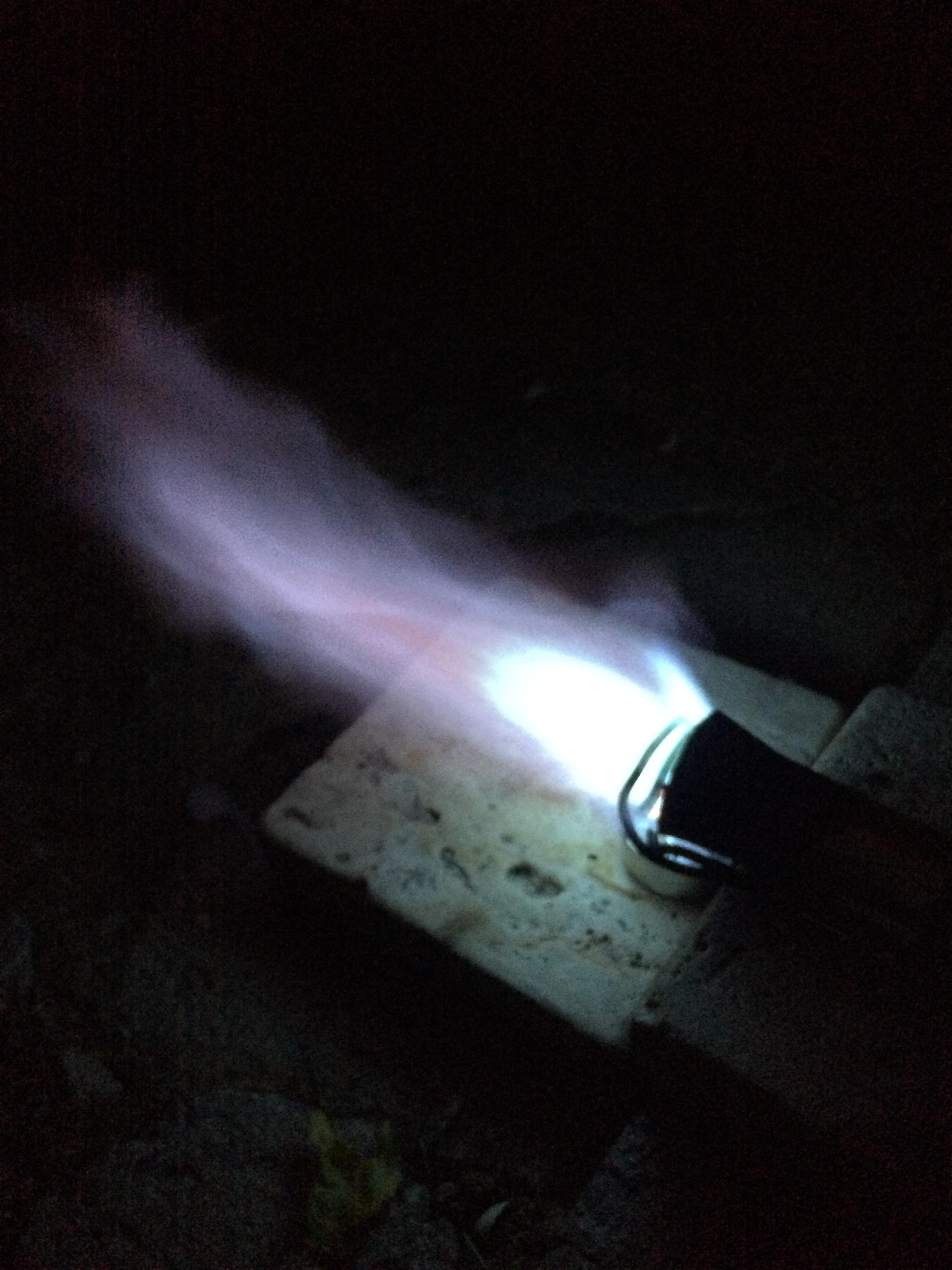

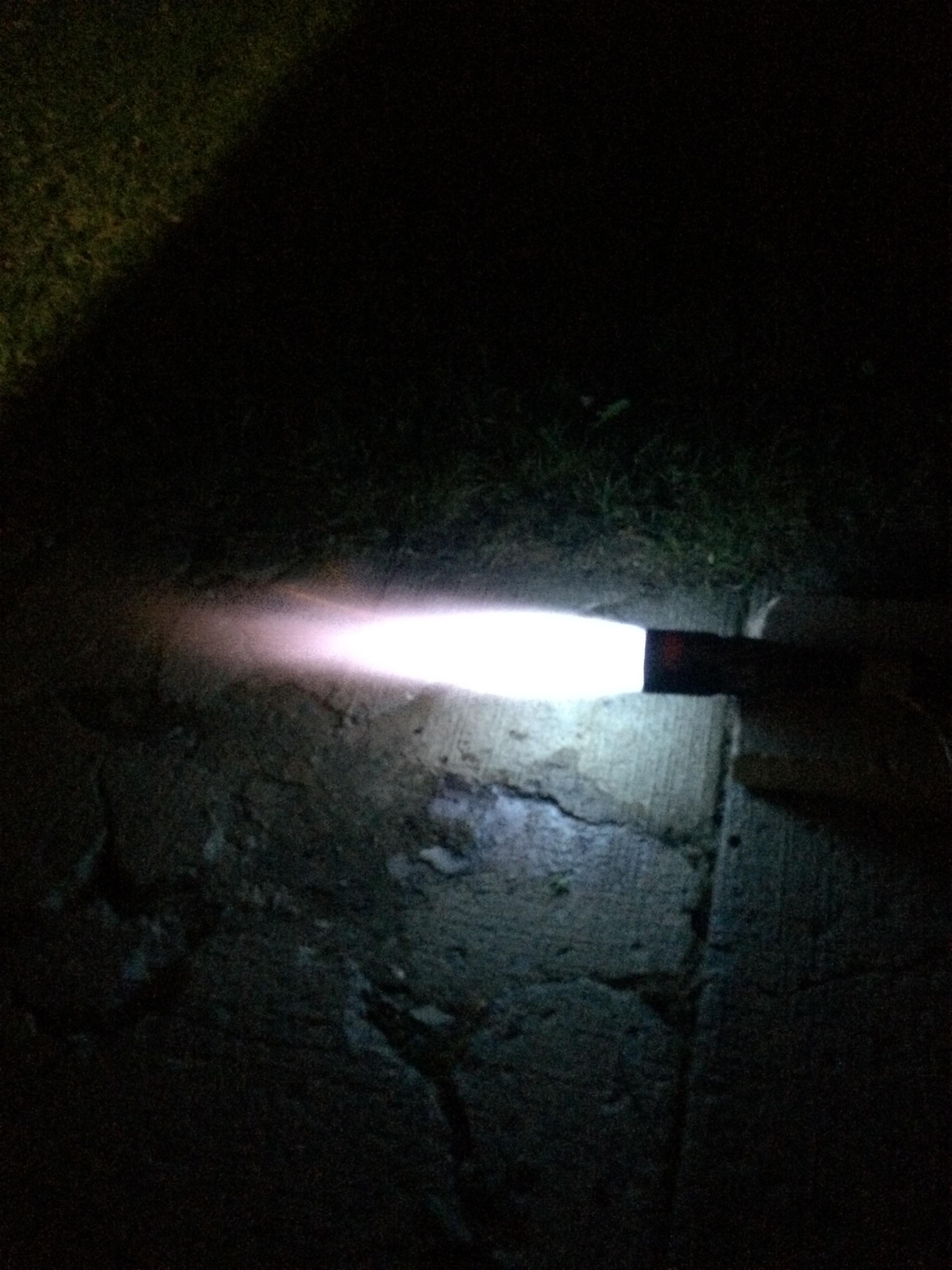

Got a needle valve installed, and tested it in the dark tonight, tried both methanol, and camping "white gas". Suffice to say that methanol does not work easily in a naturally aspirated burner. The gas however seems to work very well, video up soon.

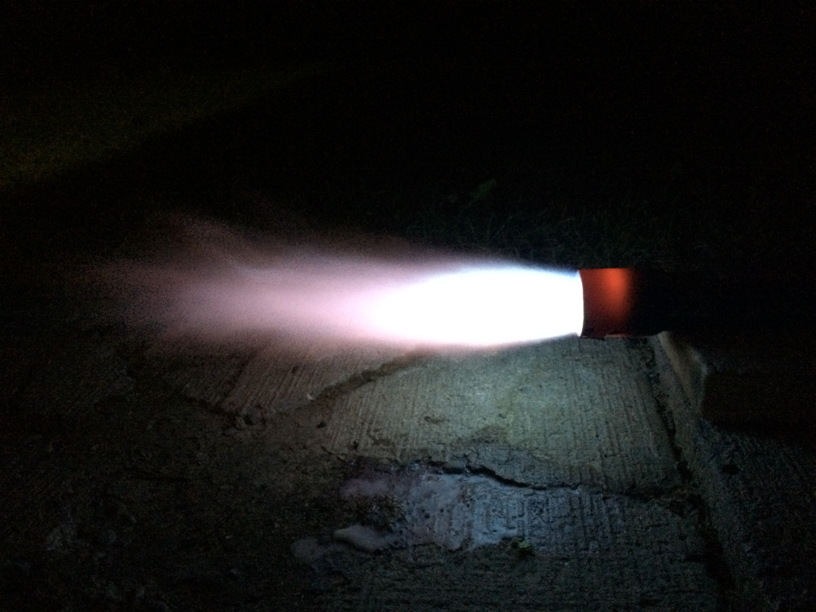

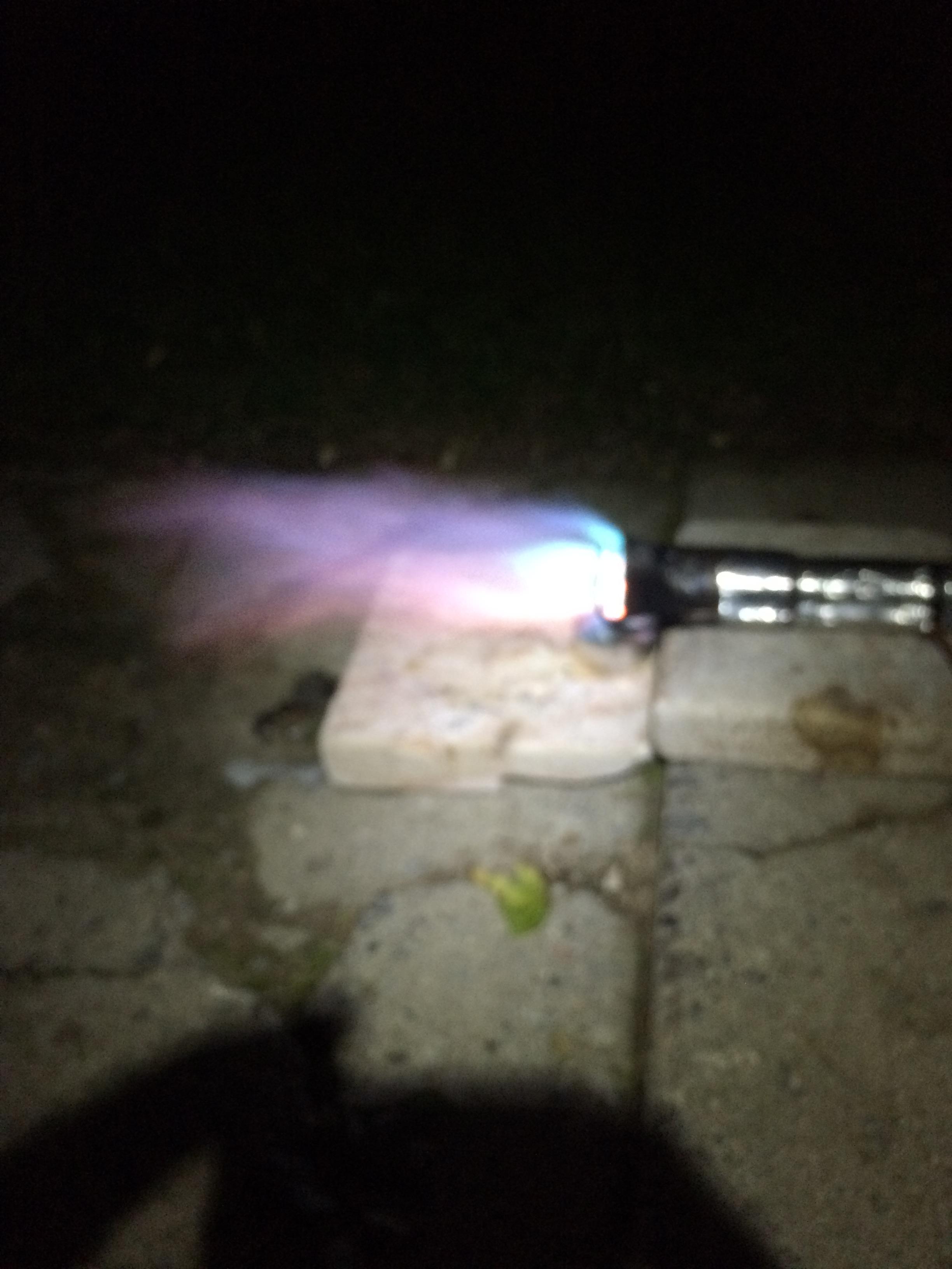

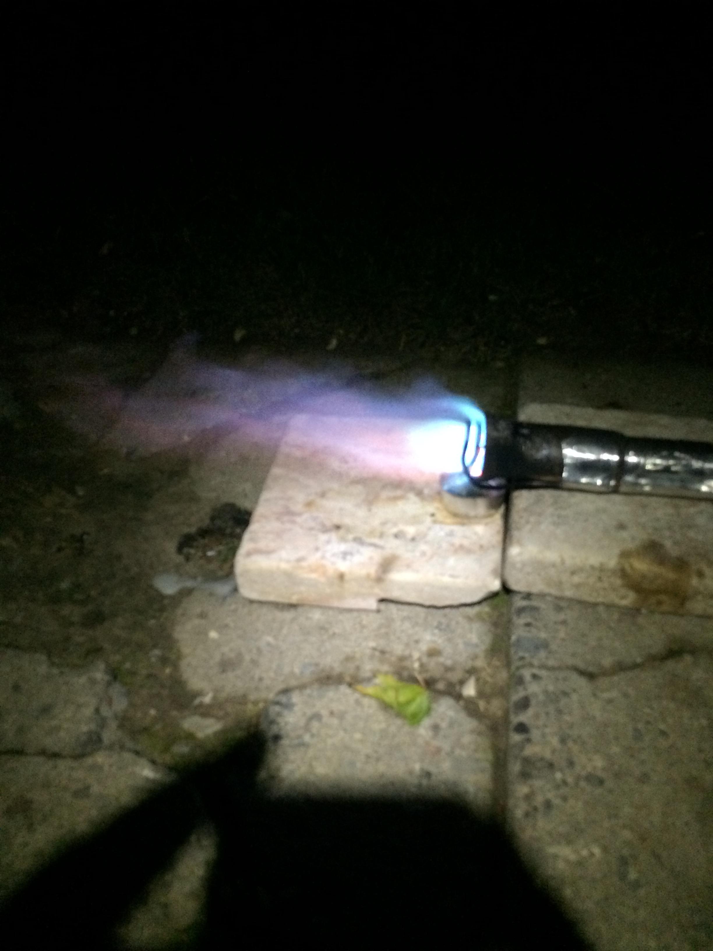

here it is running in the daytime on camping gasoline, it has many flame problems, with the huffing at lower pressures, and the flame coming off the end of the nozzle at high pressure. In person the colour of the flame transitions as well as the pressure increases, from a light blue to a darker almost purple. As I think it becomes more oxidizing. If I can I will add a larger nozzle, or add more flare to the existing one. Also something I tried to protect the nozzle (black pipe nipple), was a coating of calcined alumina with bentonite, which seems to work well, as you can see the flame is clean from oxidized iron colouring. Any suggestions to improve the burner?

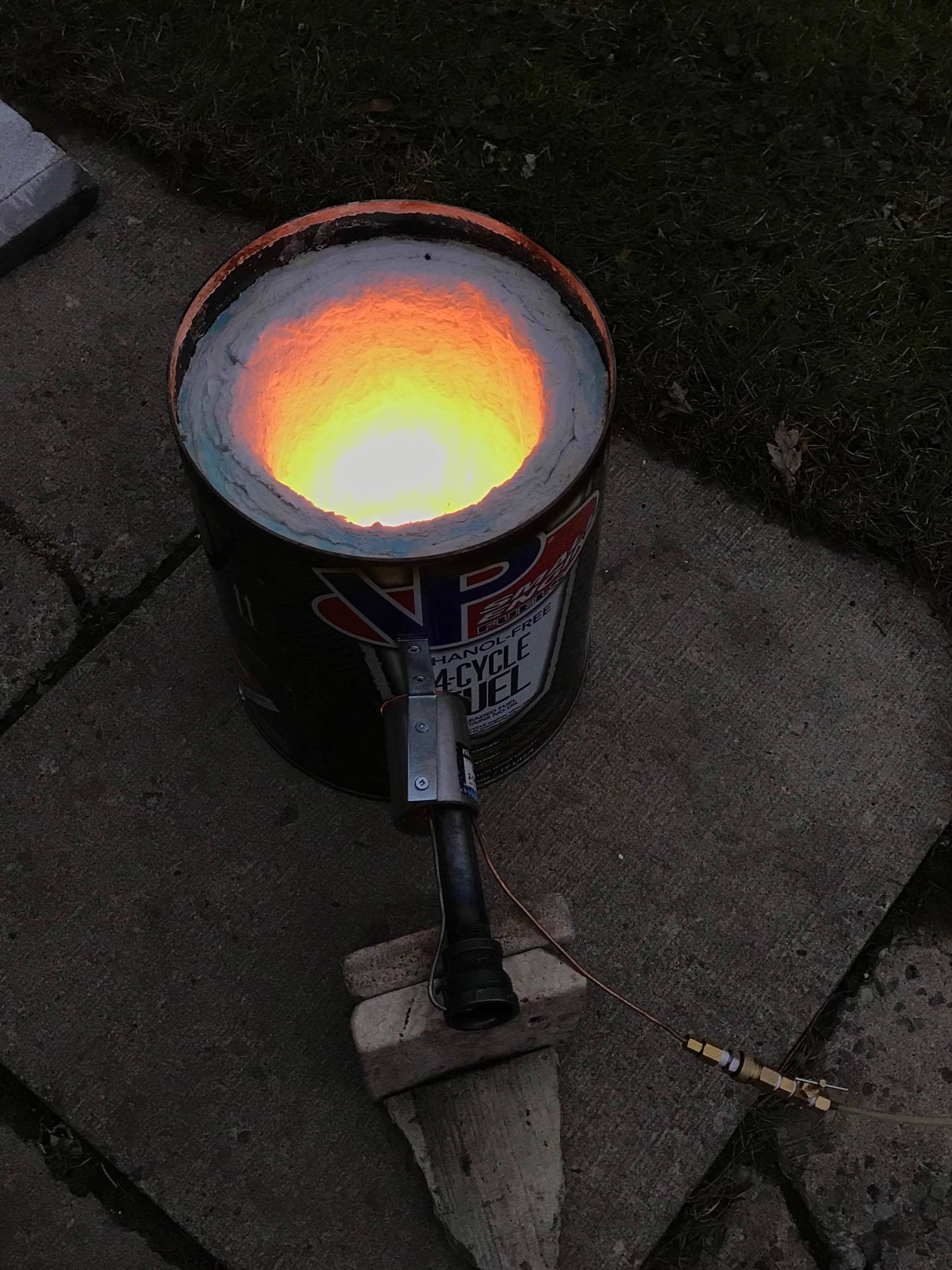

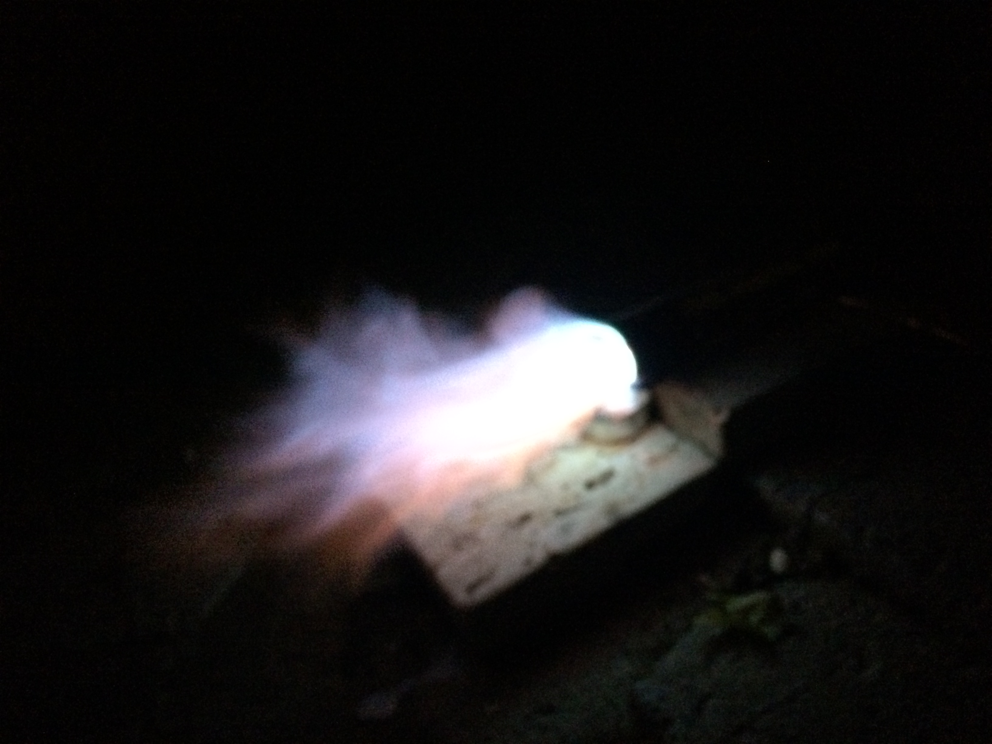

Since stores aren't open right now because of thanksgiving, I couldn't get any supplies to improve the burner in any meaningful way. I just made the coil slightly larger diameter, and decided to put it in my old mini coffee can forge, to see if it would help with the problem of the flame coming off the end of the burner. It was successful, and it melted a small piece of copper in the forge with no insulation or lid. Here's a video of it running soon after I started it up.

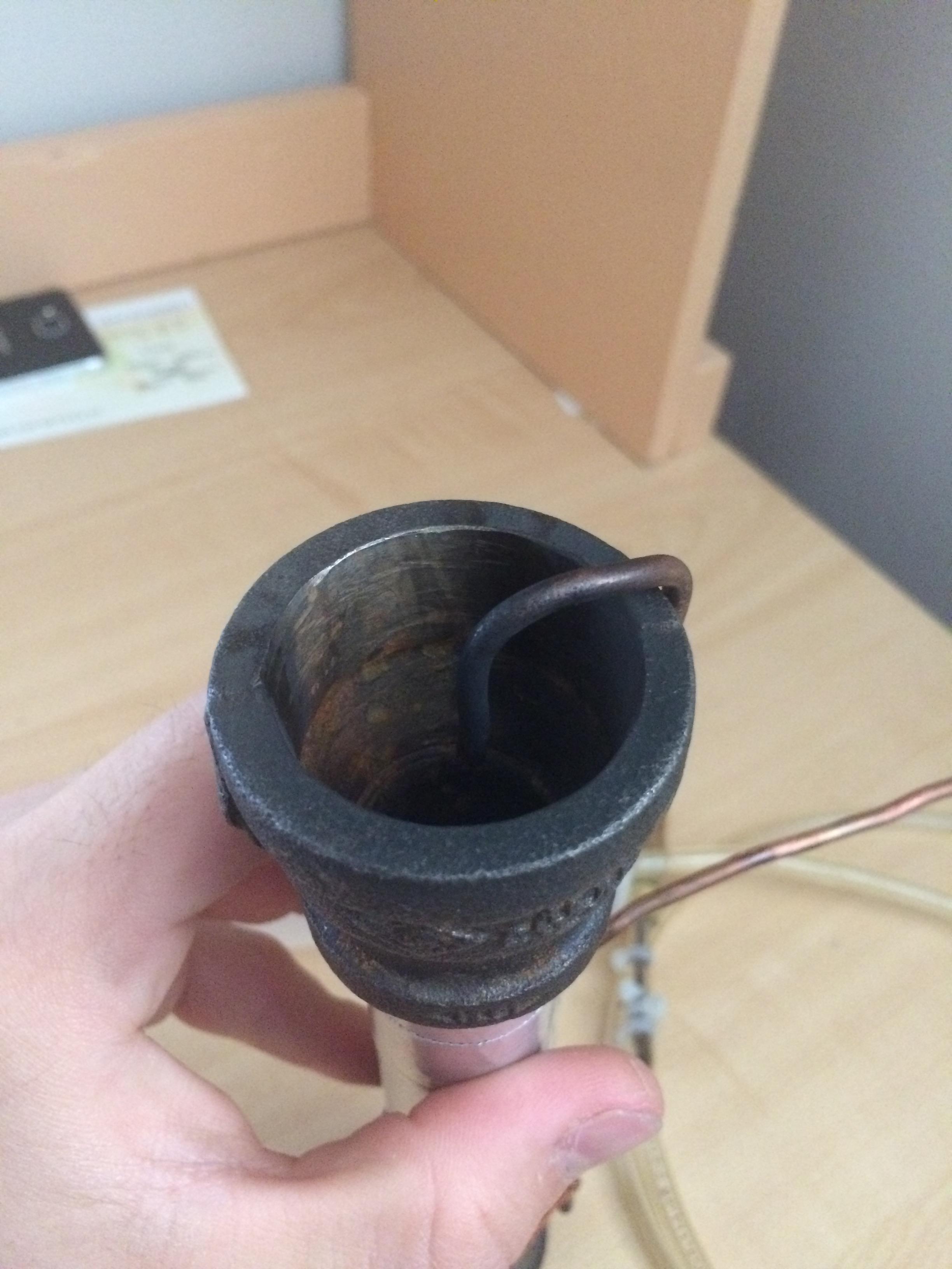

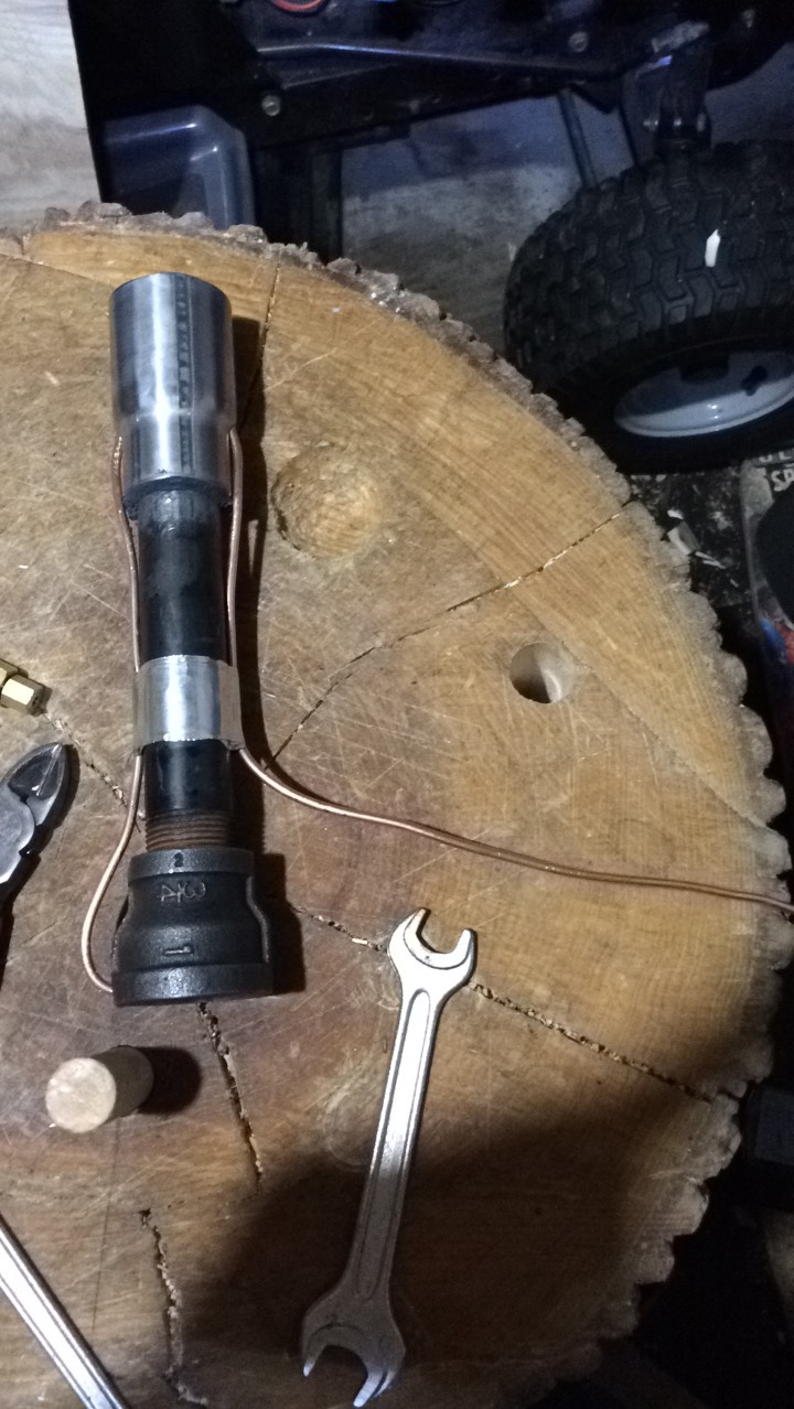

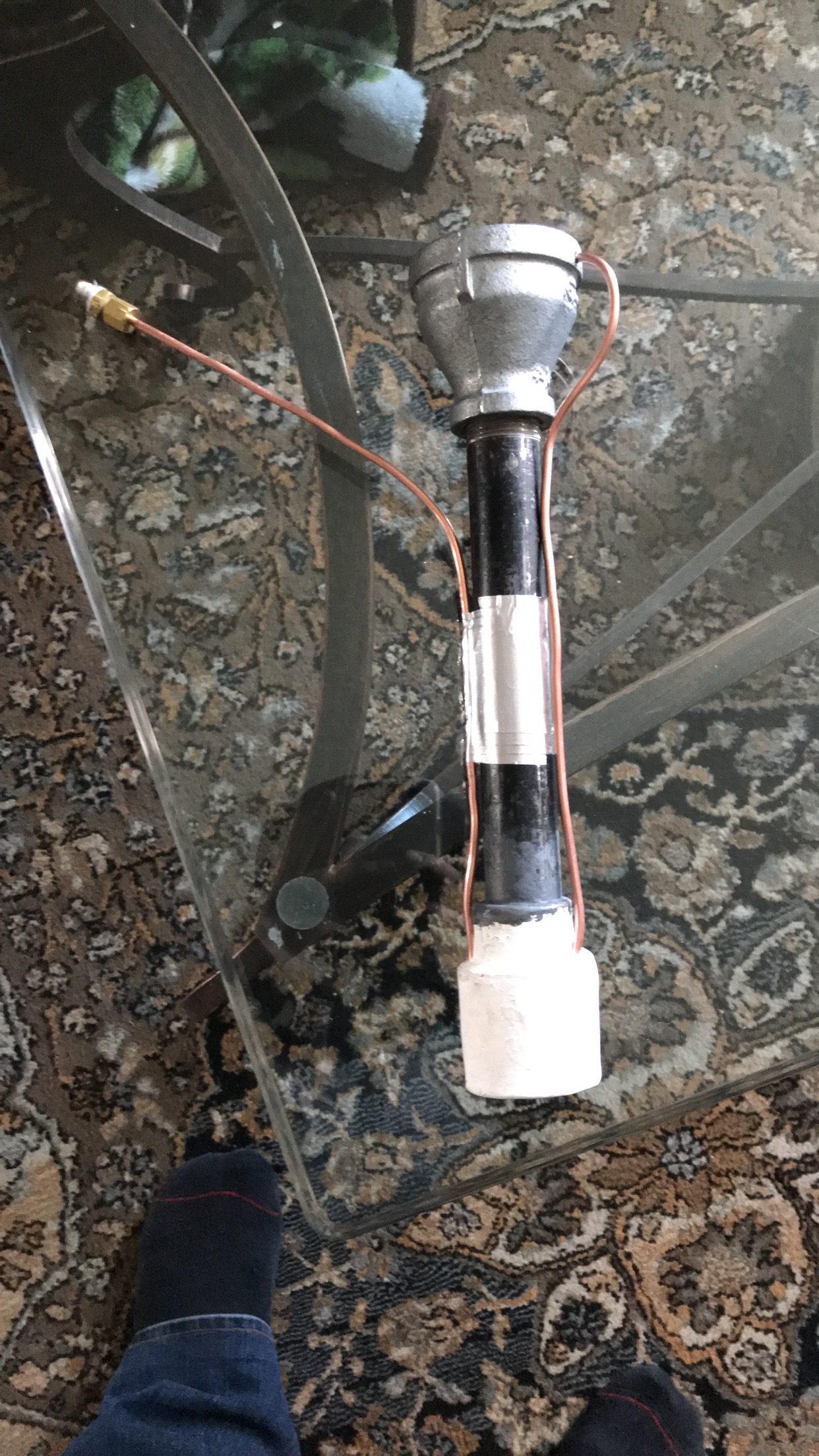

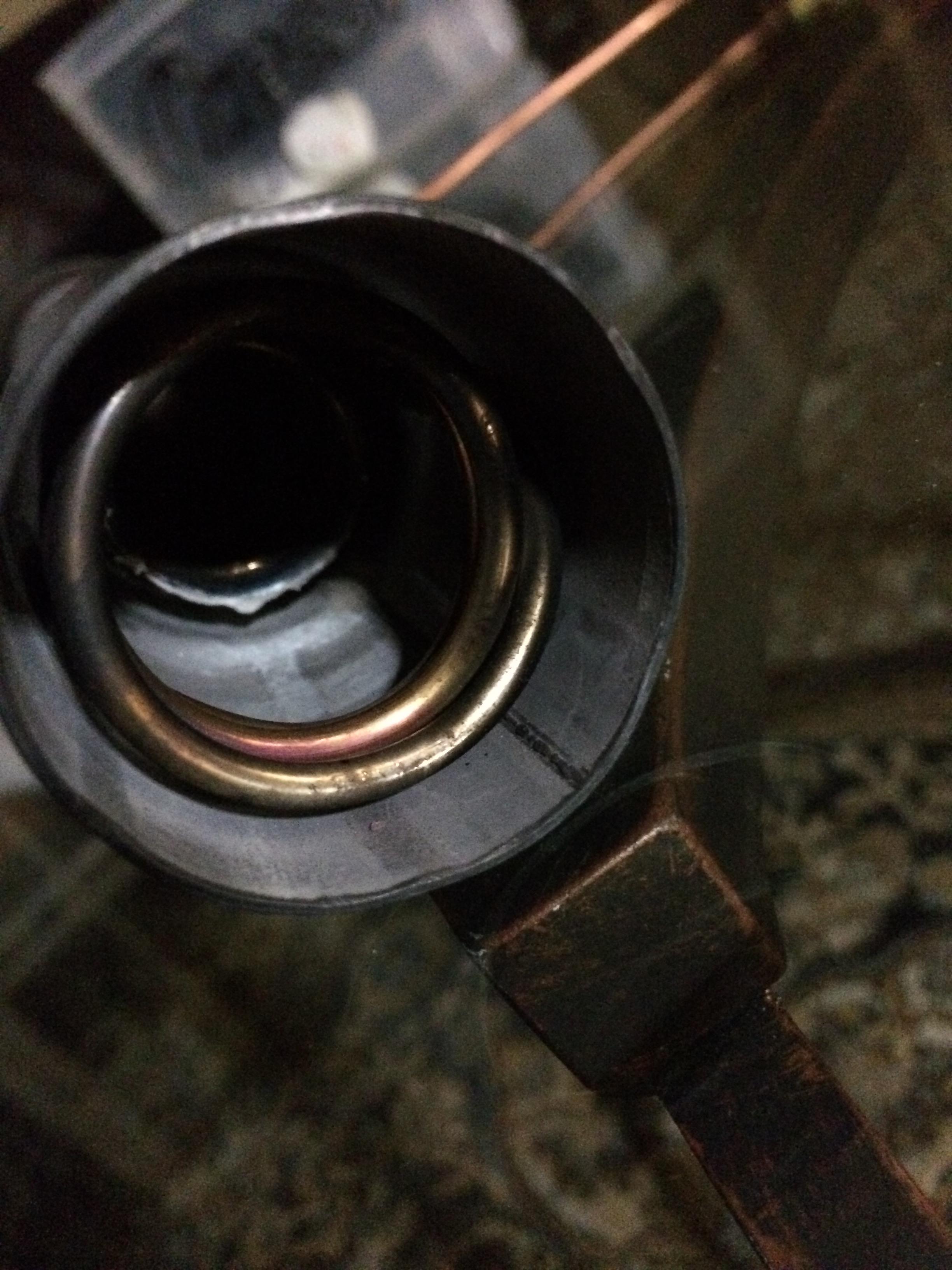

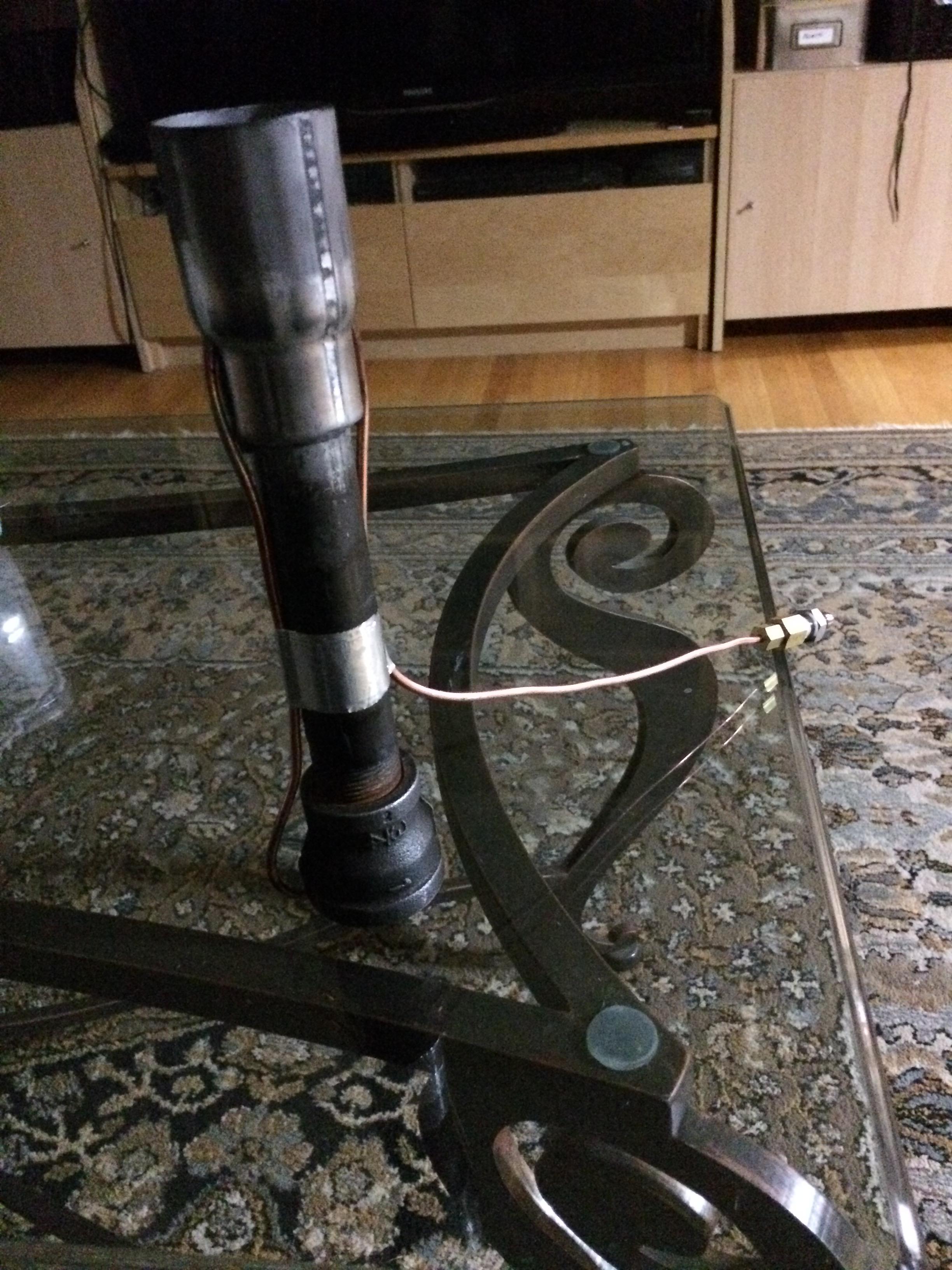

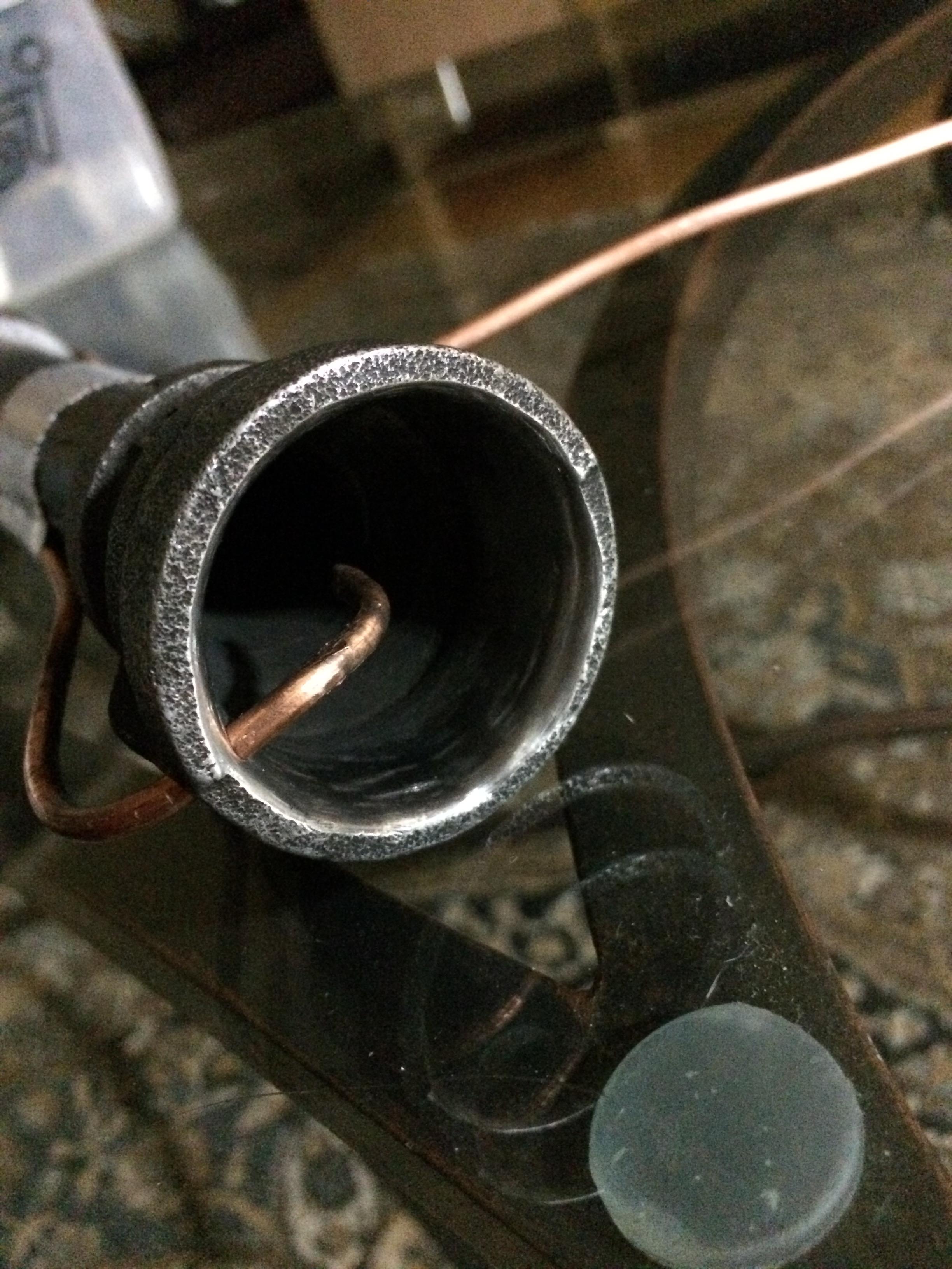

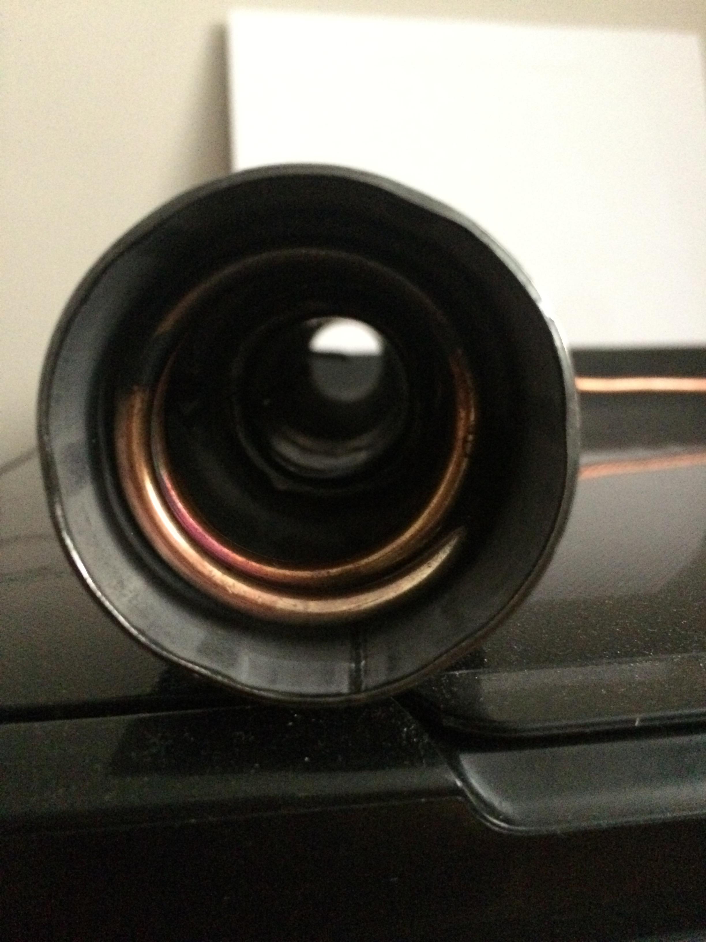

The design of this burner is quite simple, the fuel runs under pressure through a needle valve to control the rate, then through a check valve to prevent back pressure affecting the rate, and vapour lock problems. The fuel then runs through a set of coils infront of the burner nozzle, and to the back of the burner where it exits in the same fashion as a propane burner. As of now it doesn't have a set orifice size for the gas coming into the burner, but just comes out of the tube. The gas comes out at a high velocity because it has been boiled inside the tube like a Coleman stove, and it induces its own air into the burner.

-if there are too many coils then the fuel is vaporized to too high a temperature which causes it to become less dense, this increases the amount of air induced into the burner and makes the flame too oxidizing.
-if there aren't enough coils the fuel doesn't vaporize fast enough for the fuel rate. Enough said about that.

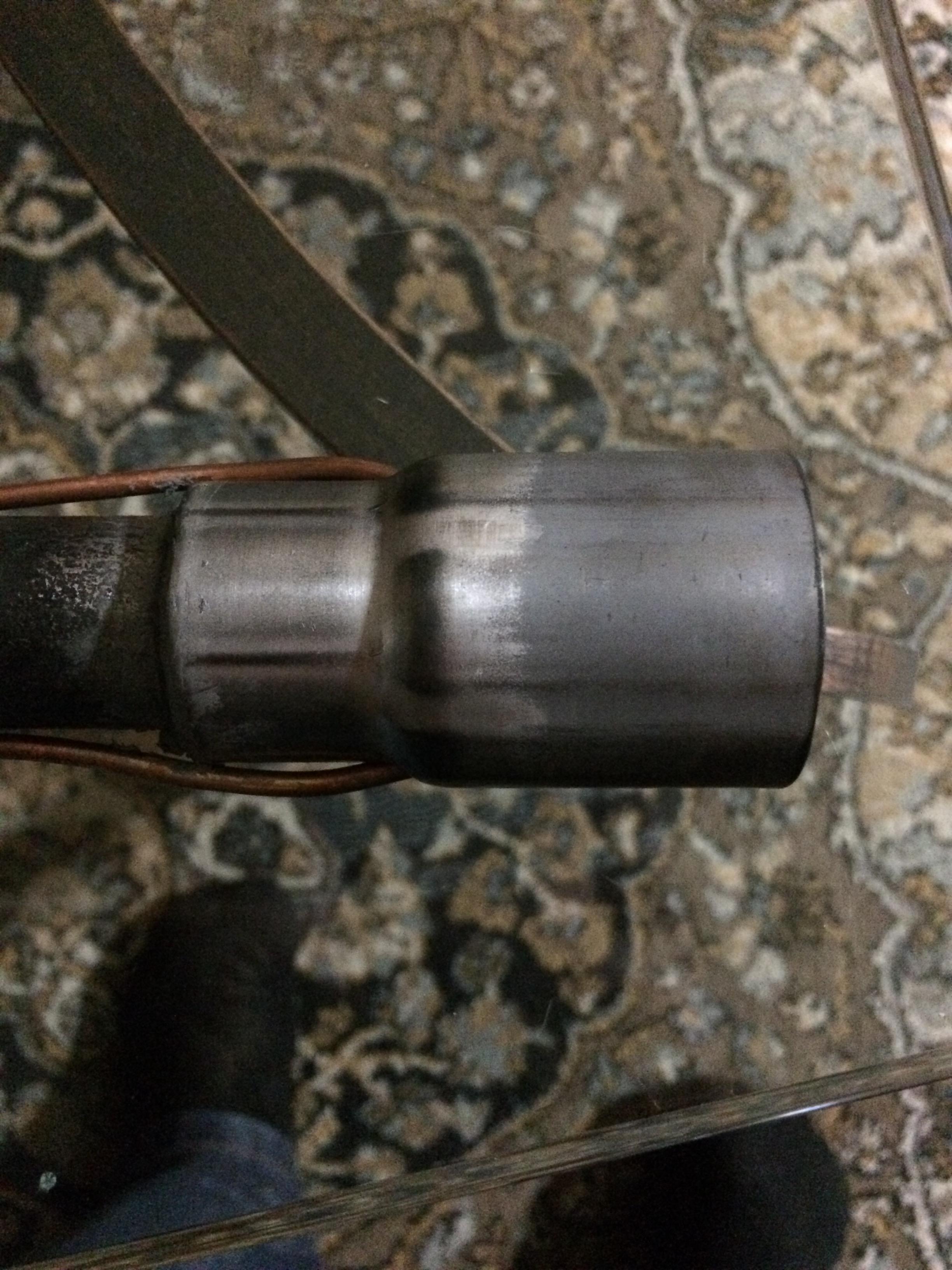

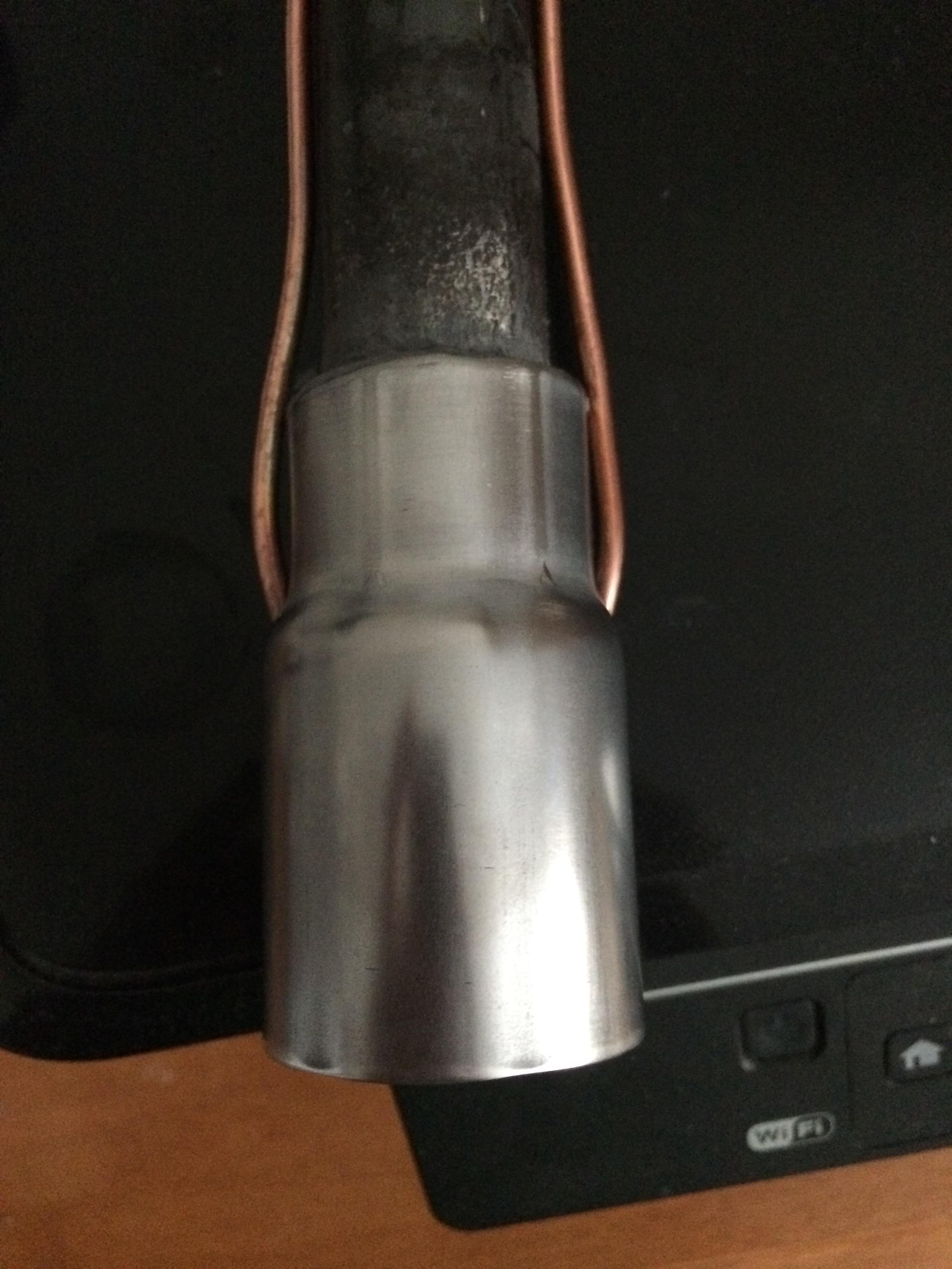

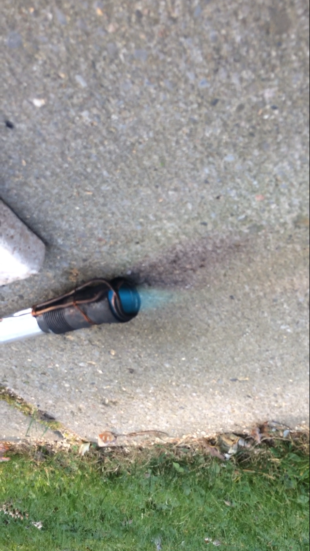

Today I got a new fuel line, and made a new nozzle which has a much larger diameter, and almost no taper (3.9cm internal diameter). The air intake was further opened, chamfered and polished, along with the exit of the mixing tube into the nozzle. The flame is what appears to me in person as perfectly neutral, and very stable. The fuel valve can be opened with no risk of the flame blowing out.
I was wondering if it would be acceptable to post some of the flame pictures in a thread on the gas forges forum, along with descriptions of what I did to improve the burner.
For those wondering the basis of the parts used to make the burner as is are, 6inch 3/4 black pipe nipple as mixing tube, 3/4-1inch bell reducer with the threads fully removed chamfered and polished, along with the entrances and exits of the mixing tube. The fuel line is a 1/8th inch auto meter 3224 copper tube, which directly jets the has in vaporized form. The nozzle is a exhaust coupling which was cut short and spaced on with two layers of the cut offs. The nozzle was attached with 2800f metal-metal mortar/cement. There is a check valve which is a 3000psi air valve I had spare.
This design allows only a small volume of fuel to be heated at once, just the volume of the 1-8th inch copper tube which is used to vaporize the fuel. It also doesn't require any air source (the fuel doesn't need to be atomized, it's vaporized instead). The fuel simply needs to be pressurized like in a Coleman stove, or with a fuel pump, this can be kept away from the burner/forge. Currently the fuel is pressurized to 40 to 60psi and the rate is controlled with a needle valve. I think it might work down to 15psi, but I haven't tried since it was redesigned. In the past running the fuel at lower pressure made it huff and go out easily because it would cause vapour lock. The check valve prevents this becoming a problem, but I haven't tested at lower pressures yet.
The new nozzle and other small changes fixed almost every problem it had, the flame is now very stable.
The next changes to include will be a small fuel filter, and trying the new design in a forge once my forge is built. Also polishing the nozzle in hopes it will become coloured from oxidation. Eventually a choke will be added for more control.

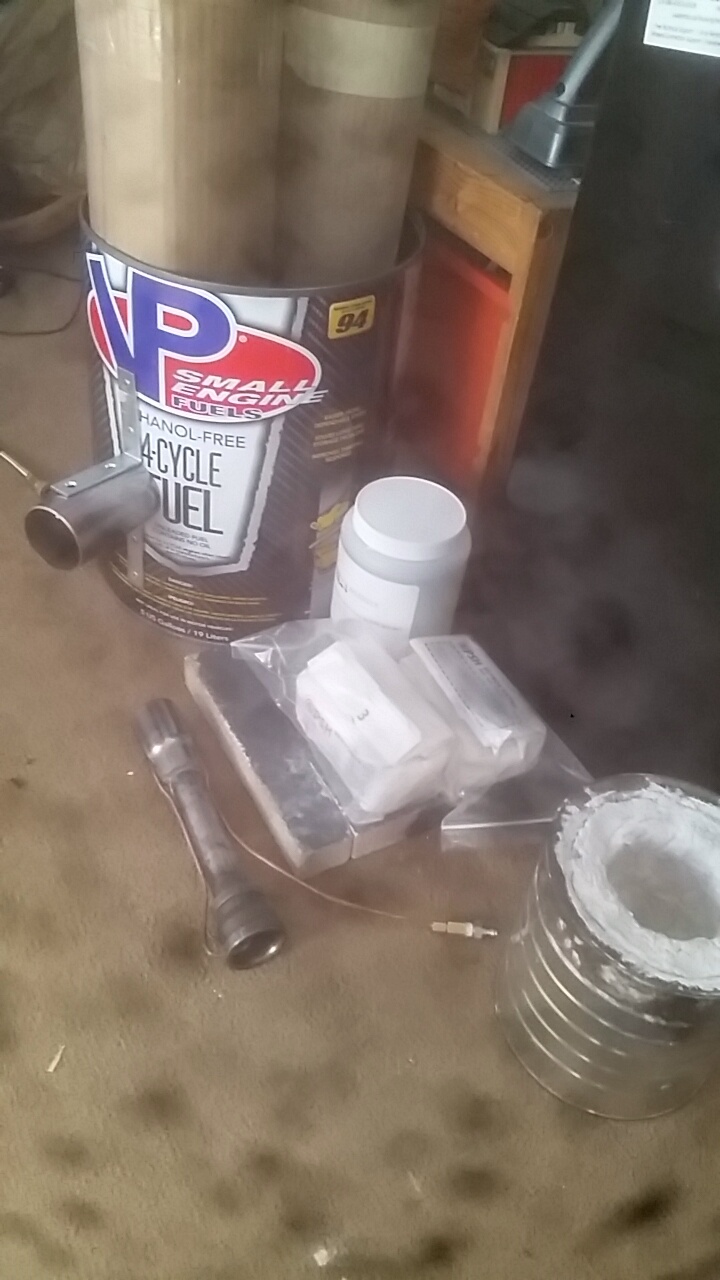

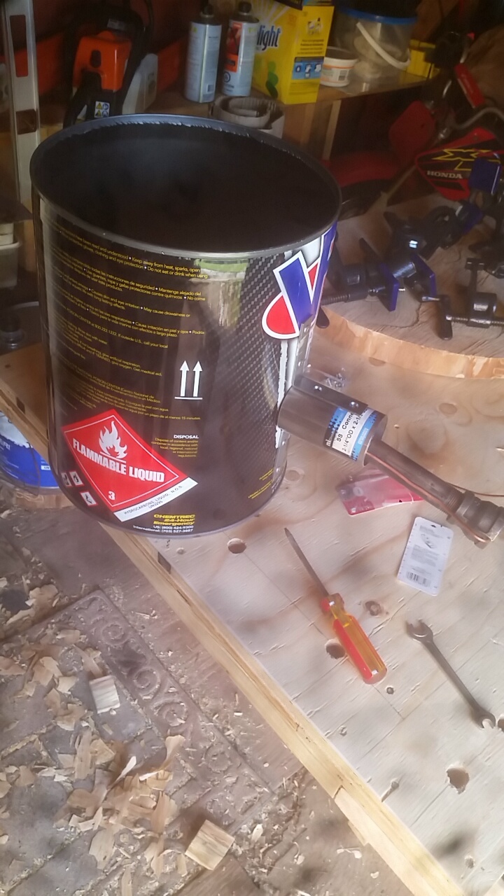

Got everything needed to out the forge together finally.
10.5 diameter by 13 inch tall steel can
Burner, mounts

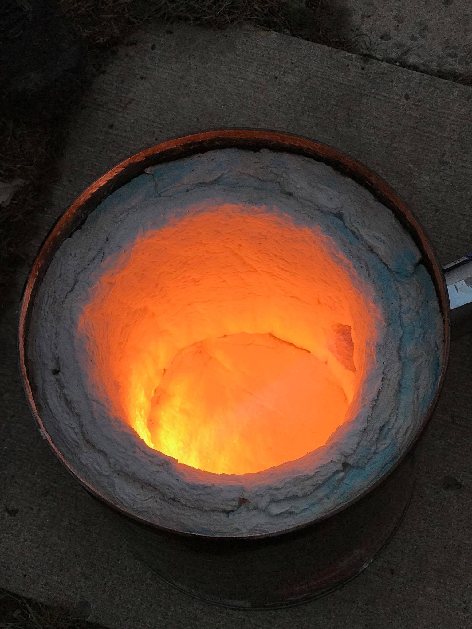

Ceramic blanket, and rigidizer (going to have 2 inches)
1 inch hard Firebrick as floor removable protection.
Zircon, and bentonite for coating ceramic blanket for ir reflection

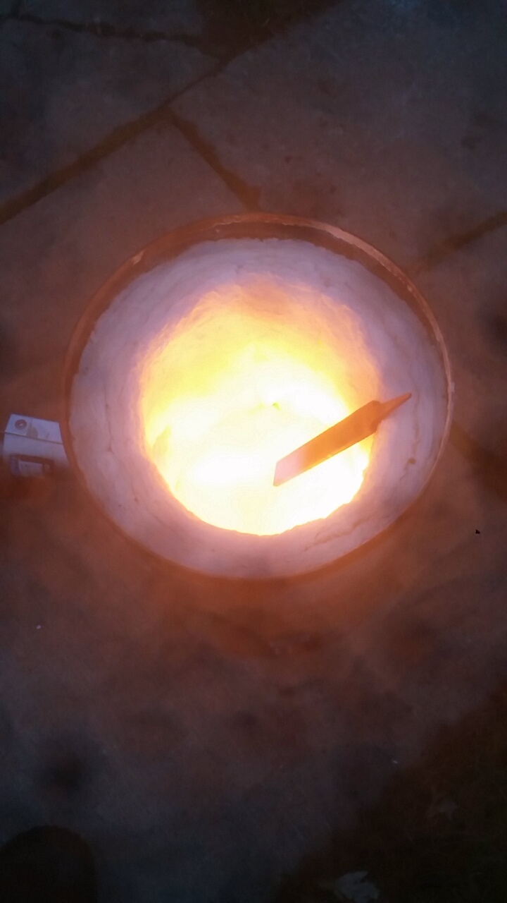

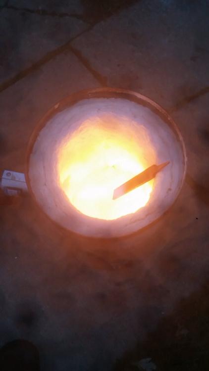

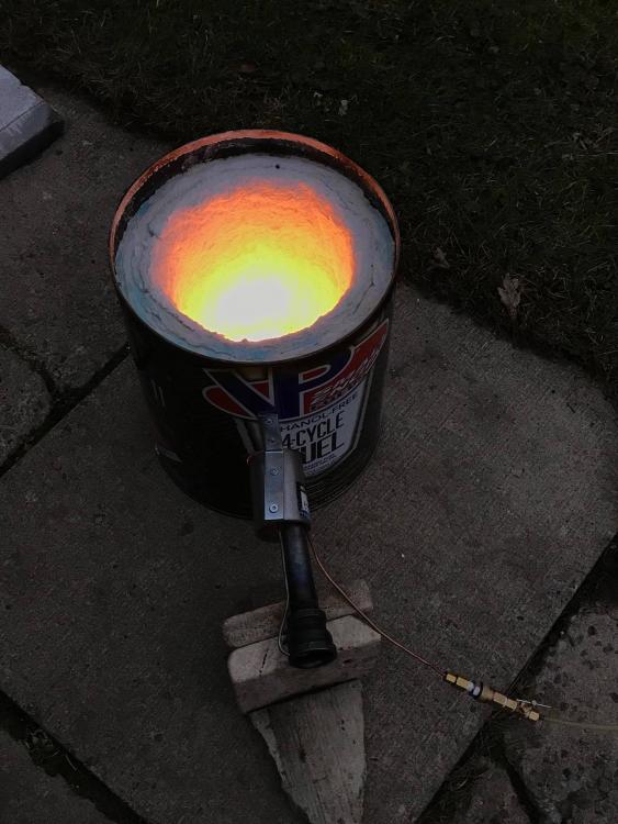

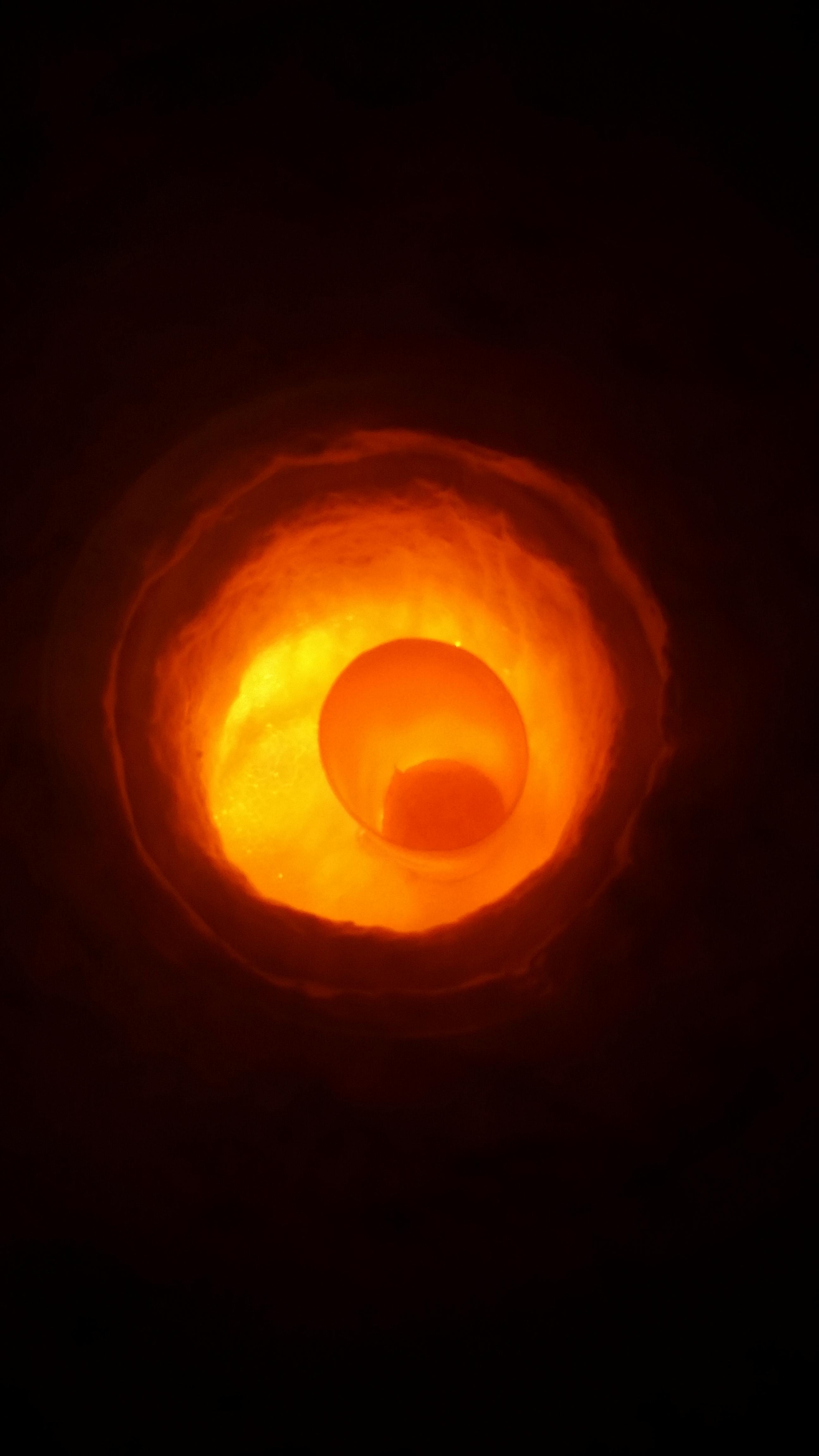

Well i got the forge together mostly  (or rather foundry, since that is what i will mostly be using it for). Still needs the firebrick floor to be installed, and to be coated with zircon. This was just the first firing for the rigidizer. Stuck an old rusty file into there to see how it heated it up. Works great.
  • 1 month later...

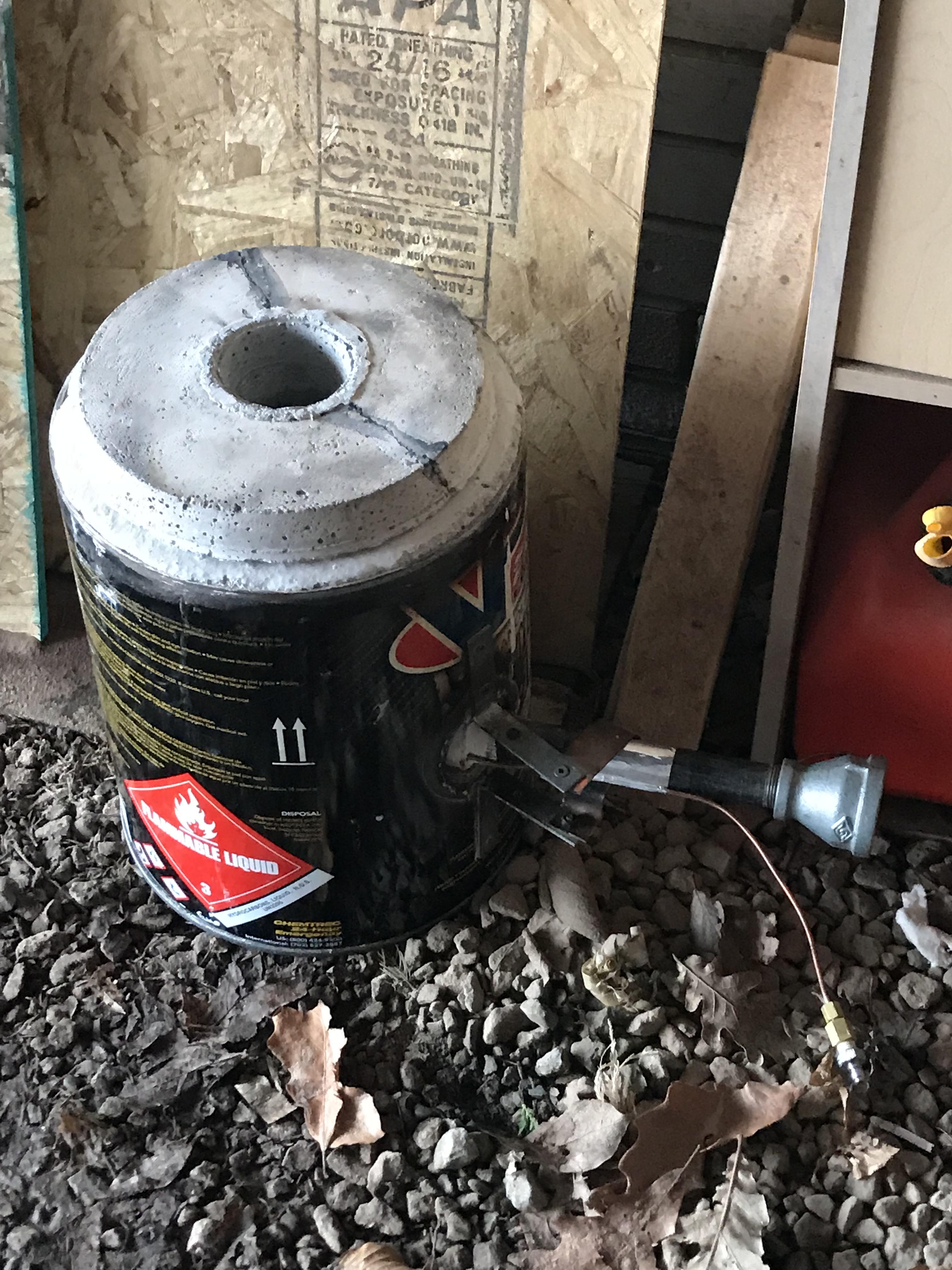

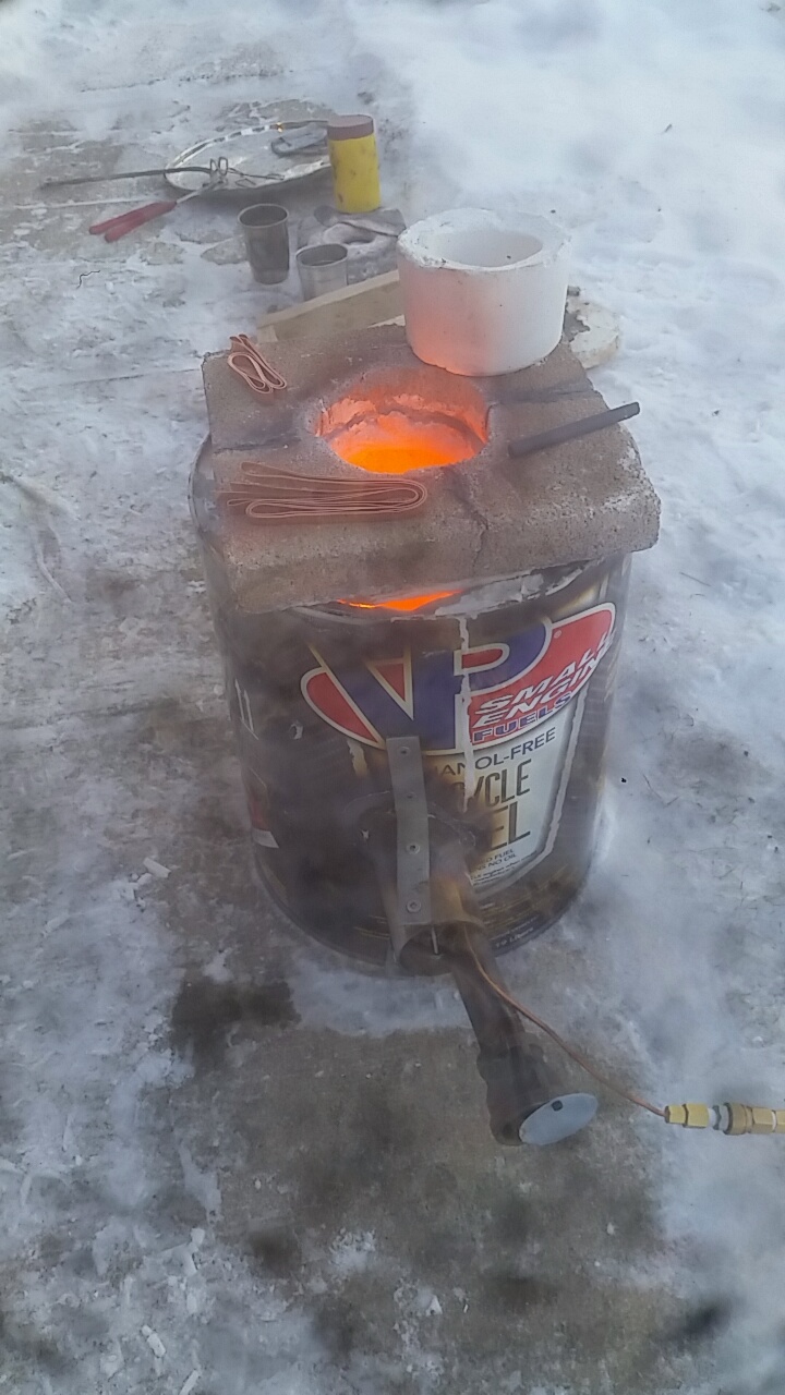

Added the mounting, and made a lid for now, as well as a choke, turns out it was running very lean, i was able to close the choke alot as shown in the pictures. The forge easily reaches temperature for casting bronze/copper :)
  • 3 months later...

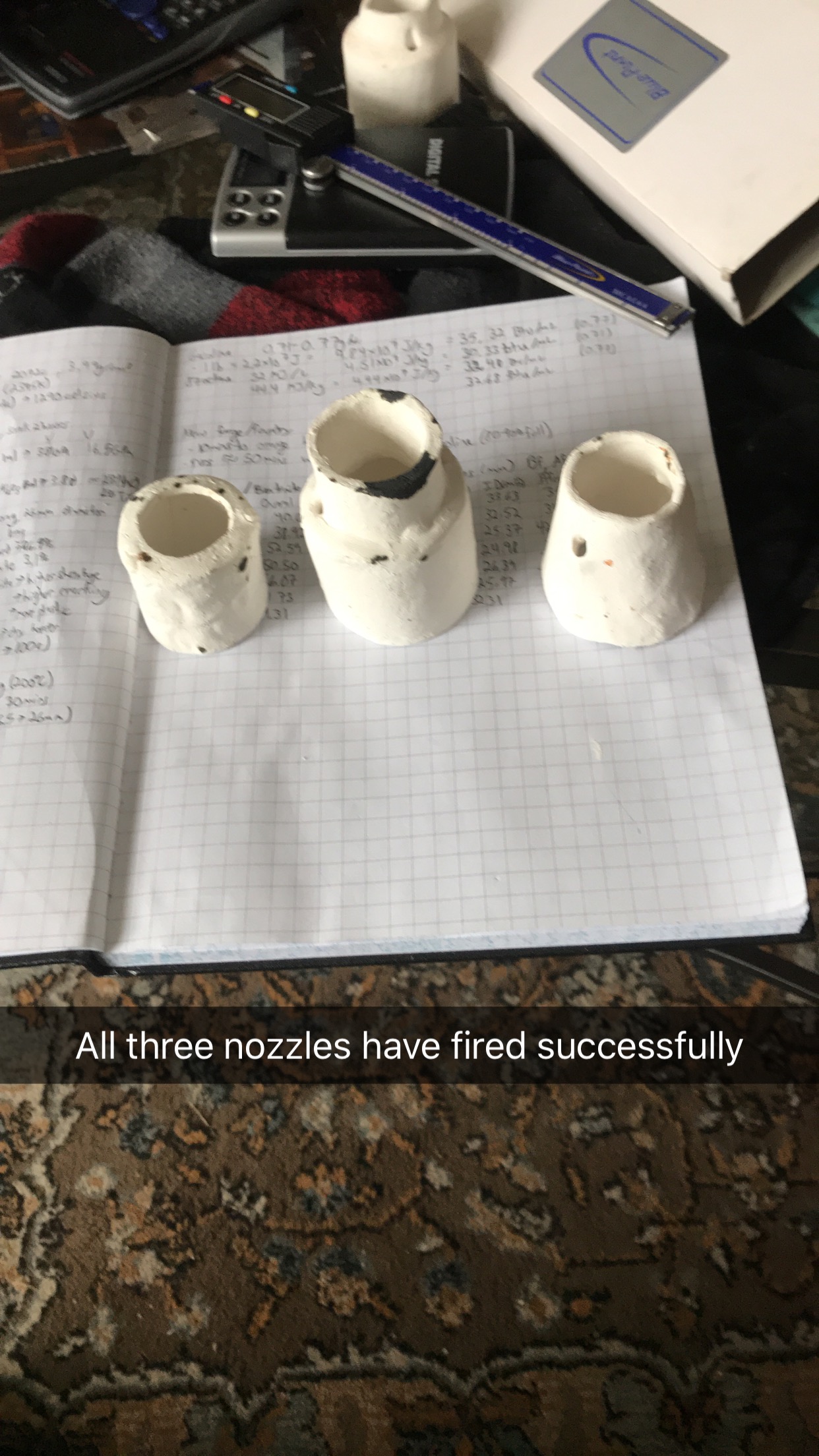

I formed some ceramic nozzles for the burner v2.0, and have added a better lid to the foundry, and proper castable refractory (3200f)
