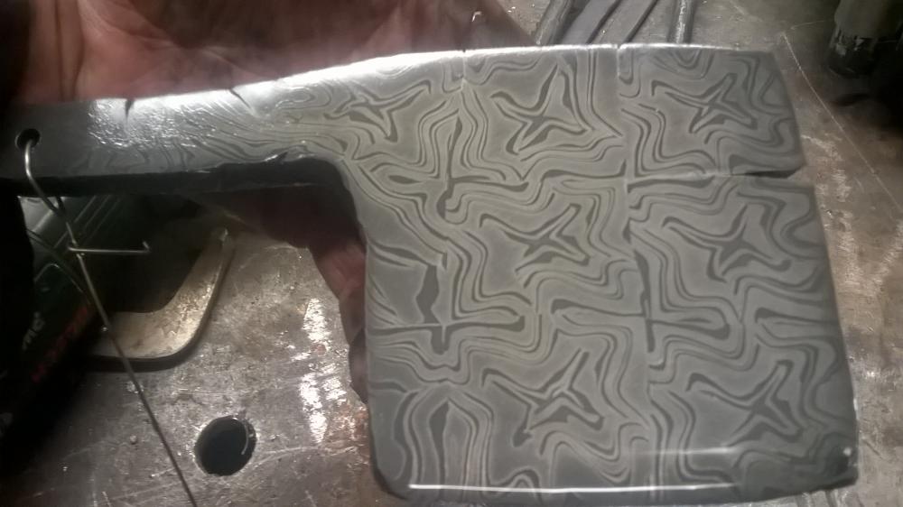

July 2, 20179 yr I tried to complete my nine star pattern welded cleaver today and had a weld failure, I think its time to bite the bullet and make up my gas forge. I have been having some problems with the flame chemistry making alot of scale and maybe i didnt have the billet hot enough. This is made from crane rail track and bandsaw blade I am very pleased with the way the pattern was developing
July 2, 20179 yr That is ashame with the weld. The pattern looks great though. It looks like you still have a hefty billet though, is there enough material to cut the failure off and still use it?
July 2, 20179 yr The one in the blade can always be made into a "design feature" It's the ones in the haft that I'd worry about. Possibly an arc weld fix and then not etch the haft section? Of course I'd use that myself and not sell it or give it to another---I own all of my mistakes and almost none of my triumphs!
July 2, 20179 yr Author I think if I remove all the faults I will still have a usable billet to make a knife out of, The idea of arc welding the handle cracks where they wouldnt be seen has crossed my mind but I still think i will just cut it off thebillet is still about 10mm or 3/8ish thick
