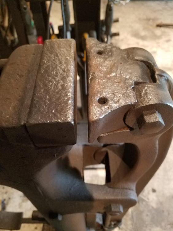

Here is a Well bro's vise made in Greenfield mass.   Does anyone know how the spring set up us supposed to work.   It has none but it definitely needs at least two to function.  Its a joy to have in the shop.
I have a bungee cord on it now to make it function. Also what is the cogged apparatus for?
My machinist is making me a new set of brass jaws for her as we speak.
My foot vise didn't have a spring it fell open naturally and closed under foot pressure.
Greetings Millhand,
        Just clean and lubricat the friction point at the bottom where it contacts the moving member. It will easily rest in the open position.

Ok thanks a bunch! I had wondered if that was the case.  Ill polish the pivot and lever.

Is a calking vise. Like Thomas said you hold it closed with your foot. They don't have springs. If I can find a film of the thing being used I'll put it up but in the meantime have a look at the sharp shoeing jobs done on these horses for the winter ice in this vid. A calking vise was a very handy tool for this type of work.

Thanks George!   This syle of vise does need the use of a spring to lift the lever.  The pivot point is very far forward. I found some pictures on the site of a few of these exact vises.   Now to find a period correct spring or make one :)

Looks like they came with a bunch of inserts.  I can see where i will be using this alot once i have a few jaws made for her.
Also feel silly for just now figuring out the adjustable block is actually a adjustable upsetting block.   Boy i feel smart.   Lol
