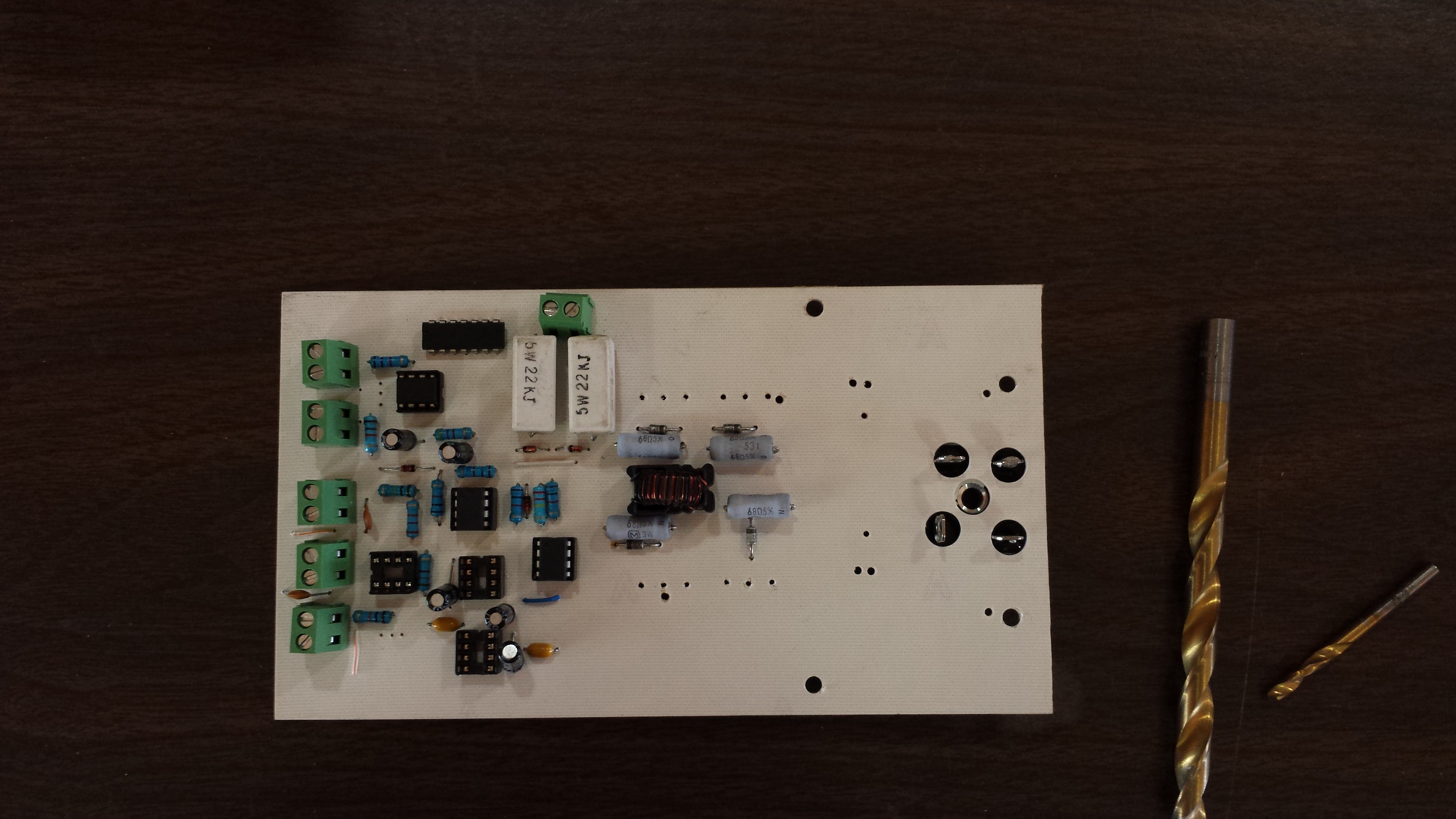

James Bond Posted July 4, 2017 Author Share Posted July 4, 2017 Everything seems to work fine, I try to work with a complete bridge inverter But I have several problems, The most important of them is the following, when the piece begins to heat its resistance begins to decrease and as it is in resonance the current rises to high levels so that I need a good control of current, Going out of resonance frequency does not seem a good method to me since this stresses a lot to the igbts and the power factor is bad. I would not like to use a controlled rectifier as it would increase my costs by having to buy half power scr as well as generate pulses and blabla bla The real problem lies in the topology .... since it is the most common topology and most used by home induction furnaces. Is a good topology but it has weak points a disadvantage of this kind of topology is that the heater will pull huge current when it run at nun load situation.and you have to put a current limiter to protecting your circuit in fact your heater power has hardly increasing with decreasing of load resistance. LCLR matching network has a gear ratio that varies with load resistance.actualy when you put a heavy load into the workcoil the gear ratio will be highest and your current will be low.and reverse in null load. and also your resonant frequency will be change . another disadvantage of this stuff is that for increasing the output power you have to decrease your matching inductor value and this is not good beacause the matching inductor supresses the current spiks of the inverter .and when you decrease. it cause this current spiks to damage your transistors Quote Link to comment Share on other sites More sharing options...

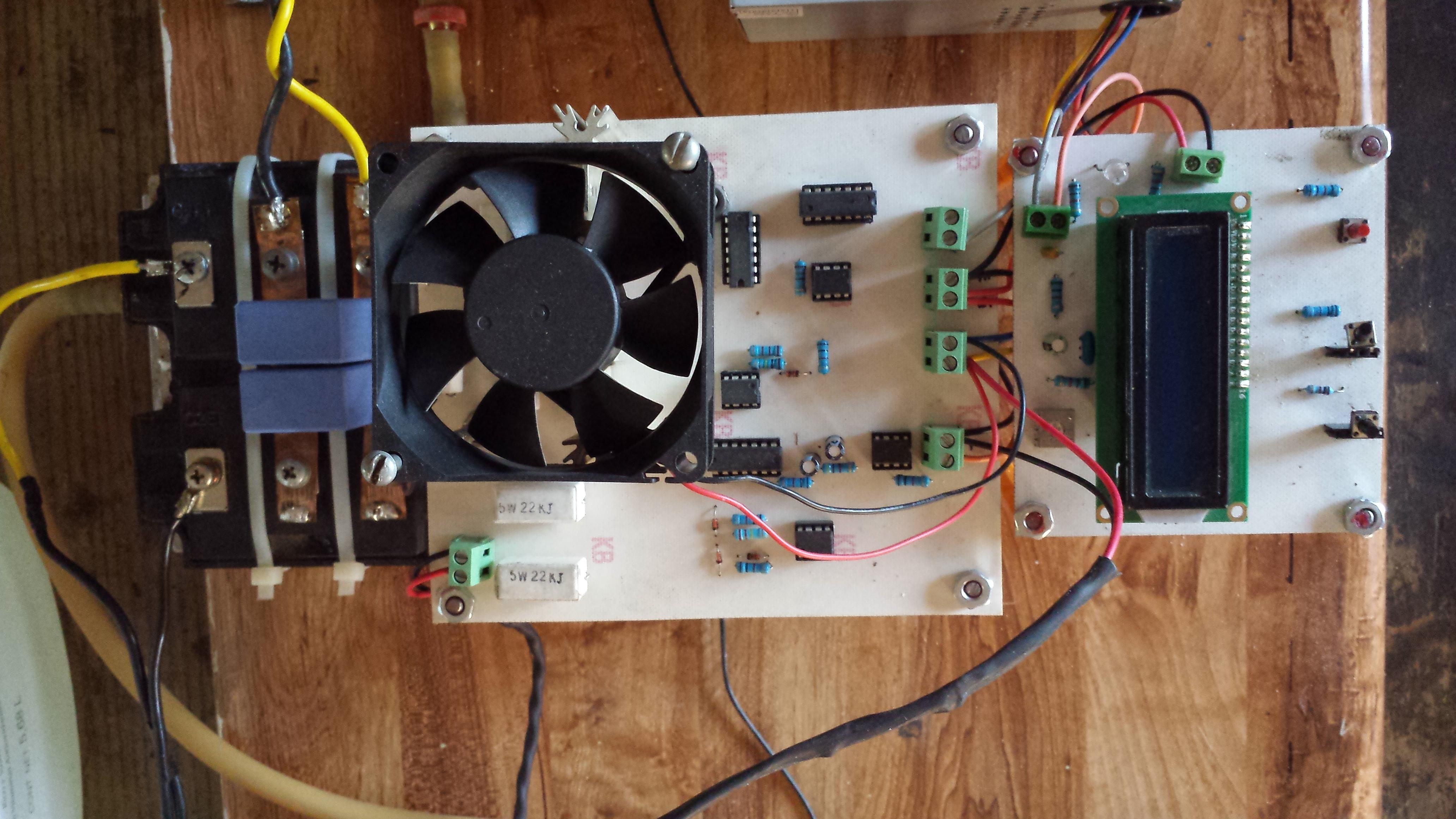

James Bond Posted November 28, 2017 Author Share Posted November 28, 2017 since now I'm using a pair module igbt. and im workin with 240vca. and i have a new board too. Im working at 245vca and the induction heater consume 25 to 23 amps. 6KW of power for small pieces its ok !! i can melt 5 or 6 oz of cuper in 5 miutes i think its a big step. this induction heater works fine very well but if i want go to higer levels 15 kw for example i need to do another topology but not now maybe 2018. Quote Link to comment Share on other sites More sharing options...

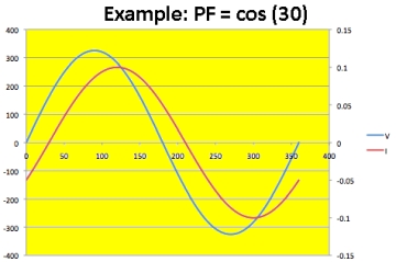

James Bond Posted November 30, 2017 Author Share Posted November 30, 2017 29 minutes ago, James Bond said: ok let's se point 1: come on!! a Variac !?! come on........... 220VAC line point 2: That is a good idea point 3: I don't have a power factor meter but each blue cap are 1uf/250vca so i have 2uf total. point 4: yea! GDT!!!!. hybrid drive are very expensive and you need 4 and 4 dc-dc powers supply if you know for some cheap let me know. point 5: we need to discusse this point. I'm working with pic microchip and i have a range from 10khz to 500khz . i dont know anything of Atmel microchip but i understand a little bit your power stage controll and im in love with this ...it's a shame that in the web nobody explain the power stage controll. in mexico nobody knows about atmel. you can controll the power of your unit always at resonance... boss! point 6: well i can do this ..but later point 7:ok i have two more that I can stack. i think i'm saturating this one . they are 3c90 material chinese units haha point 8: thanks i have to do that my new friend josh thanks for your time and help me Quote Link to comment Share on other sites More sharing options...

James Bond Posted December 1, 2017 Author Share Posted December 1, 2017 when i heat some material the current rises and it can be dangerous i need a current control. first i need mesure current. if a have advances i will post . Quote Link to comment Share on other sites More sharing options...

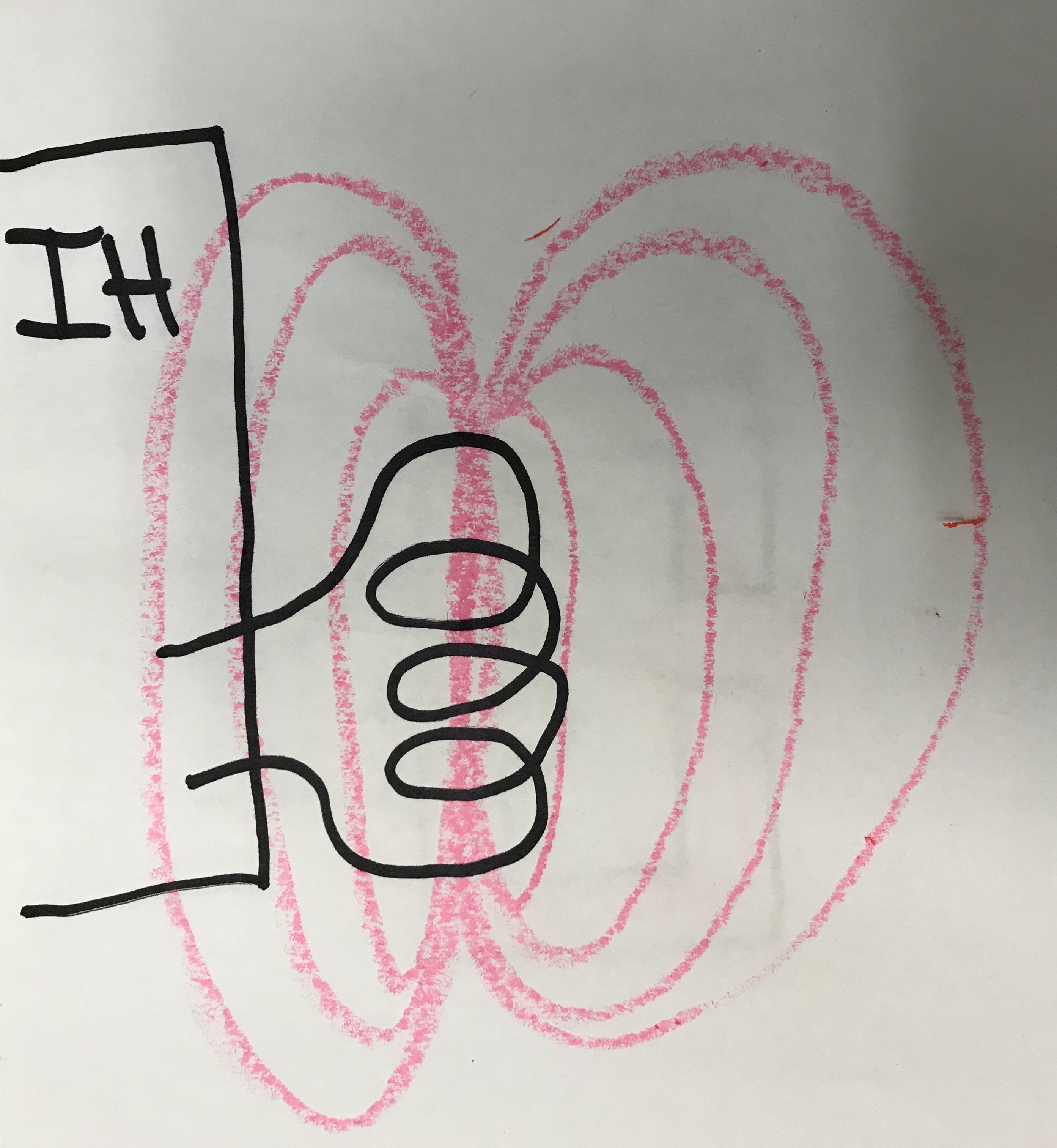

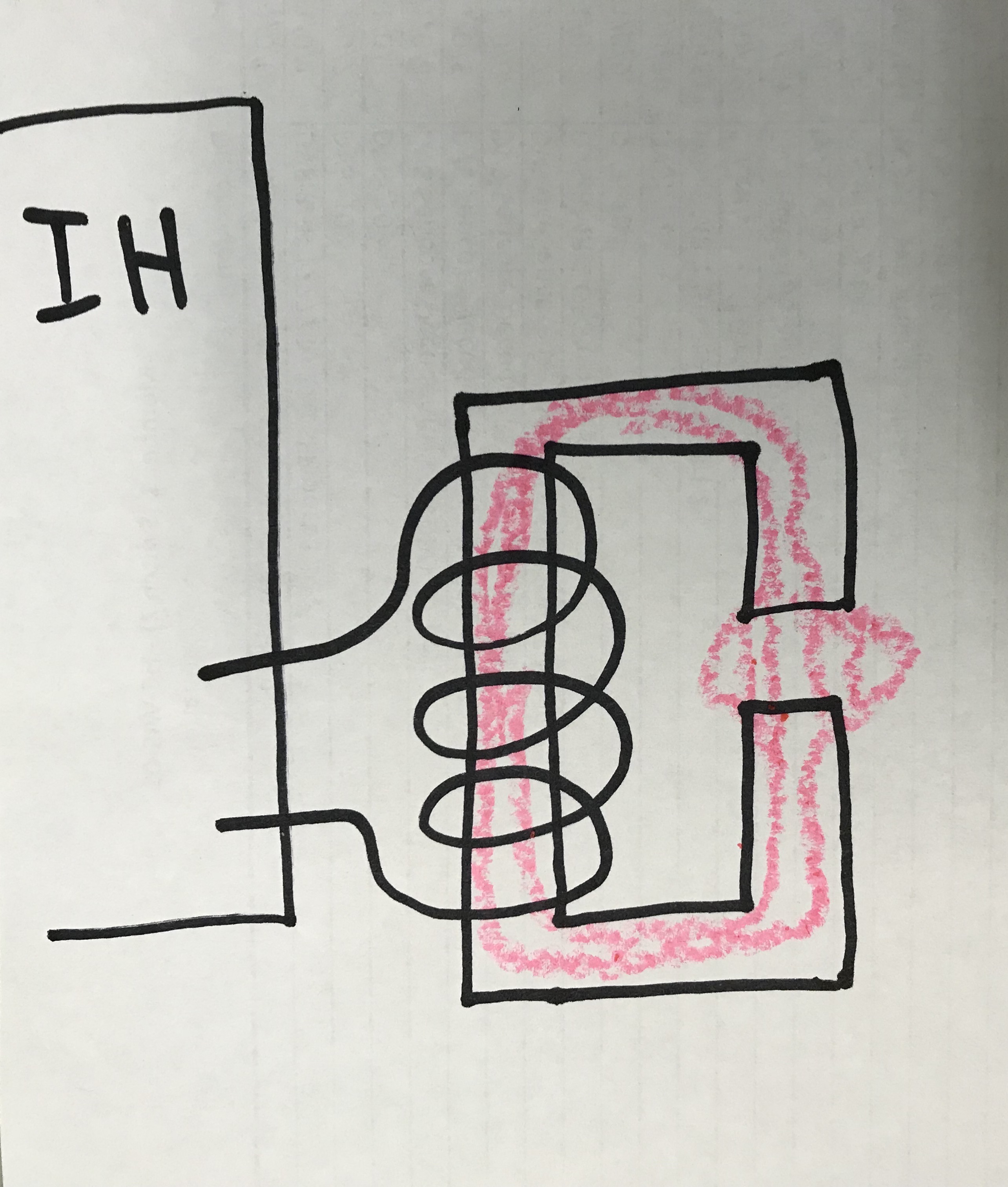

James Bond Posted December 4, 2017 Author Share Posted December 4, 2017 On 12/1/2017 at 3:20 PM, ReactorForge said: Mod addition: Since you are not aware, let me inform you that many of the over 150 countries we service are places that still have dial up, and pay by bandwidth used. In the USA many take it for granted having high speed and unlimited bandwidth, Others do not have this luxury, try to be considerate of others, you just Had to quote the entire thing again didnt you ? I am not the great student of electronics that you think and I do not know many things about many subjects. My main problem is that I do not know many people who know about the subject of induction furnaces. I would like to have some mail or something to be in contact with you. Today I have several doubts. I have seen a material called flux that serves to concentrate the field of induction coils. it is very expensive. Is it possible that some more common material will be useful for this experiment to concentrate? since for example I would like to make a coil like the induction heaters but concentrating the field above the coil. I am trying to make a current sensor by measuring the input current from the input line and not from the inverter. is this ok? Quote Link to comment Share on other sites More sharing options...
ReactorForge Posted December 4, 2017 Share Posted December 4, 2017 Don't underestimate yourself. Some of times greatest minds were self-educated! You're doing a great job, just be safe, keep failing, and keep learning! You won't run into too many people on the streets who specifically "know about" induction heaters but that doesn't mean you can't confer with other like-minded people about electronics in general. The induction heater circuit overall is a very fundamental and beautiful thing really. It's like nature wanted it to exist! My email is on my Github page. Shoot me a message, I have a book I want to send you that will help. Yes, there is a material you can use to concentrate the magnetic lines of flux called ferrite. It's the same or similar material used in your matching transformer. It doesn't heat up as nearly much as say a ferrous piece of metal would because it's ferrous particles are isolated from each other with a ceramic thus preventing eddy currents and I^2R heating. John DeArmond with fluxeon.com (NeonJohn) uses this in one of his models calling it a flux concentrator. It works basically like this; the crude drawings show the magnetic lines of flux in an induction heater coil with an open coil and one with a "flux concentrator". If you use this method you must take into account the fact that the ferrite "loads" the work coil much more than any workpiece. You must account for this by changing the impedance of your matching transformer (fewer turns on the secondary, more on the primary, etc etc). It also lowers the resonant frequency of the tank so you might even need a lower value capacitor to raise it back up, unless you want it lower... It's an interesting thing to experiment with, I recommend it. I don't really recommend it's use in a metalsmithing role but it does have its advantage. For example, it's amazing for brazing small parts, like copper tubes to make other induction heater coils. Yes, current sensing to determine the power consumption of the induction heater overall should be done on the mains side, the input line. Current sensing on the inverter side would give you the oscillating current of the tank. That's the big number you see on the front of most induction heaters that usually ranges from 200-800 called the "working current". A current transformer on the inverter side also gives you the ability to do current zero-cross detection of the tank. Compare this to the voltage zero-cross (your inverter switching time) and with some clever use of timers you can deduce the resonant point without a PLL! Quote Link to comment Share on other sites More sharing options...

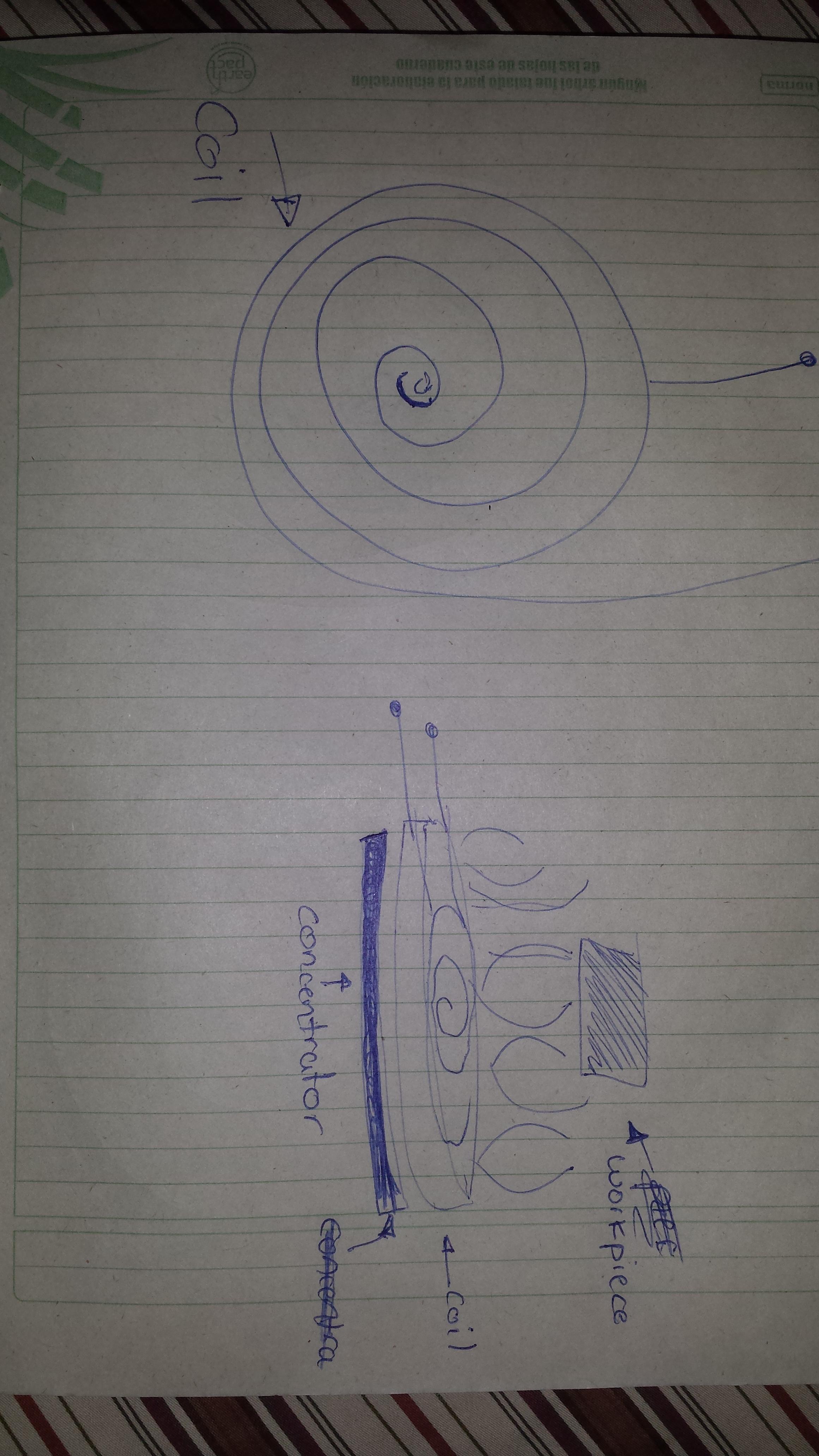

James Bond Posted December 6, 2017 Author Share Posted December 6, 2017 hi my friend joshua on the internet I have seen some very interesting concentrators. for example the induction cookers They have some ferrites under their coil that I suppose serve to concentrate the magnetic field upwards of the coil and in this way do not waste energy. I am right? I send you an email my email is email removed I attach an image and a link to a video on youtube 3:16 https://www.youtube.com/watch?time_continue=5&v=jOg8Q-jt1BY https://www.youtube.com/watch?time_continue=2&v=Dsc8vzSQDP8 Quote Link to comment Share on other sites More sharing options...
ReactorForge Posted December 7, 2017 Share Posted December 7, 2017 You are very welcome my friend. Those videos were interesting. Here at 5:58 you can see the animation of how the ferrite material carries the lines of flux. That second video cool as well. It's intriguing how the ferrite material was incorporated into a sort of clay or foam that you can mold onto the coil, allowing you focus the flux on one side. It looked like it started to get hot and smoke in the end though, or maybe that was just smoke rising from the metal. Whether it's a permanent magnet or an induction heater coil. Any time you introduce a ferromagnetic metal (iron, nickel, or cobalt) to its lines of magnetic flux (called a vector field), those field lines want to flow through the material with a higher relative permeability. Since those ferromagnetic metals have a much higher permeability than the surrounding air, they choose this as the "easiest" path to traverse. Similar to the way electrons prefer to flow through the path of least resistance. CORRECTION: In a previous post I mentioned that a variac provides isolation from mains. I want to point out that only an isolation type autotransformer or a separate isolation transformer in front of the variac will provide this isolation and most variacs are only autotransformers. You can ask the google machine for more info if you want it. Quote Link to comment Share on other sites More sharing options...
ReactorForge Posted December 12, 2017 Share Posted December 12, 2017 James, You were interested in using ferrite material to focus the induction heaters flux. This site shows the application of EMS for SolidWorks to model the magnetic flux density in the radial ferrite cores under an inductive cooking coil. There are other programs you can use to model various magnetic characteristics such as MATLAB https://www.emworks.com/blog/induction-heating/induction-heating-engineers-empower-chefs#comment-9491 Two amusing things about this site's post though, for one they plagiarized a screenshot from one of my youtube videos (the very first photo in the post), and two they called the ferrite cores iron cores. This note was requested by ReactorForge: I see now that rather than saying "Two amusing things about this site's post though" I should have worded it like, "There are two amusing things about the post from the site linked above." If they were made of iron, they would burn the coils up as iron would succumb to i2r heating from the induced eddy currents. Here is another company that specializes in controlling magnetic flux distribution in induction heater work coils. https://fluxtrol.com/magnetic-flux-control-in-induction-heating Quote Link to comment Share on other sites More sharing options...

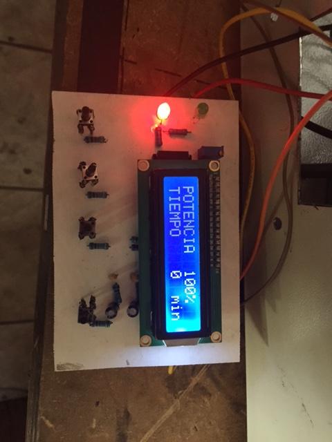

James Bond Posted January 31, 2018 Author Share Posted January 31, 2018 ok i was very bussy this weeks because my job its very demanding, but i finally finish the new control, it works very fine in the induction heater because my goal is to maintain the current stable no matters the size of the piece or the heat or the material and i can say this thing works fine. also i introduce a safty control if something gone wrong. Quote Link to comment Share on other sites More sharing options...

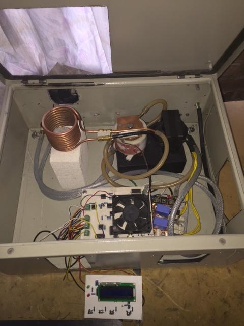

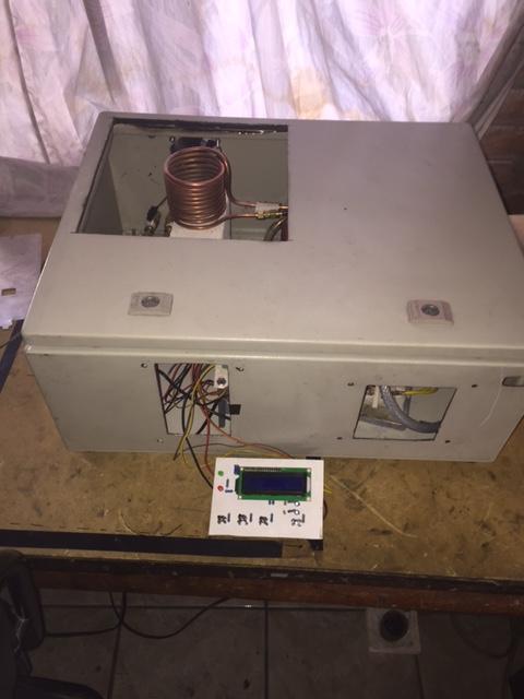

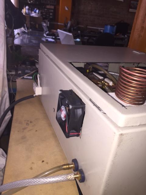

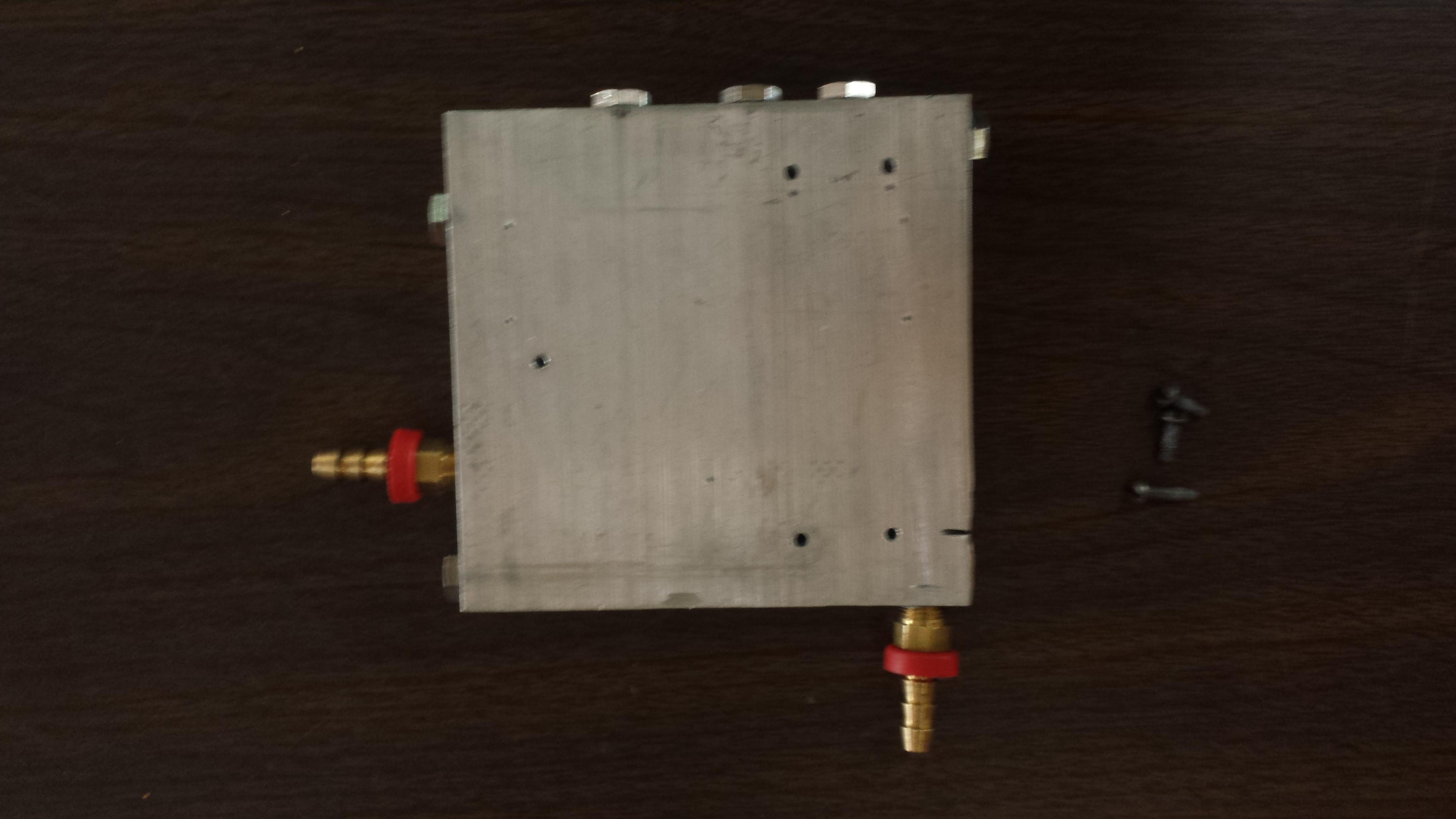

James Bond Posted April 13, 2018 Author Share Posted April 13, 2018 well i was workig in the control of the induction heater and i put a lcd 16x2 so you can set power and time before start work, i change the tank circuit because my friend Joshua C. told me than the old one waste a lot of energy. and he was right. cooler sistem its a very bad idea but works fine four 12vdc high flow fans and two computer radiators. jeje thanks Joshua C. the system works grate at 4 kw and and I think we can get up to 7kw. Quote Link to comment Share on other sites More sharing options...
