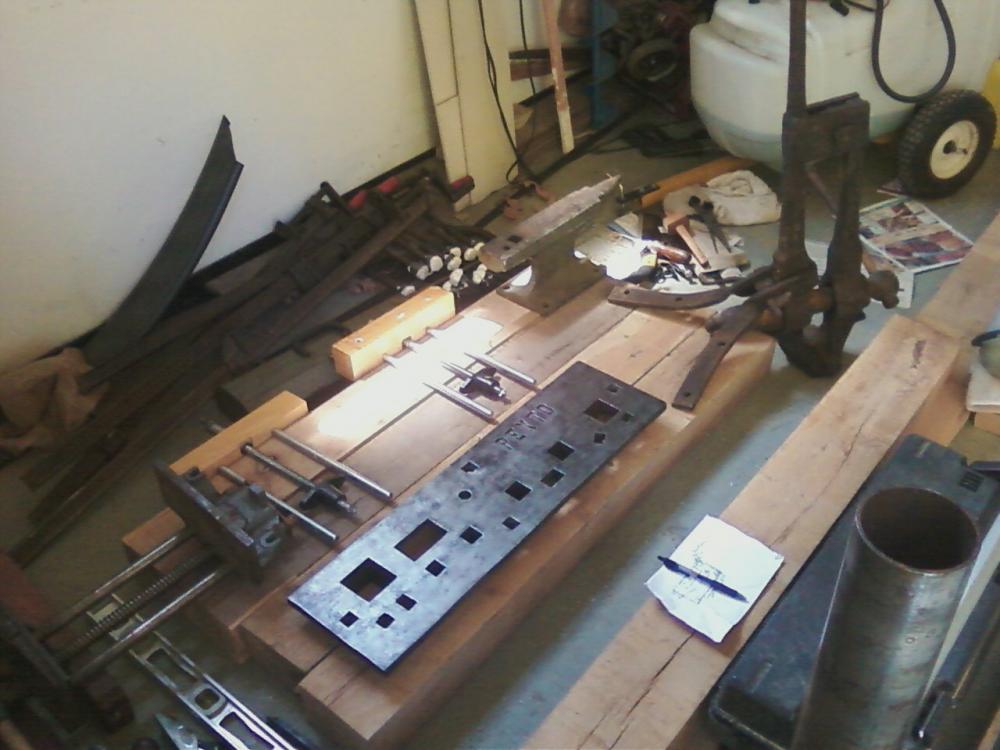

Hello, getting ready to build a workbench that I can use for my pexto stake plate, post vise, and wood working vises, So I can also use this bench to do wood working things when needed. making it out of 4"x6" oak beam and rough cut 1.5"x 7.5" boards. I mostly have hand tools to do the job.
Trying to find he right height. I have the smaller post vise from bottom tip to mount hardware is about 29" and for my largest and prettiest one is 32" I also have a intermediate sized vise but its jaws aren't as precise.
I think I want to mount the larger one I think overall the bench will weight a few hundred pounds, and its at least a 90lb vise, so should provide ample leverage, especially that the mount fits so nice on the table top. I am going to mount that in the corner at 45% from the sides.
I then have a regular easy mount wood workers vise my uncle in law gave me some time ago so that will go on the opposite far end.
then you see 2 screw vise clams from a mass produced workbench. It was damaged and is rickity and will be come some kind of work station. I want to mount them on the opposite side I mount the face plate and post vise together to clam one long piece. Even ideas come of taking 2 small bike gears and chain and welding the gears to the turn handles. build small sheet metal cage for it. would be a fun project.
Questions: how beneficial would it be to run some threaded rods through my table top to really tighten it down.
Do I need copper face plates for my longer vises if I were to clamp plate or sheet metal in it?
how far can I mount the smaller vises from each other? max length of that vise? (overall bench will be just over 4 ft. )
what are optimal heights for wood working benches, and pexto stake plates ( I figure even if some anvils make the height uncomfortable i can build a little raiser platform to stand on. but still be at more comfortable heights for other work as option )
any good methods to get the smooth rods out of the wood part of the 2 cheapo screw vises?
thank you for any tips and considerations!

A woodworking bench & a metal working bench are two separate things. The height of both depends on how you work.
Do you use hand tools (i.e. hand plane), or machine/electric? You need a metal surface for welding/spark creating, and you won't want to accidentally dull a woodworking saw on a metal surface nor have a 5000° torch flame run across oak grains.
You can always adapt your bench to the project you're on at the time... My woodworking bench is 33" tall. My metal bench is 36" tall.
Optimal height for a wood working bench is probably around your wrist height.  Hold a plane and see where it's motion is free and easy without bending over.
Optimal height for a stake plate is one where the tops of commonly used stakes will be at wrist height  like an anvil to allow work with hammers
These are mutually conflicting heights!  You really need separate workbenches!
Do you need to cover the post vise jaws: Yes No or Maybe depending on what you will be doing.  Highly polished armour making or repair Yes; basic use with hot steel No---unless they have been dressed with absurdly aggressive faces---I have 1 that way sharp pyramids across the entire surface. (which actually works well for doing rough wood working where the surface of the workpiece will be dressed later!) Covers generally don't need to be copper, Al and steel (easily made from angle iron) work too.

You're talking not 2, not 3 but at least 4 different uses for vises and throwing in a stake plate for icing on the cake.
If you're talking about mounting leg vises for hot work you'll want the top of the jaws on your STRIKING anvil about wrist height with your arms hanging relaxed at your side. The vise you'll be using for hot filing, twisting, incising, etc. will need to be about elbow height. This height makes it MUCH easier and natural to keep file, saw, etc. strokes level and even while putting work for fine chasing and incising say wizard heads closer to eye level.
Elbow height is a better height for ANY hand work that involves repeated strokes, planing, filing, sawing, etc. Someone posted a guide here, printed in an old book that laid out how to mount vises and it's a LOT more involved than just height. Where on the table, an independent stand or a wagon tongue or truck, the whys and hows.
What I remember most clearly is the elbow height on a CORNER of the bench or table. On a corner so you can bend or hold long stock without hitting the table.
You my friend want to get as many uses out of a confined space as possible but it's going to take a LOT more than one table. Were it me I'd put the leg vises on an outside wall near the door, or make portable stands and mount the leg vises at two heights for the purpose.
Bench vises should go inside on the benches or stands necessary to the correct working height.
