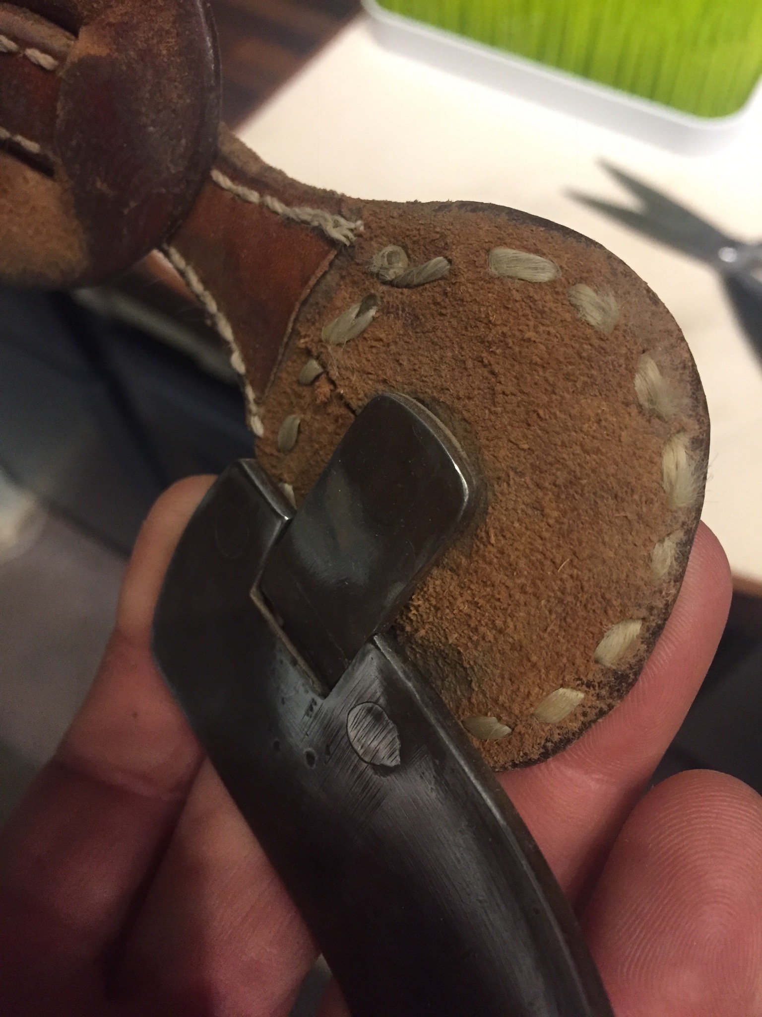

The hangers are the part that swivel that the button attaches to. I'll add a picture of a hanger. I've not made and spurs out of rasps. They're not really my style and I don't want to spend the time grinding down bands to a suitable thickness.  What you say about the shanks makes perfect sense though. If I was going to do that, I'd anneal the pieces of rasp that are to be the shanks then rough them out with the harbor freight portable band saw. Then I'd tack the two pieces together and grind them very close to the final shape. Then I'd weld the edges with a wire feed if available. What ever method you choose for welding, I'd use plenty of anti-splatter spray. After the weld, anneal them again so the metal doesn't end up too hard to drill the hole for the rowel pin.

Outside of hanger on a purchased set of spurs
Inside of a hanger I built.
Do you have any tips on bending the hanger? Also for the nickel silver should i use a hard or easy solder? Some videos ive seen were using a 45% hard silver solder. Ill be brazing them if that makes any difference. And thank you for all the help ive also been playing with the idea of doing a rasp band and just a regular steel shank. I have a few rasps that i have used to make knives out of so i figured id put them to use since i have them already
