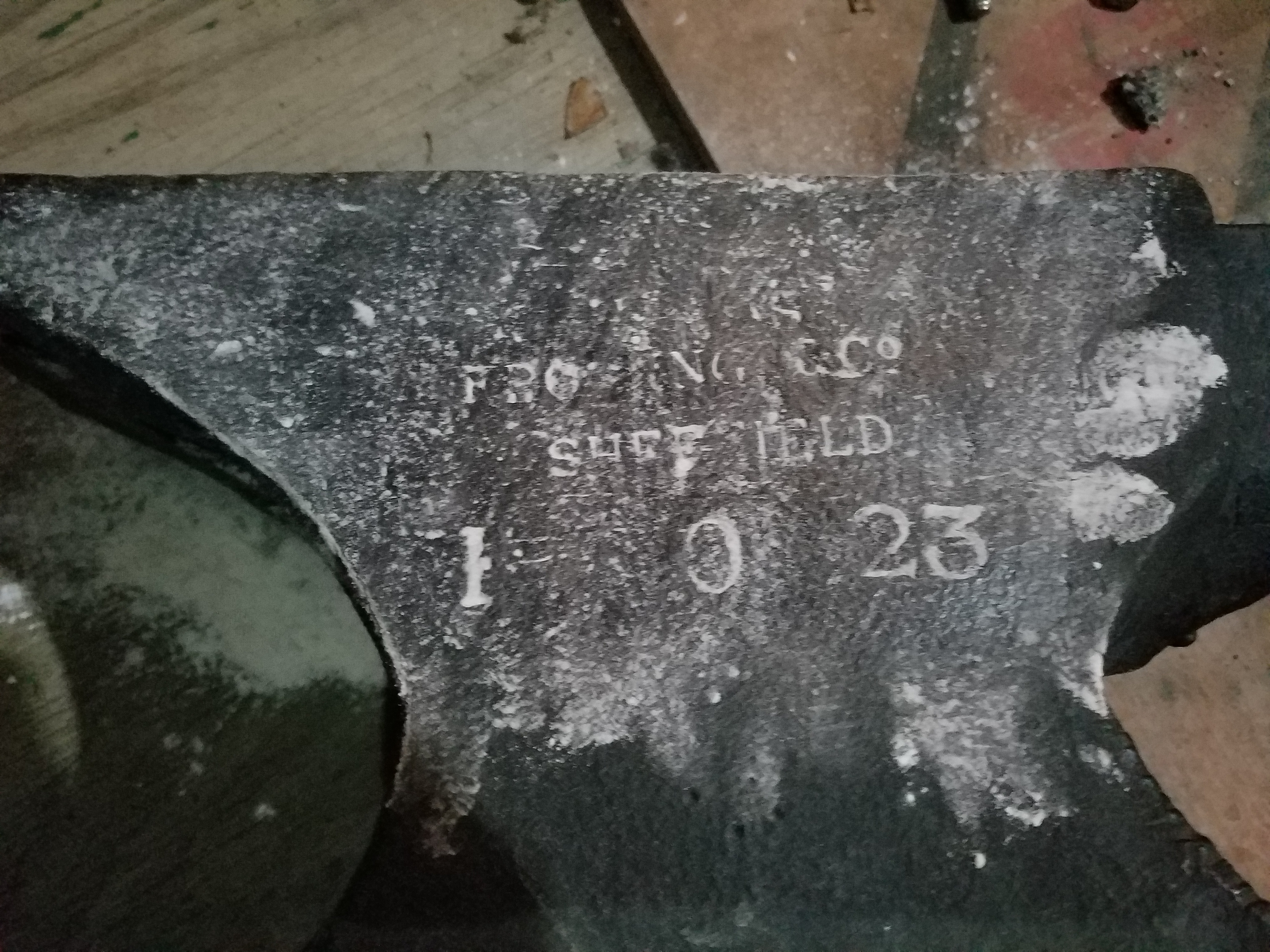

Howdy fella's and gals, been lurking on this site for a few months now and finally decided that it was time to join.
I'm lookin for a lil help from y'alls vast knowledge on anvils. I finally found an anvil at a decent price on craigslist by accident. Now i can re purpose my rr track. I picked this up from a guy near pittsburgh pa. I know it was made in Sheffield and weighs 135# but doesn't look like a mouse hole anvil. I looked at all the posts about the Armitage era and markings, but cant say it matches any of that info. I've had this thing for a week now, and all I have had time to do is take this quick pic of it, (workin 15 hr days). Still need to clean all the paint off it.
It has decent rebound and ring, there is a chip off the corner of the heel, but doesn't affect the rebound right next to the chip, (i'll post more pics tonight when i get home). Any help would be appreiciated.

Here is a couple more pics of the anvil. I know I gotta get the paint off it and hit it with a wire brush still. Long days and not enoug time.

I suggest you contact Richard Postman, author of Anvils in America, IIRC he has documented several hundred different English anvil makers; many of them since he wrote his book.
Was paging though Postman's "Mousehole Forge" book and found it: "LOMA FROMING & Co Mousehole made anvil"  page 41
With the LOMA being above the FROMING & Co
The feet and the overall shape does resemble my mouse hole  anvil

Lionel; *many* other anvil makers learned the trade at either Peter Wright or Mousehole and so many anvils made by other makers show similarities.
In his book, "The Mousehole Forge", Richard Postman documents on pages 40 & 41 an anvil with the following;
"LOMA
 FROMING & Co."
Sheffield
1*0*26
As Richard states, "Mousehole anvils are distinctive in shape and when you know what to look for it does not matter who's name is on it."
Here is mine, as advertised when purchased, as an example:
MampH%20Armitage%20Mouse%20Hole%20Anvil%
Thanks for the help, was curious if there is any mention as to a date in the book? I have searched the web looking for Loma Froming & Co and every variant of anything anvil related, and I only get results about hair cream or some other randomness. I'm still gonna beat on it, but curious as to how old it might be.
