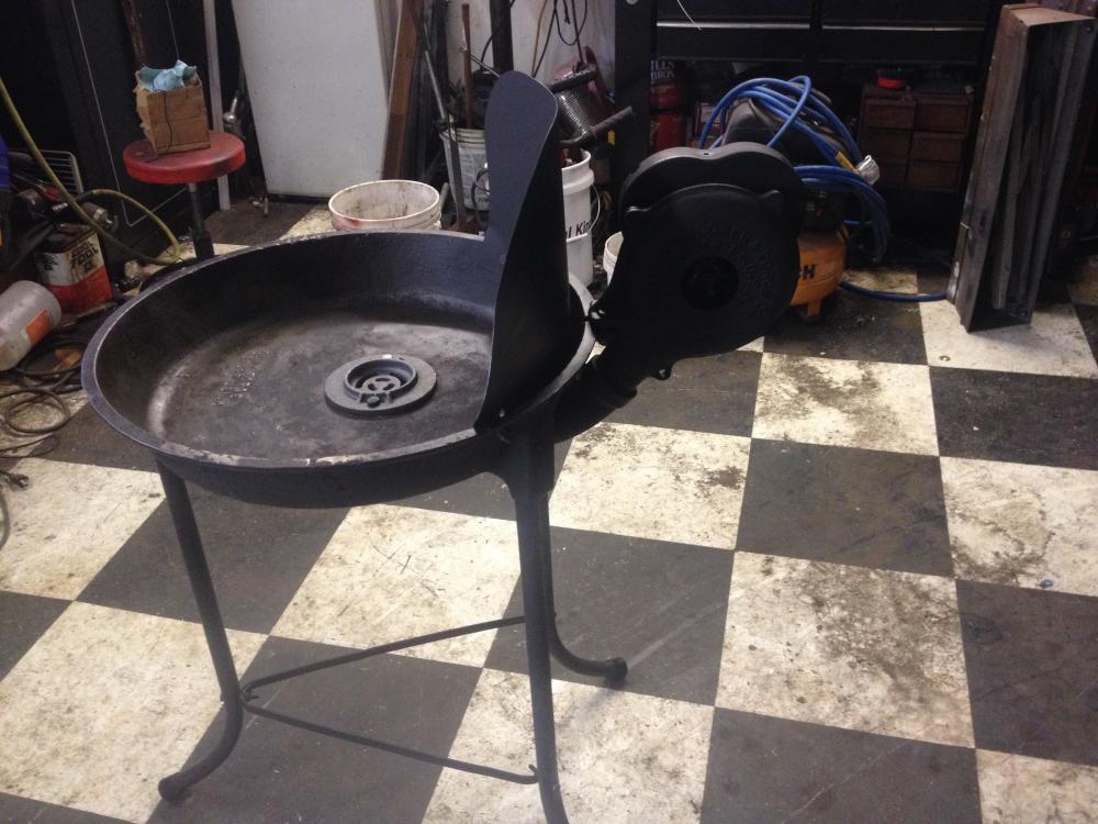

Mountainhouseforge Posted October 13, 2016 Share Posted October 13, 2016 Folks, I need a bit of help. I have a Champion rivet forge (three leg, no numbers that I can see) that needs to have the gears replaced. One has three teeth missing. The other has one. Where can In find replacement parts, new or used? I have been haunting ebay looking unsuccessfully. Thanks for the help. Quote Link to comment Share on other sites More sharing options...

Mountainhouseforge Posted October 13, 2016 Author Share Posted October 13, 2016 Folks, I looked at the forge last night. The only words on the blower are, "Champion Forge and Blower Co. Lancaster, PA". Here are a couple of photos. I am not home to get closeups of the blower and gears. Quote Link to comment Share on other sites More sharing options...

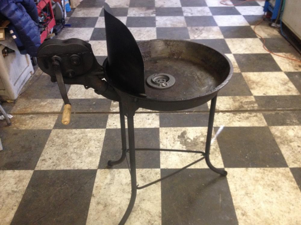

BangBang Posted January 29, 2018 Share Posted January 29, 2018 I have exact same forge! The large straight cut gear also was missing three teeth and the Blower impeller was rusted out! I just filled in where three teeth were missing and built the area up with Braze! I preheated part in 500 degree electric oven!"My powdercoat oven" I also heated steel bucket of sand. Preheating is needed to keep from cracking the cast! I also buried part in sand after brazing and put back in oven! I then turned off oven and allowed part to cool over night! I then used a set of jewlers files and recut three teeth! Yes it too about three hours of work! I Have a working original blower now, and I prefer to keep it that way! My Forge came out of a old shop in Custer South Dakota! I Made the new impeller out of same thickness steel, all I had to work with was a few rusted blades for a pattern and the shaft hub! It seems to work good , now have to make a Hickory Handle! I will then clean forge bowl and legs up and get entire unit back together! I am pretty pleased so far as I bought entire unit from a local guy for 150.00! I felt it was a good deal even needing repair! I included , picture of gear repair, On tooth wasnt built up with braze as good as I like and I will keep a eye on it! I also included a pic of impeller I made and Railroad track anvil I made two weeks ago! I will have to make a back hood as well like the looks of yours . I would appreciate rough dimensions of it? Quote Link to comment Share on other sites More sharing options...

BangBang Posted January 30, 2018 Share Posted January 30, 2018 Started cleaning up original seamed tube legs this afternoon. They seam to be in excellent shape, but the way they bolt to the forge pan with one bolt seems rather weak and started to compress the tubing! Inside diameter of tube was about 7/8 inch. I had some solid stock cold rolled so I cut three pieces 1.5 inches long. I then put a bit of tapper on edges in lathe and drove them into tube legs at the top! Tomorrow I will drill bolt hole thru solid stock and fasten legs back to bowl of forge! I will feel better about leg integrity. I will post more as I finalize this project in the next few day! Quote Link to comment Share on other sites More sharing options...
BangBang Posted February 2, 2018 Share Posted February 2, 2018 Well My forge is back together! Blower is working great! I have to line the pan and waiting for the coal I ordered for a test fire! I am very pleased with how it turned out! I turned a new crank handle today a peaned handle onto arm! Turns out while wire wheeling the pan it is a model 147 Champion which has a bit larger pan than the 145! Mine is a 22 inch pan! I am anxous to try it out! Quote Link to comment Share on other sites More sharing options...
