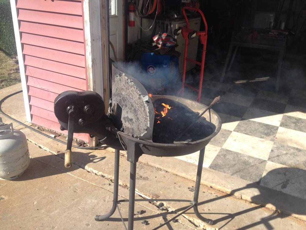

Well My forge is back together! Blower is working great! I have to line the pan and waiting for the coal I ordered for a test fire! I am very pleased with how it turned out! I turned a new crank handle today a peaned handle onto arm! Turns out while wire wheeling the pan it is a model 147 Champion which has a bit larger pan than the 145! Mine is a 22 inch pan! I am anxous to try it out! -

I have exact same forge! The large straight cut gear also was missing three teeth and the Blower impeller was rusted out! I just filled in where three teeth were missing and built the area up with Braze! I preheated part in 500 degree electric oven!"My powdercoat oven" I also heated steel bucket of sand. Preheating is needed to keep from cracking the cast! I also buried part in sand after brazing and put back in oven! I then turned off oven and allowed part to cool over night! I then used a set of jewlers files and recut three teeth! Yes it too about three hours of work! I Have a working original blower now, and I prefer to keep it that way! My Forge came out of a old shop in Custer South Dakota! I Made the new impeller out of same thickness steel, all I had to work with was a few rusted blades for a pattern and the shaft hub! It seems to work good , now have to make a Hickory Handle! I will then clean forge bowl and legs up and get entire unit back together! I am pretty pleased so far as I bought entire unit from a local guy for 150.00! I felt it was a good deal even needing repair! I included , picture of gear repair, On tooth wasnt built up with braze as good as I like and I will keep a eye on it! I also included a pic of impeller I made and Railroad track anvil I made two weeks ago! I will have to make a back hood as well like the looks of yours . I would appreciate rough dimensions of it?
