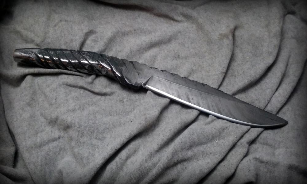

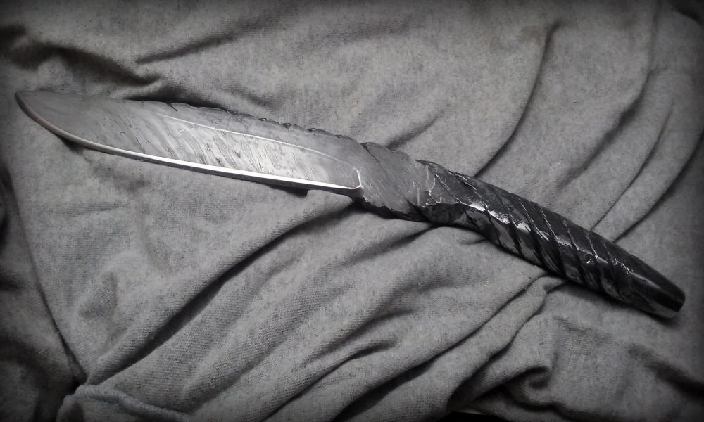

I've been working hard, trying to keep my tables full at a weekly farmers market/artisan show, and have been finding it very difficult to produce knives in my limited forge time.  So, with no knives on my tables, I needed to bust one out quick.  With no time it forge up a damascus billet, I went with another cable knife.  I tried a new technique of leaving the cable running along the spine.  It made forging it a lot more difficult since I was only welding it from the sides, but I ultimately got a solid blade out of it.  There's a couple of spot near the transition to the handle that I was concerned about, but after clamping it in the vice and torquing on it with some real force, they didn't show any signs of movement, so I'm thinking they are mainly just on the surface and everything underneath is solid.
This didn't sell over the weekend, but It drew enough attention to get me three knife orders... now to find the time to make the knives and still keep the tables full.  What have I gotten myself in to?

I love the pattern that you got with this one and the fact that the handle shows people less versed in knife making what it was made from really appeals to me. I recently successfully forge welded my first piece of cable and im very excited to see what it etched like now. What did you use for your etching?
That's looking pretty sexy, lovin the blade shape.
That inclusion on the right side ricasso worries me because it carries through into the plunge line, which means it's in there pretty deep. Make sure that the person buying it understands it's a light to medium duty knife; no chopping or similar heavy use.

I use diluted ferric chloride for etching.  For this one, I gave it three 20 minute etching cycles with a light sanding with 1200 between each cycle.  I was going to give it one more cycle, but it was getting late, I was tired, and I just needed to get it done to get on the table the next morning.
