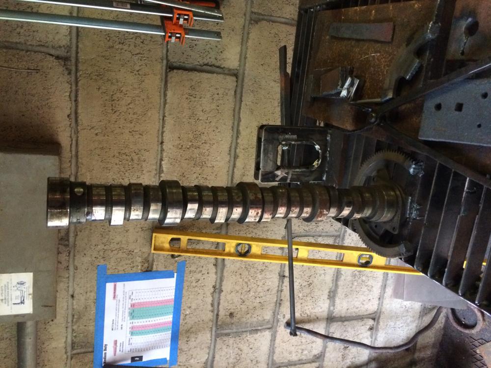

GoodThing Factory Posted August 31, 2016 Share Posted August 31, 2016 picked up a camshaft a while back and its stamped "A3" - anyone know if that means it's A3 steel? a couple of pics for reference ... thanks Quote Link to comment Share on other sites More sharing options...
Smoggy Posted August 31, 2016 Share Posted August 31, 2016 I would suspect that is a part rather than a material identification but I couldn't confirm that. What are you intending to do with it? Quote Link to comment Share on other sites More sharing options...
Tom H Posted November 12, 2016 Share Posted November 12, 2016 I don't recall ever hearing of A-3 steel. Likely a manufacturing batch number. Quote Link to comment Share on other sites More sharing options...
Steve Sells Posted November 12, 2016 Share Posted November 12, 2016 Do you stamp your tools with the ID of the steel gradeyou used ? perhaps tool or maker ID, rarely does anyone other than the designer care about the grade of steel used. Even then the manufacturing process means its subject to change due to availability. Many times its the Q&A inspector stamp to prove it passed. Quote Link to comment Share on other sites More sharing options...
John McPherson Posted November 13, 2016 Share Posted November 13, 2016 A3 Carbon steel is a category of Air Hardening Tool Steel. A3 is composed of 1.25% Carbon, 0.5% Manganese, 5.0% Chromium, 0.3% Nickel, 0.9–1.4% Molybdenum, 0.8–1.4% Vanadium. The composition makes the alloy wear and corrosion resistant. Quote Link to comment Share on other sites More sharing options...
