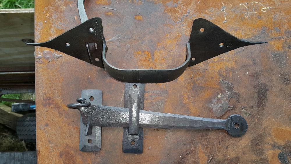

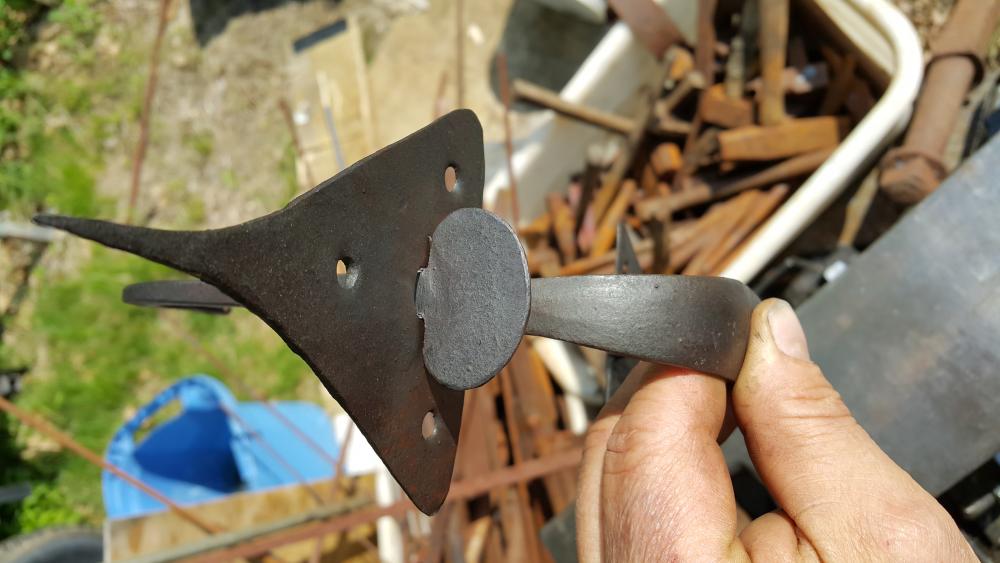

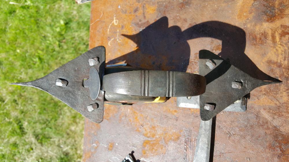

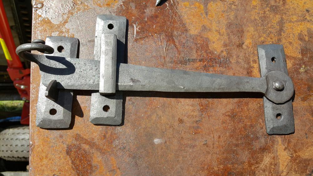

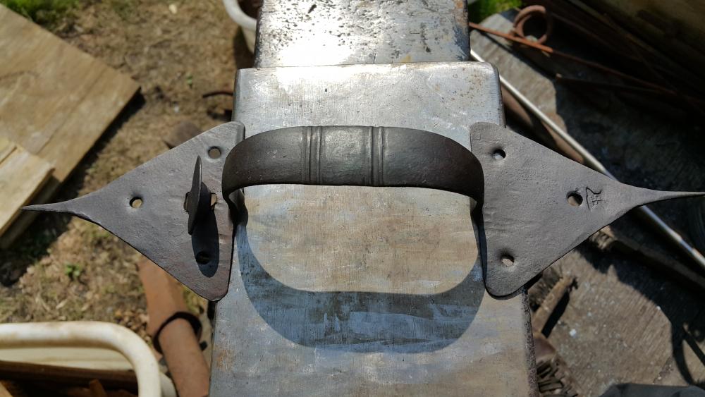

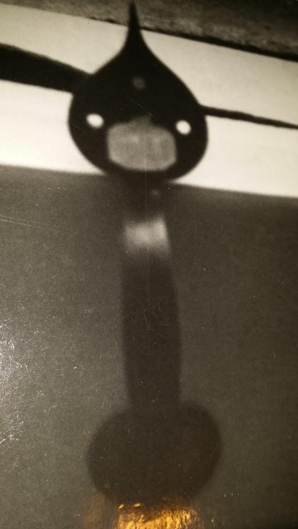

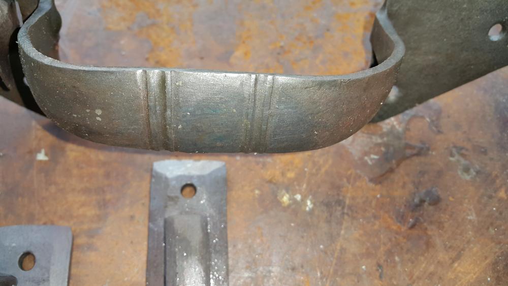

Just a latch I threw together for a customer.
Arrow pattern with spear accent..
on back group with pigtail finial on bar.
Screws reshaped to look like rose head nails..
Sorry about the turned pictures..  Not that savvy with how to edit or rotate pictures here..

Thanks..  Norfolk latches offer a hole different approach to latch making as the process turned to hand made automation vs hand made..
If you have a lot to make, making the cutting dies will speed up the process as will making a spring swage for the handles..

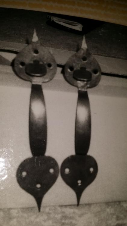

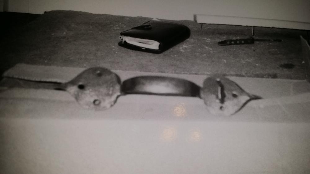

Okay, A few more..

I'm not sure how many Norfolk latches I need to make...maybe about six or seven. The escutcheon plates on mine are simpler than the ones in your photos...basically rectangles with semi-circles punched out of each corner. They have shallow countersinks for the screws and staked-in hinge plates for the swivel lift. The hand grasps look very much like the ones in your photos, although proportionally not quite as bulbous in the center. Most of the lifts have a saucered thumb press and curved ends, but a few have straight ends. Mot of the mounting screws have blunt ends, no taper, and have thin, hand-cut slots, and the heads and threads vary just slightly in diameter and pitch between screws. All of the bars are plain except a few that have a button grasp, and all have escutcheon plates. The staples vary, some with and some without escutcheons. The catches also vary, some braced and some not. There are also a few latches with a somewhat different escutcheon design, but otherwise similar. One door had a Norfolk latch with a cast-iron escutcheon, but that could have been added later, and of course, a few of the abovementioned parts may be later replacements. I'd send a photo or two, but I'm not at that location at present.

These latches were all cut by hand..Once I made one, I used this to mark out and cut the next one.. If I were making 6 or more I'd spend the time making the dies as it would be a huge time savings.. (Less time more money per hour) I made spring swages for the handle shapes (which were requested by the purchaser)...  I turned 2 different center sections on the lathe and let the customer choose..  I still have the 2 handle sections stashed.. also the upset boss where the rivet plate goes..
The screws must have been hand cut.. I love hand cut screws don't get to see many these days..  I almost bought a hand screw threader 30+ years ago but the price went to high at 40.00.. Wish I had bought it and just starved for the next week..
Not sure if you know or even care but the straight ones were earlier and the curved handles later on interior door hardware..   The straight thumbers on latches were so, dresses wouldn't get caught as the women folk walked through the door..  As time went on the handles took on a more curved shape eventually turning into cast iron copies of hand forged items..
anyhow, sounds like you have lots of variety and time frames as they were upgraded/installed.. I'd love to hear if there are old nail holes under the latches there or where these were new doors when they installed the latches..
Colonial hardware was my Niche for years.. So if you run into problems pm me..  Love to see how your work comes out..
The coating was a linseed oil. bee's wax mix applied hot..
