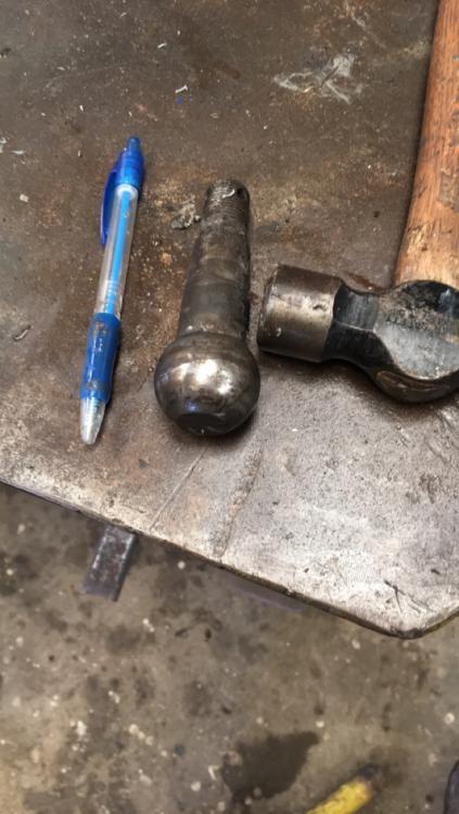

I'm sure someone has tried it...I'm thinking of using a Tie tod end out of our grape harvester at work for making different hardy tools. I've got 8 of them. Can someone give me some insight as to if they will work for making a hot cut. I've never made one before but a guys gotta start somewhere. It has to be somewhat hard due to the abuse it withstands. I really don't know thinking out loud I guess.
It should work just fine.  Square up the small end to fit your hardy hole.  Forge the round end to a fan shape, grind an edge and you're good to go.  Not much need to heat treat since the hot cut will be harder than the hot metal you are cutting.  Just don't be whacking on the edge with your hammer.  ;)
That'd make a nice little ball stake or perhaps a snarling iron. Keeping a bucket of them around the shop would be a true bit of honorable scrounging. ;)

just got done forging it pretty happy with it, ill post a picture once i get it finished.
thanks fellas!
The hot cut was a success.
But im even more excited about my tongs. After 4 failed attempts I finally made my first set of tongs. They're not the prettiest but they'll work.
Nice job on both.  They should work well for you.
