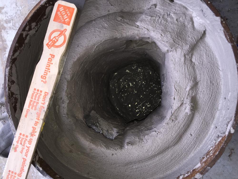

woody15 Posted April 12, 2016 Share Posted April 12, 2016 Hi everyone just wanted to get some feedback and advice on my vertical forge build. Also I'm worried I may have screwed up the angle of my burner tube , concerned I might not have proper angle for a nice "swirl" in the chamber. I'll post some pics of that later, but not sure how much effect that will have on the performance as aside from the hot spot. Quote Link to comment Share on other sites More sharing options...
jagboy69 Posted April 12, 2016 Share Posted April 12, 2016 Vertical? What you are building is a furnace. Visit www.alloyavenue.com Tons of "vertical" furnaces over there. Here's a few shots of mine. I start on diesel and after a few minutes, switch it over to 100% used MOTOR OIL. Forced air and a 25psi compressed air venturi hookup. Works like a champ and costs literally pennies per hour to run. Will easily melt cast iron. You can see from one of my photos the angle of the tuyere. Creates a nice swirl. If you are going to use a crucible for melting metals, You'll need a top and an exhaust hole. That's the only way to really crank up the heat. (yes that is a drain hole on the bottom after the PVC was melted out) Quote Link to comment Share on other sites More sharing options...
woody15 Posted April 13, 2016 Author Share Posted April 13, 2016 Wow that's pretty sweet. Won't be melting any cast iron but will be forging some knives haha. Hope they don't melt lol! Quote Link to comment Share on other sites More sharing options...
jagboy69 Posted April 13, 2016 Share Posted April 13, 2016 Well I'll be.. it really is a vertical forge. hmmm, now get a crucible and lets melt some metal! Looks good. How's your swirl? Quote Link to comment Share on other sites More sharing options...
woody15 Posted April 13, 2016 Author Share Posted April 13, 2016 Haha will do! swirl isn't too bad could be better tho. But will def do the job,. Guess that's how you learn Quote Link to comment Share on other sites More sharing options...

woody15 Posted April 14, 2016 Author Share Posted April 14, 2016 Hey Frosty is there still a link for Dan Foggs site ? I wanted to check some stuff out but doesn't appear to be a site anymore..?? I'm attempting to get a better way to plug the top of the forge chamber. Not the metal lid, the wool plug. I'd like to coat few times with satanite but I can't coat then plug bc then it just sticks so I can't coat it again. Or if I coat first, allow it to cure then plug, the satanite just cracks exposing wool. Lol sorry seems simple but just wanna do it right Quote Link to comment Share on other sites More sharing options...
